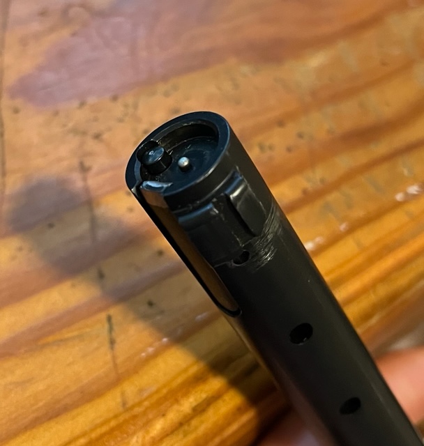

Firing pin protrusion is how far out the firing pin tip sticks when you press the trigger. I'm not familiar with the Cross, but you can usually check protrusion by holding the main bolt body and twisting the bolt shroud (at the rear of the bolt) in the direction of the big "scoop" machined out of the rear of the main bolt body.
Pics attached. In the one with the colorful arrows, rotate the bolt shroud in the green direction until the part the red arrow points to is in the yellow spot. Included a pic of what it looks like after rotation, as well as what the firing pin should look like afterwards. Using calipers, measure how far out the pin sticks from the bolt face.
