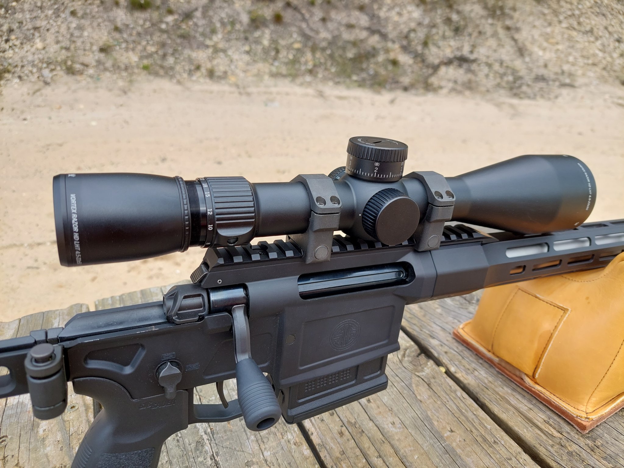

I am using the new Vortex Razor HD-LHT 4.5-22x50 on my Fix and it is perfect there: FFP, less than 22 ounces, functional reticle.

Put this new Vortex on mine. Compact, nice magnification range and for me it was cheap..
