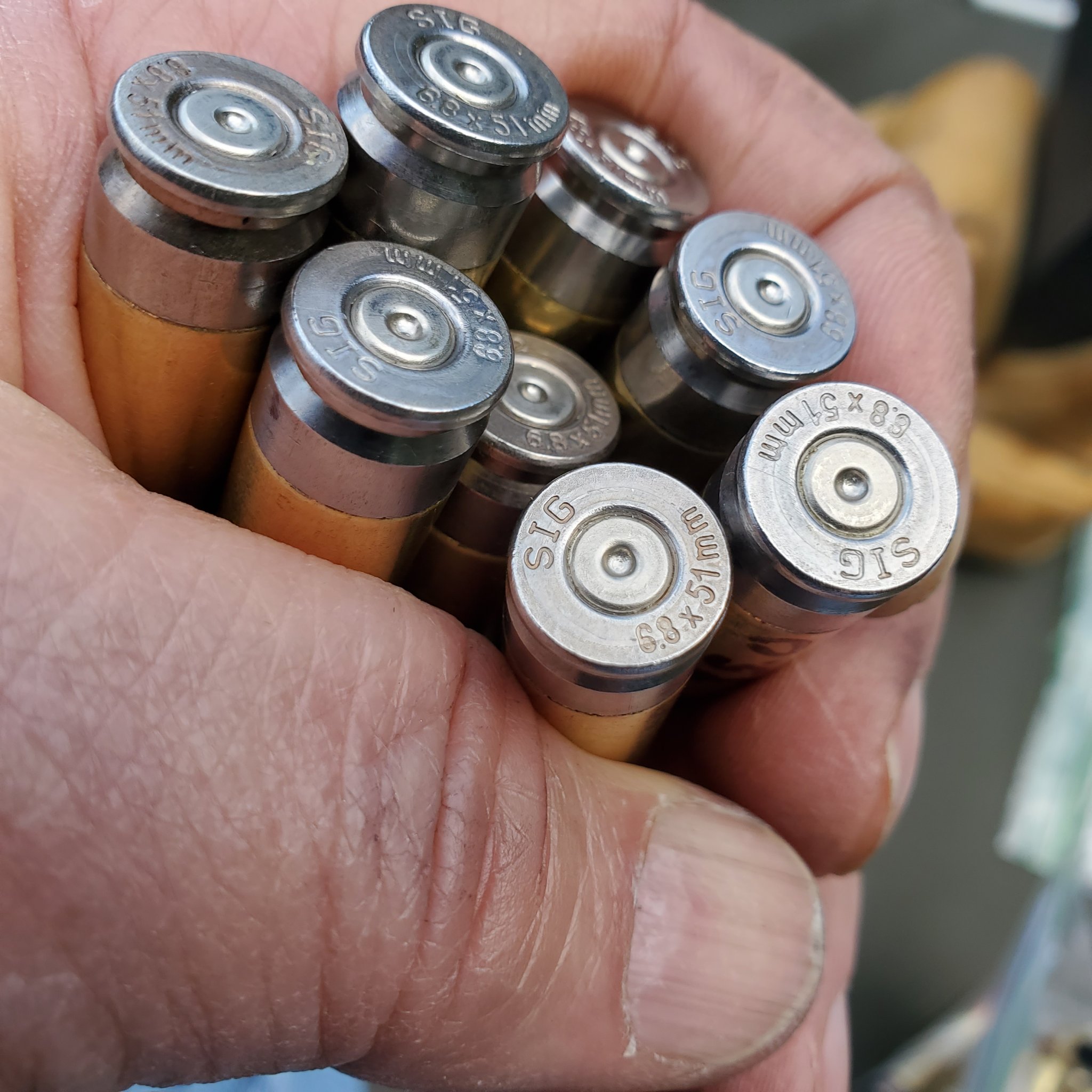

Hybrid cases are only available in the military form 6.8X 51 mm with SS case heads.
I use the hybrid cases by the hundreds, and form them into 308 Win, 6.5 CM, 8.6 Blackout, 358 Win.

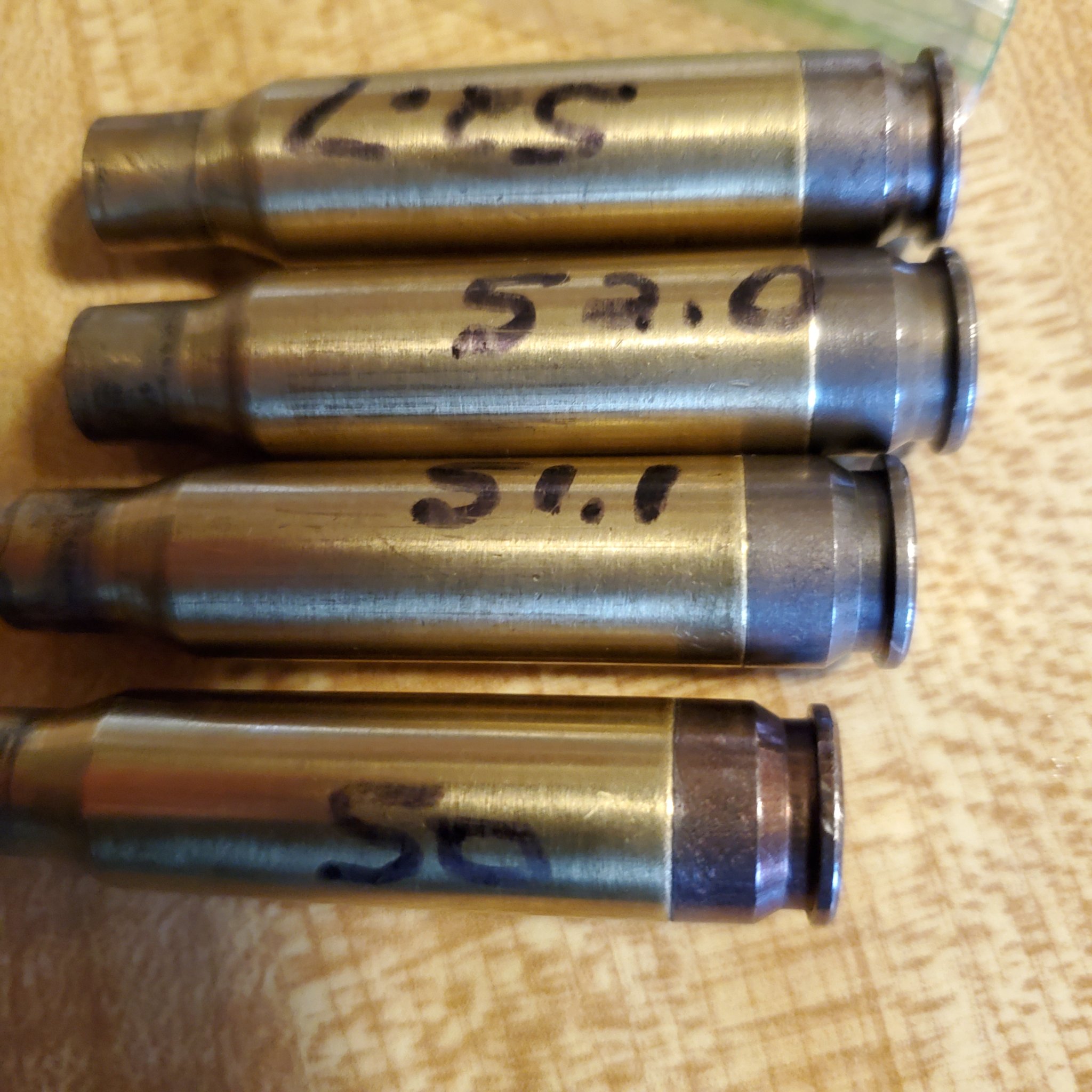

Picture of hybrid cases, in a 308 test...with some increasingly heavier powder charges.
Probably more informational than useful for the average person...but these things available.
