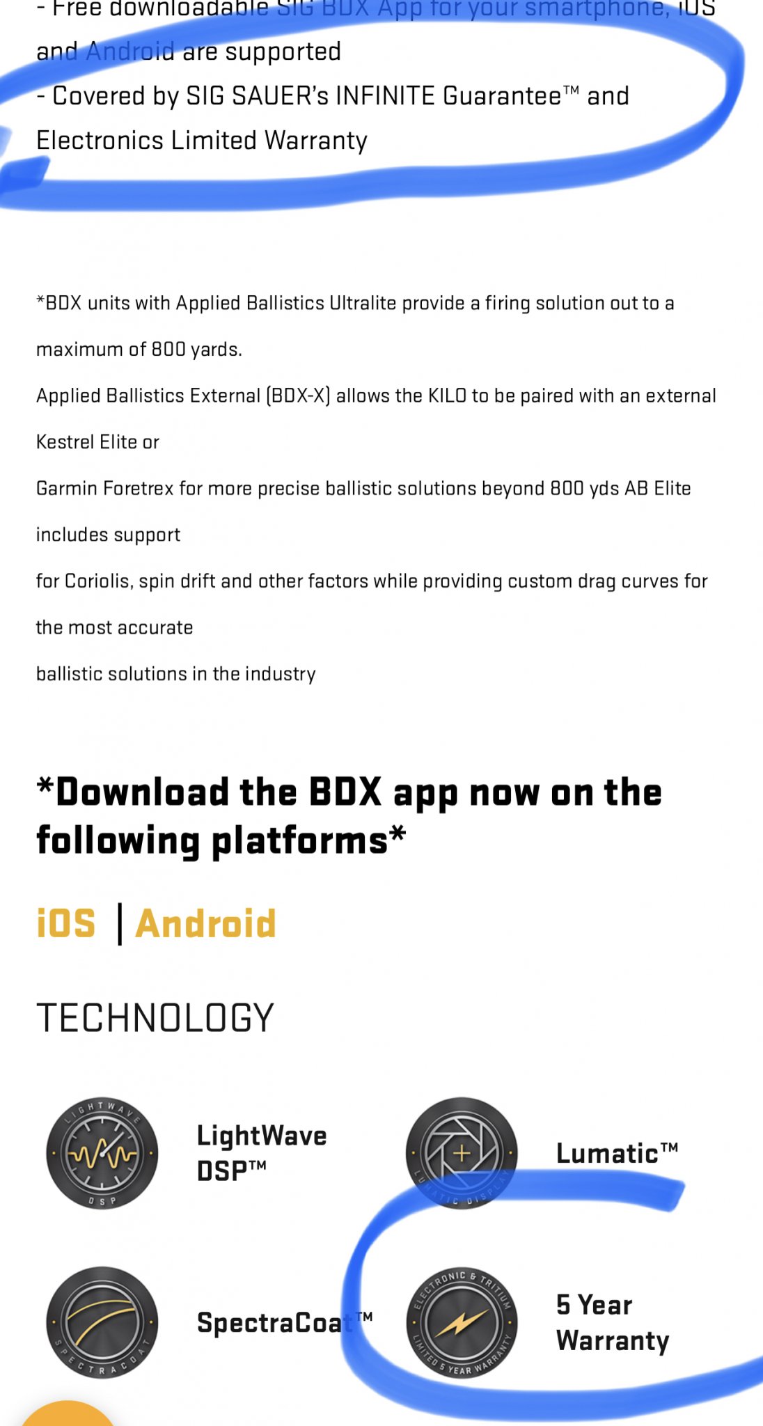

This is the shit that confuses me with their binos. So everything except the electronics are covered for life?
Pretty sure that's the idea (to confuse people). My understanding is that the 5 years of electronics coverage starts from the date of manufacturer and not the date of purchase, so if they sat on the shelf for a few years you could have almost no or no electronics warranty at all.
Just confirmed that on this page of their website:
Click on Electro Optics and scroll down.
"SIG SAUER warrants that the electronic and tritium components of the enclosed product were originally manufactured free of defects in workmanship, material, and mechanical function. For a period of five (5) years from the date of manufacture,"
Im looking at vortex as well for the warranty. Sigs warranty kinda screwed me before on a year old rangefinder that died but the manufacturer date was out of warranty. I’ve been kinda sour on sigs since then.
