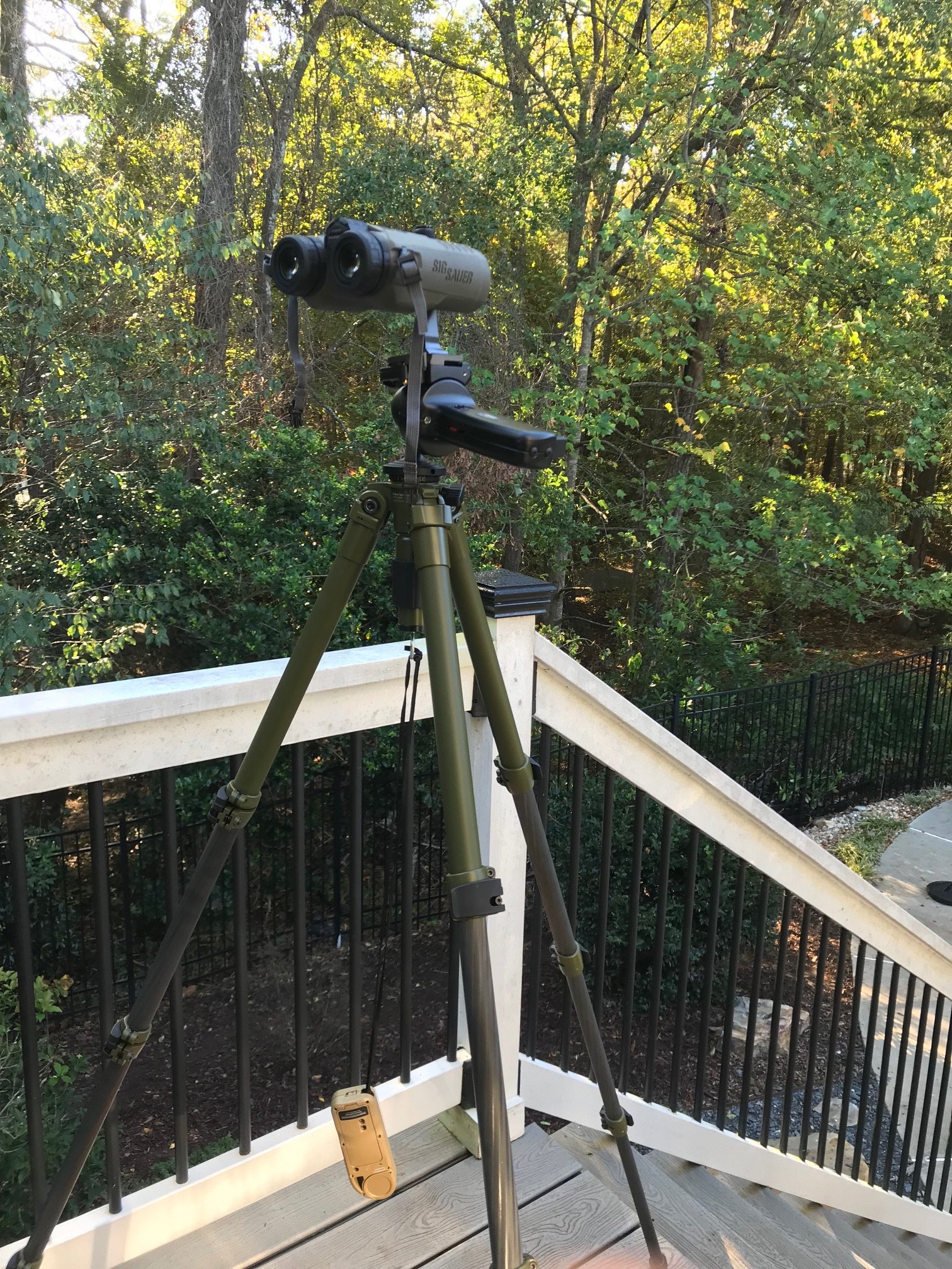

I set up at the top of a building in Atlanta and found out what could and could not be done with these. It was no problem to sit behind them for about 90 minutes.

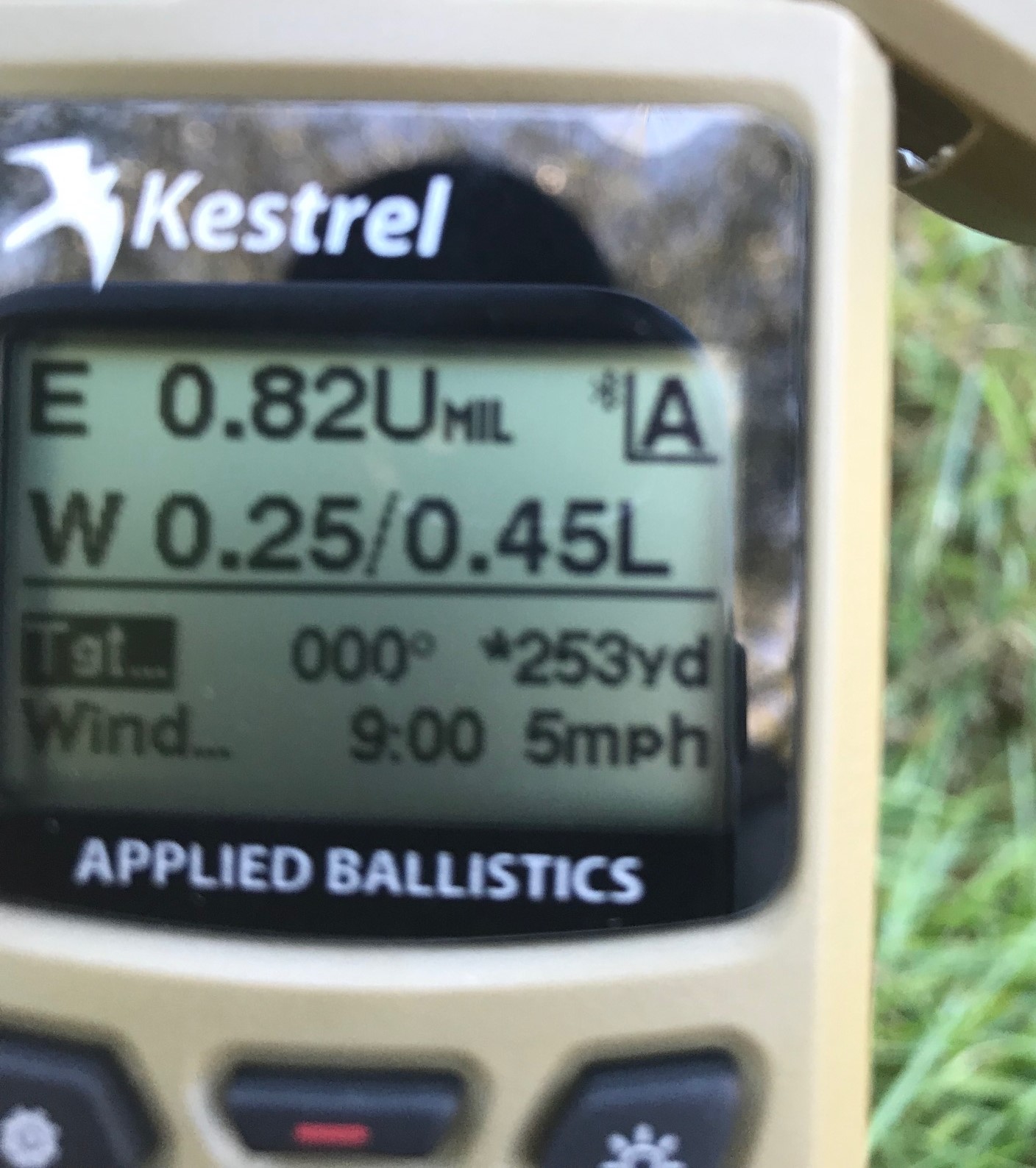

That is exactly it, the BDX does the ranging then the Kestrel does the math. I just keep the kestrel in a pouch on a shoulder strap. I had it there few a few hours today and I didn't once have to take it out and swing it. The only need to touch the Kestrel was to change profiles when switching guns. I really like the way it works. For me the benefit is significant.
As I said above, my one complaint is that the BDX only gives me tenths while the Kestrel gives me hundredths. Below this is the 0.8 vs 0.82. I'll contact Sig to see if there is something that can be done.

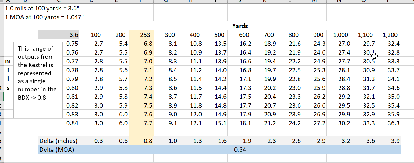

The absence of the hundredths place does not mean +/- 0.01. It means the range of 0.00 to 0.09. This is a significant difference.
We saw an output of 0.82 from the Kestrel reflected as 0.8 in the BDX. Without looking at the Kestrel how could we interpret 0.8? We just need to understand how numbers are rounded, in this case from hundredths to tenths.
0.8 shown in the BDX represents the range of outputs from 0.75 to 0.84 in the Kestrel.

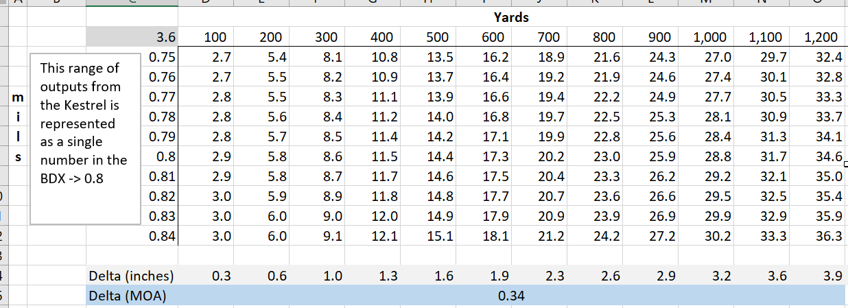

In the below chart we see the angular measurement in inches as we go from 0.75 to 0.84 mils from 100 to 1,200 yards. At 100 yards an output of 0.8 in the BDX can mean a range of 2.7" to 3.0", or 0.34 MOA. The target ranged was 253 yards and the range of values is still 0.34 MOA.
How do we do this? By observing the rules for rounding decimals to the nearest tenths:
- To round a decimal analyse the digit at the hundredths place.
- If the hundredths place value is 5 or more than 5, then the digit at the tenths place increases by 1 and the digits at the hundredths place and thereafter becomes zero.
Does it matter? YES! My match rifle is an honest 0.5 MOA gun. The range of values shown above indicate I can add up 0.34 MOA to that based on the imprecision of the hold presented. At 0.84 MOA I am back to the reloading bench to figure things out.
I am sure some reading this have already figured that I should be measuring the distance from 0.8 to get a +/- loss of precision for bullet placement and not the whole range. This is true and is why I have chosen to keep the BDX.

Fair enough. Very thorough explanation. I didn't realize the SIG was rounding up or down, I assumed it was just leaving off the hundredths digit. .70 to .79 would display as .7, etc.
You are right though, .89 is pretty different than .8 when you get out there a ways.
i assume it does not round .89 down to .8 that goes against all math
so assuming a reading of .8 is somewhere between .75 and .84 which is normal rounding, how would you dial/hold the ends of those? dial to .8 and hold high/low? can you hold 1/2 of one tenth of a mil?
I sure as hell can't, that was my original point, but I'm guessing that most of the issue with the guy above is because he's anal, not necessarily holding to the hundredth of a mil. No judgment from me, but all the excel spreadsheets and stuff give me that impression.

You are correct in the rounding. Apologies if I was unclear about that. My point was that without looking at the Kestrel you have no idea where you are between 0.75 and 0.84. I can definitely hold that difference. Would it make a difference to you if your Kestrel read 0.75 vs 0.84?
I feel like I'm tearing apart this unit, which is not at all what I intended.
What kind of math are you using to get 0.84 - 0.75 = 1/2 of a tenth?
Same question, how to you get 0.09 = 1/100th? I promise you there is a difference. That spreadsheet and the rounding lesson only existed for you.
.8-.75= .05 = 1/2 a tenth = center dot on milxt
..84-.8 = .04 = 4/10 = roughly line thickness on milxt (.033)
Don't worry, I'm fully aware of how to round. I didn't say 1/100th, I was referring to the hundredths place on the decimal.
I don't know of a scope that has markings on turrets or reticles for .0x mils. If you can hold that precisely, cool beans, you're a better shooter than me.
I think the message here is that the difference between .76 and .84 mills is so damn miniscule it shouldn't matter a whole lot. If having the extra digit displayed makes you feel better that's fine too.
Most mil scopes have subtentions of .2 mils, right? So take that, cut it in half, and you've got .1. I can see holding in the middle of that just fine. If you take that .1 and cut it into 10 sections you can get .11 or .17 or whatever. I don't see being able to hold those differences.
So we take that back to our example - .76 to .84. You (or maybe just me) could hold at the crosses at .6 or .8, or hold the middle at .7. Anything more precise than that is just a WAG somewhere on the line towards one side or the other.
