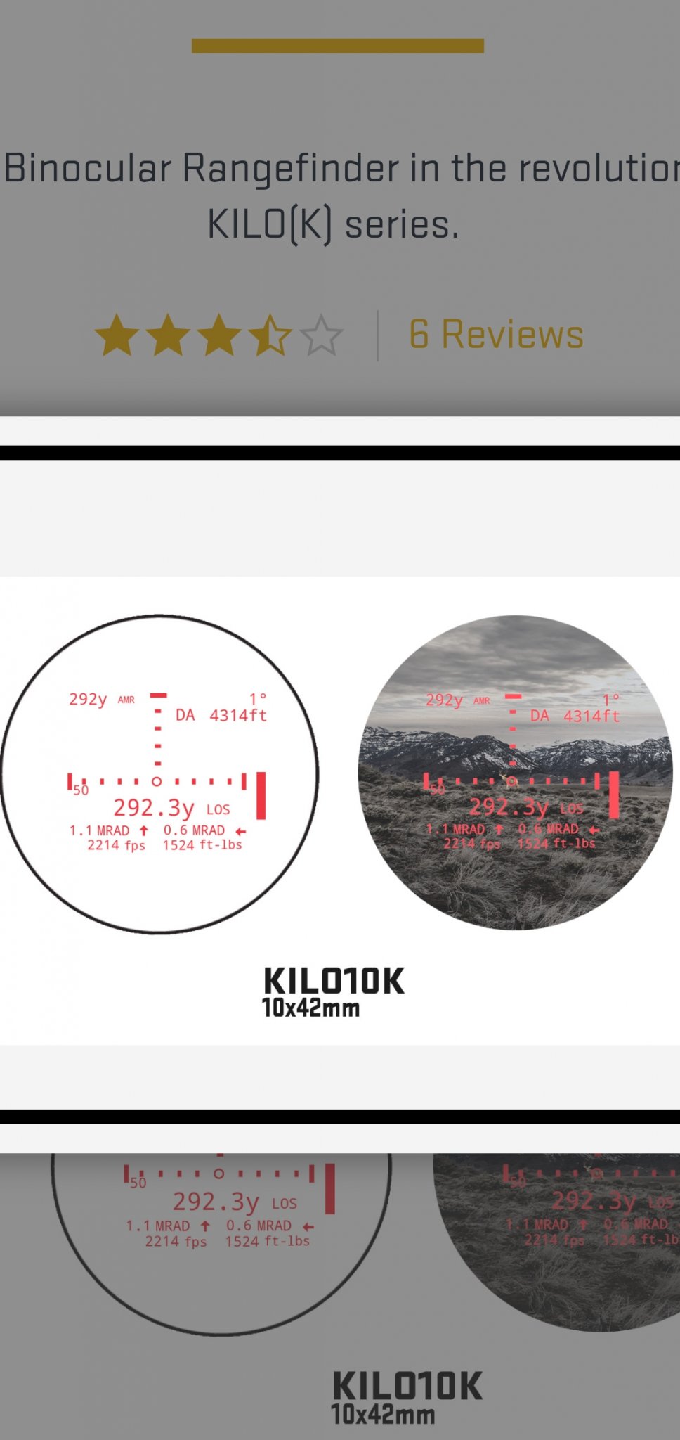

Huge difference the 10K is very busy because of all the extra info it displays.
Reactions: Badjujuu

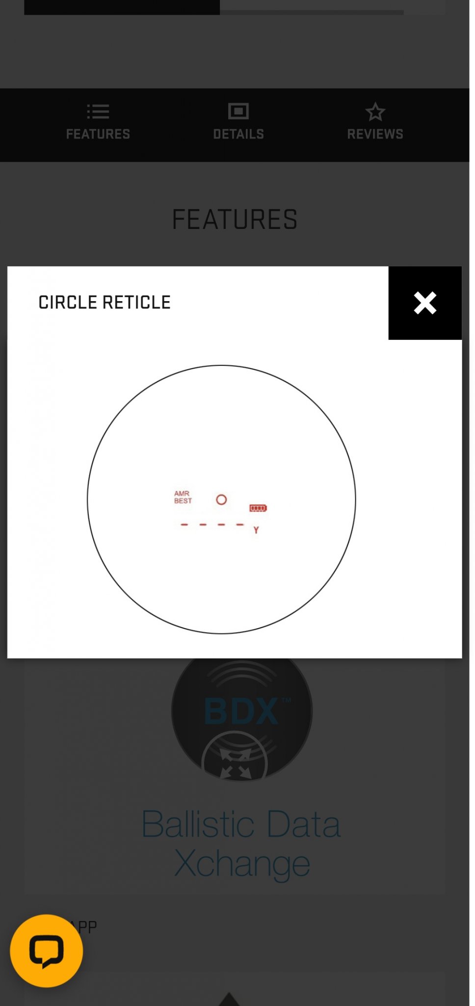

Have a screenshot of the 6k display to compare? As long as it shows elevation and wind solutions on the same screen, with the Leica I have to scroll between elevation and wind and it drives me nuts. Can’t figure out why 8k is so much more than 6k and 5k, yes it’s better LRF module and AB Elite/Pro but at almost $1k more than 5k model???

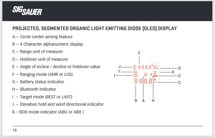

The 6K is the simple "O" reticle on the right, used in the all the previous SIG LRFs . When ranging the 6K only will show the elevation holdover value and finally the windage hold. You have to either pair with a Kestrel or other anemometer or enter the wind speed /direction in the app to get the hold value.
Right, that's a no go for me as I'm trying to find a decent solution that can have me forego the Kestrel option, I have a Kestrel but do not like to be dependent upon it, plus as I'm shooting longer and longer ranges the wind at the Kestrel is becoming less reliable than reading wind downrange. Reading wind is becoming more important to me than relying on Kestrel but I do understand the Kestrel still has some advantages. I am a bit baffled that very few options exist that will show both elevation and wind solutions on the same screen, I can't be the only one who sees the advantage in this, in fact, the only option I know of is the Sig 10K.
The 6k DOES show both elevation and windage correction on the same screen, the distance is show below the "O" then above the elevation will display with a up/down arrow, followed by a left/right for the wind. Look at page 18 of the manual link I posted item "J". You just have to either enter the wind value manually through the app or link to your Kestrel. The 10K is same but you use the supplied Weatherflow anemometer, a Kestrel or again enter the wind value manually through the app on your phone.
When you say “followed by” that infers it moves to “another screen”, I guess I wasn’t clear with my term “screen”. I do not want the display to show elevation and then wind, I want the display to show me both elevation and wind at the same time. Does that make better sense?
As an example the elevation solution with display 4.2 ^ then flash 0.3 <, on the same screen.
Right, if I remember correctly the AMOLED display of the 10k doesn’t do this, it will display both elevation and wind at the same time, I don’t want a flash or other screen, I want them both. Yes, I want my cake and eat it too 😂. I was hoping all the Kilo Xk units had similar.
