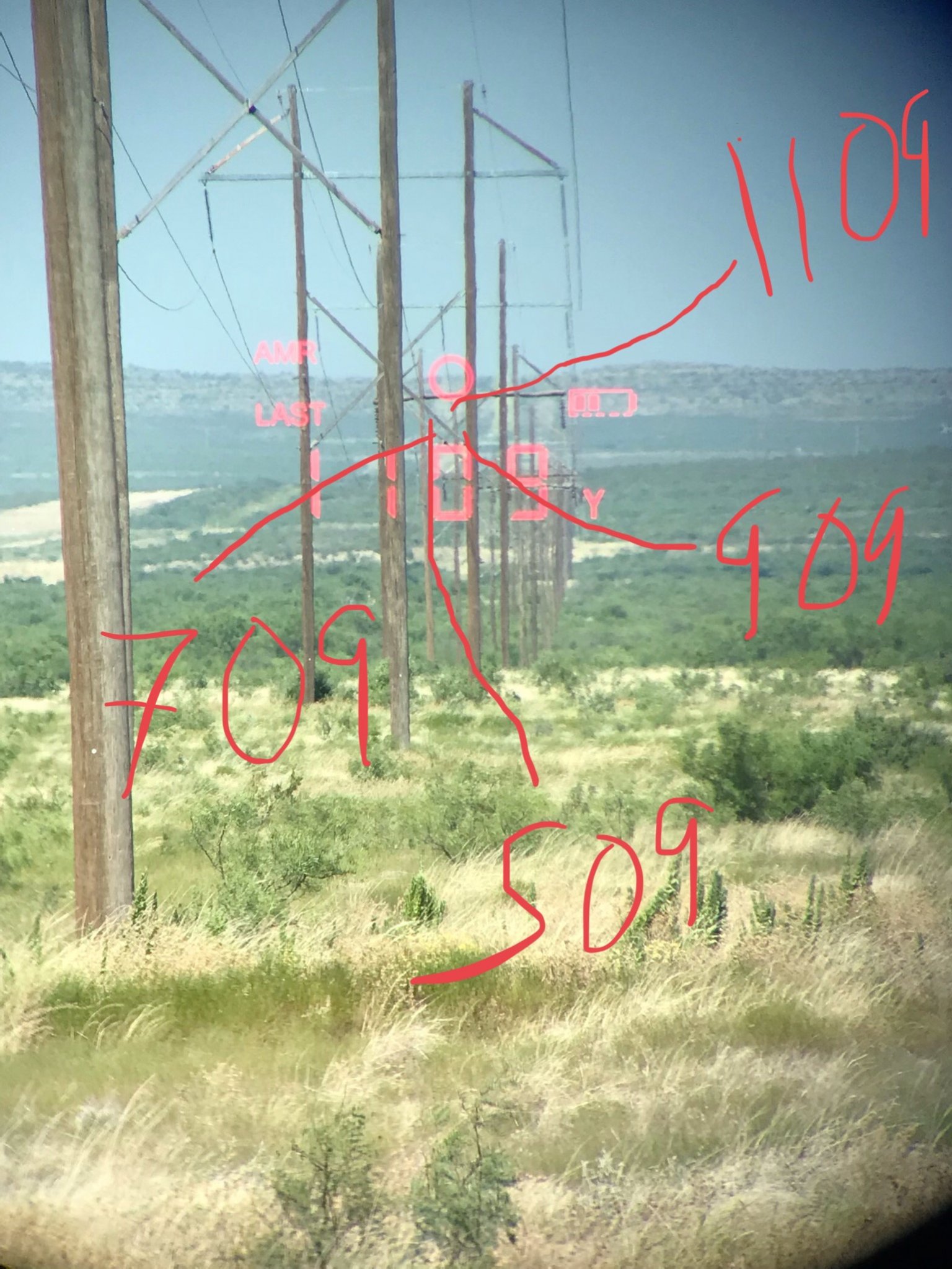

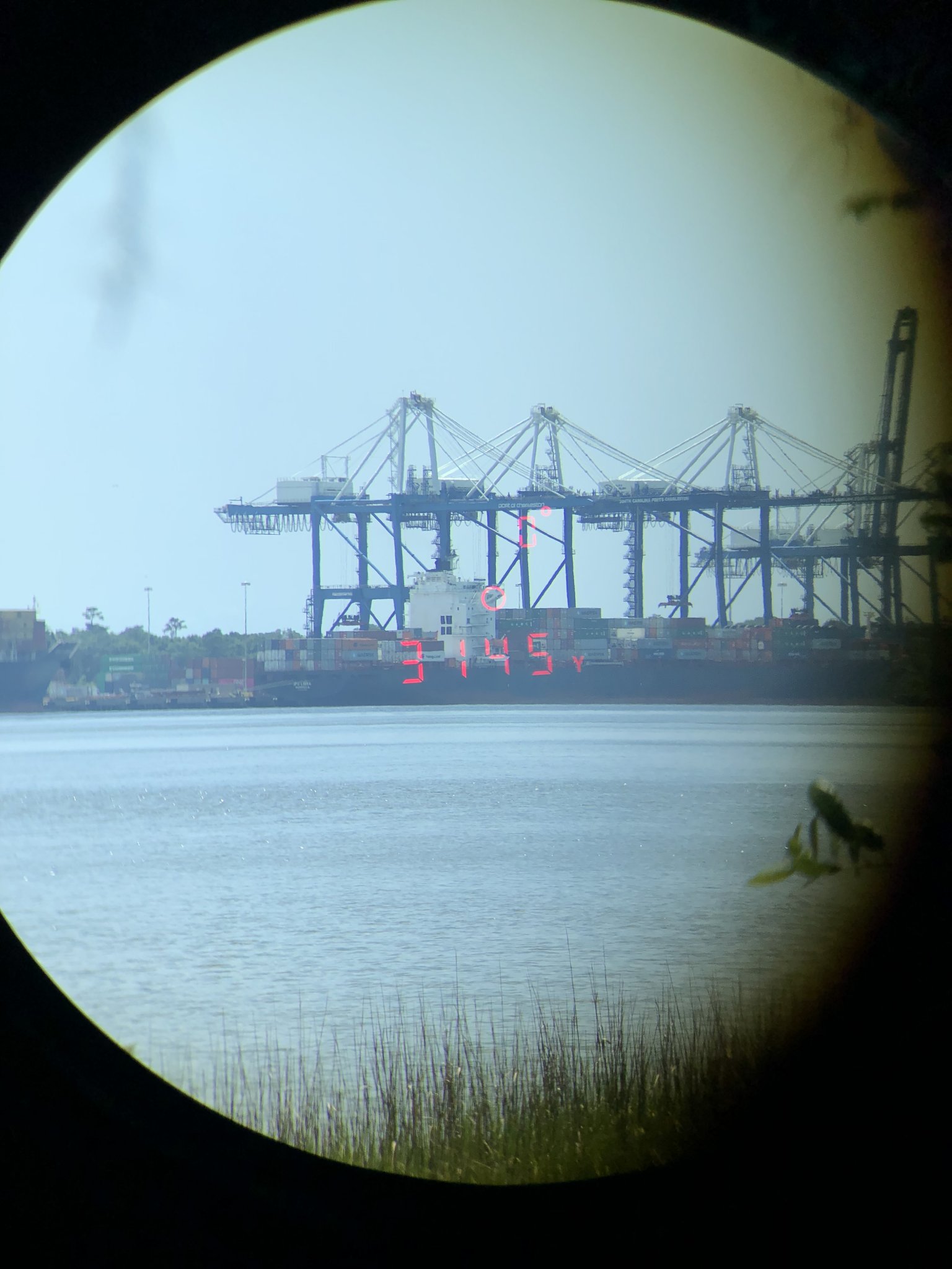

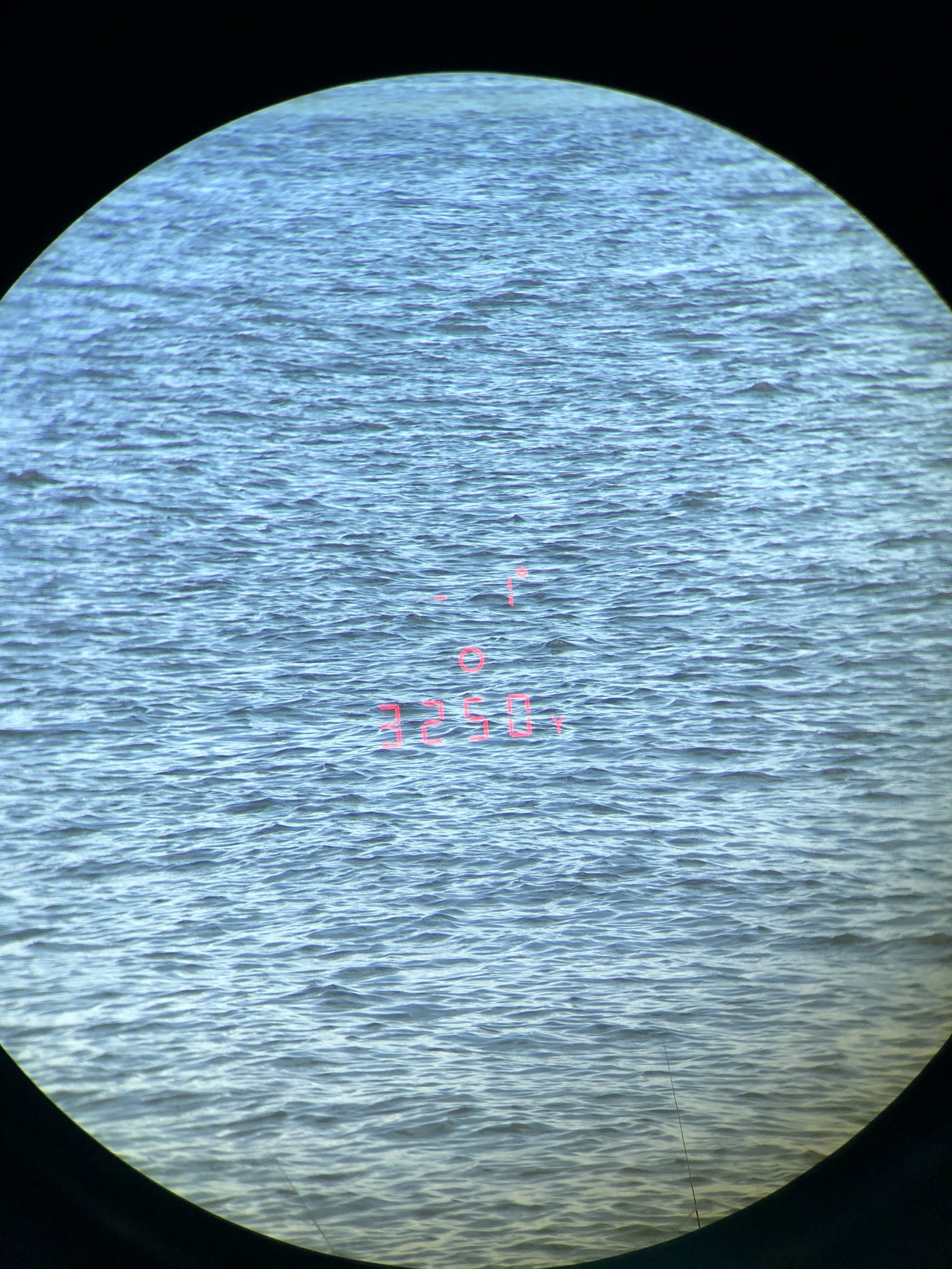

Sig Kilo 3000
The kilo is lightning quick. Does that ability matter? Well that’s a whole separate argument. However at market price it’s the best thing going.
Hell yes it exceeds 2400.

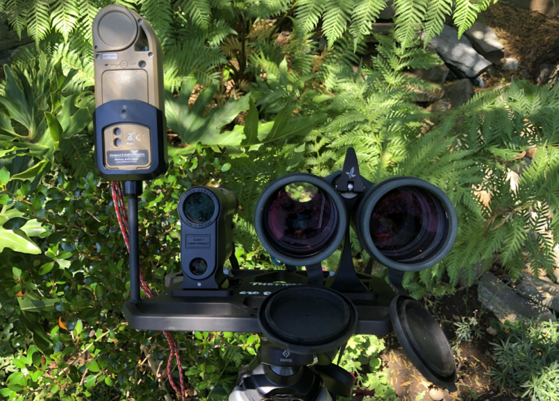

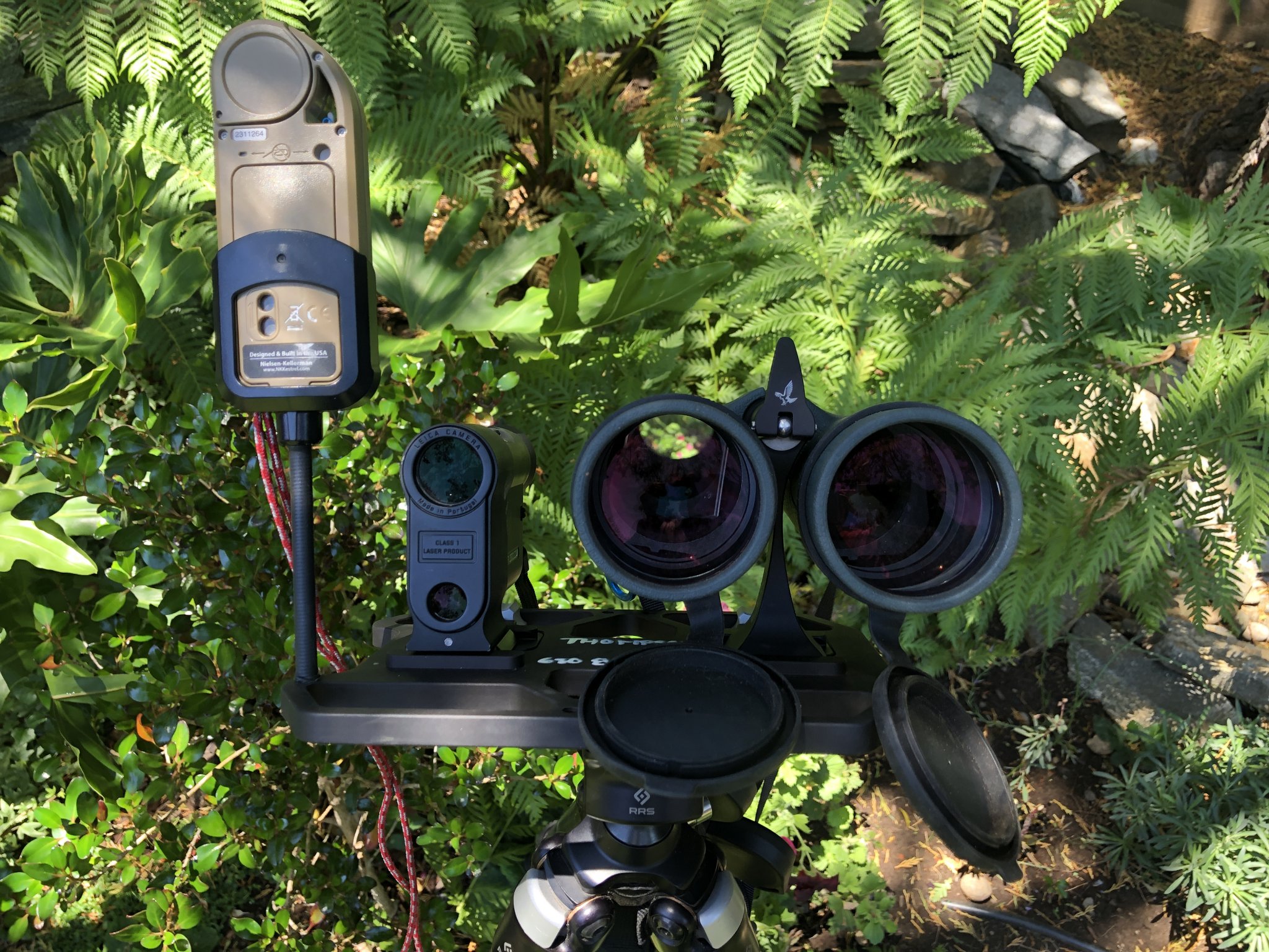

Did some testing this evening with the Sig 3000 bdx next to the leica2800.com. @Diver160651 has the leica and I just got the sig.
The sig was reading targets much farther and more consistantly, the leica was better through tight spots or vegetation. We proved this after dusk by looking at the size of the laser break using his night vision scope. This is at 25yards and the sig is 4x the size which explains why it struggled through tight spots, it's also significantly more powerful, it was reaching out past 4000 yards after dusk, and hitting trees at 2900 yards in full sunlight.

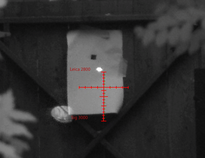

Below is a screen capture from above. We were handholding so we were bouncing all over. The red reticle is SFP on the NV so it is NOT to scale— see, yet another reason not to get SFP.
The black dot is 1.3mil or 1.17” the math worked like this:
1mil at 100y = 3.6”/ .1 = .36 / 1.3mil x .36” or 13x.36”= 4.68” // 4.68 divided by 4 (25yards) = 1.17”
Both units, reticles seemed lined up.
The Leica beam is about 1/2 as tall as it is wide so it helps to know when to turn the unit. Maybe .6 mils vertical
The Sig beam seems to be about 6x larger than the vertical beam of the Leica. And about 3+ times the 1.3mil square or close to 4mils. That’s close to 14 MOA.

This is the best example that I could do right now, I know it is not the exact size of loop hole we are talking about but it is rather small aiming area. I really need a better setup to take picture, this is resting on the window in my truck hitting the furthest pool in the triangle between all of the supports. The picture isn’t actually where I aimed to hit the pole, it is slightly lower but trying to hold still and take picture on phone one handed is hard. The hole that you have to aim through is smaller than the circle and there are actually 5 objects that you have to distinguish 4 are labeled in the picture and then there is a power line between 709 and 909 that actually block the 1109 pole and you are still able to pickup the 1109.
It was difficult to distinguish between 1109,909 and the electric line between them but everything from 909 in was easy.
I was looking for some brush to shoot through but couldn’t find something that would work real well will keep my eyes open for something better. For me I doubt I would ever shoot through anything or need to range anything through a smaller hole than this at that distance and without knowing where the laser is in regards to the recticle it would be almost impossible to know what was getting ranged at this distance.

I think if you look at the rolling brush, you have what I am talking about. Place a 1/2 hidden (peaking up slightly out of the brush like you might see at an Taylor set match) IPSC, near where your 709 arrow starts, so that you have brush leading up and away in that 900 yard zone so that you have more objects much closer to the target, without a relatively clean background (more object closer to the target distance) and you'll get a more realistic feel.

I saw some vid where the guy found the reticle wasn't accurately representing the beam at long distance, so he scanned slowly to find out at what point in relation to the reticle display he started to get hits from the closer object.
I have mapped my beam so that is not an issue. However, I was not using the last setting but the best setting. Thanks to this thread I will switch to the last setting and see if I have better results. Hopefully with some practice and the appropriate setting my experience will improve.
