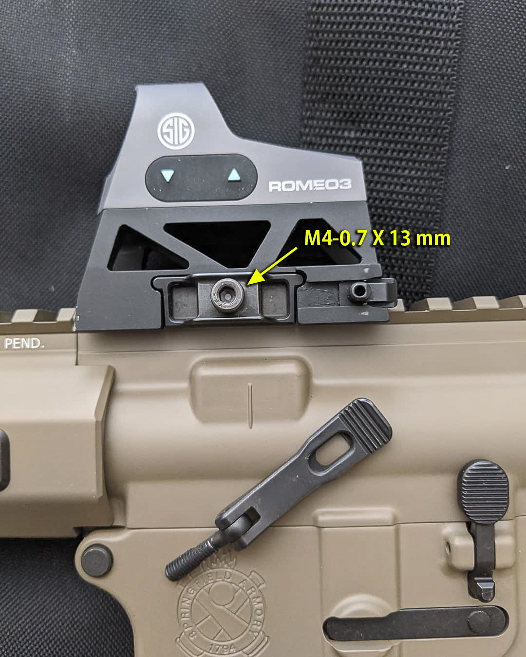

Maybe I just got a bad one, but when the QD lever pops loose on the first dry fire it tends to get your attention.
Yes, I followed instruction and torqued the opposing screw to 18 inch pounds.
It's just a shitty latch catch.
Sig is sending me another riser, but I think I'm just sticking with my Home Depot cap screw mod for now.
It would add about 60 cents to the cost for Sig to include a screw for those who seek a more permanent and reliable attachment.
M4-0.7 X 13mm is about right. I bought 20mm because I wasn't sure on the length and cut to length.
I know it seems simple, but I couldn't find any existing resources online that showed this fix or the screw size, so just dropping it here for others who may have similar issues in the future.
