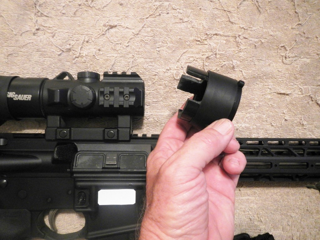

I purchased this prism scope and have been using it quite a bit on an AR platform rifle. I enjoy it quite a bit, but i'm hoping someone can help out a bit with one issue. No scope caps came with the optic and I am having a hell of a time figuring out what I need to purchase. I at least need an objective lens cover. The objective lens has the interior threaded for maybe a sunshade. Any tips on what to look for? My stopgap solution has been to measure the opening and try and get a camera lens cover with pinch side like maybe this : https://www.amazon.com/CamDesign-34...n+objective+lens+cover&qid=1628169926&sr=8-32
Any other bright ideas would be appreciated.

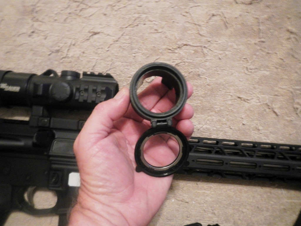

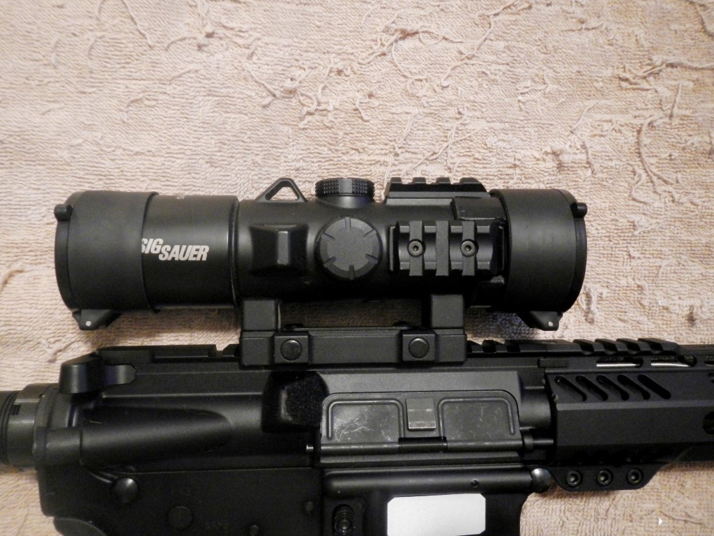

Hi there Devil...I have a Bravo 5 and really like it, too. I also had the same issue as you about protecting the lenses when not using the rifle. Here's what I did: Cut and used a piece of black PVC pipe to fit the rear lens. The PVC has the same inner diameter as the scope outer diameter...1 1/2". Just cut your piece of pipe and carefully do your cutouts to fit onto the scope itself. Use a file to get straight edges and make a good fit. I also used a heat gun to heat the pipe cutouts to make it fit even tighter. The front lens requires a #7 Blizzard Creek Scope cover and a #8 fits the PVC pipe end. The whole affair works well. I also like the see-through scope covers. I like my scope covers to open downward instead of upward by the way. They are more out of the way when hunting, (6.5 Grendel).

thanks a ton. I had hoped someone had gone through this already. I tried a different solution, but will probably give yours a try instead. I got a small bikini cover for it but it is far from ideal. Not a perfect fit and have to keep track of it. Not fire and forget. The #7 cover is the piece of info I was needing. thanks again.
