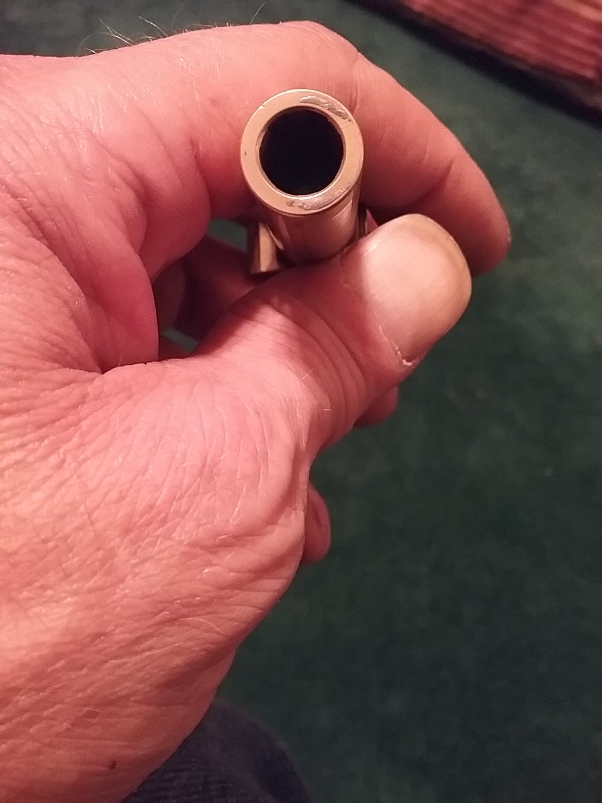

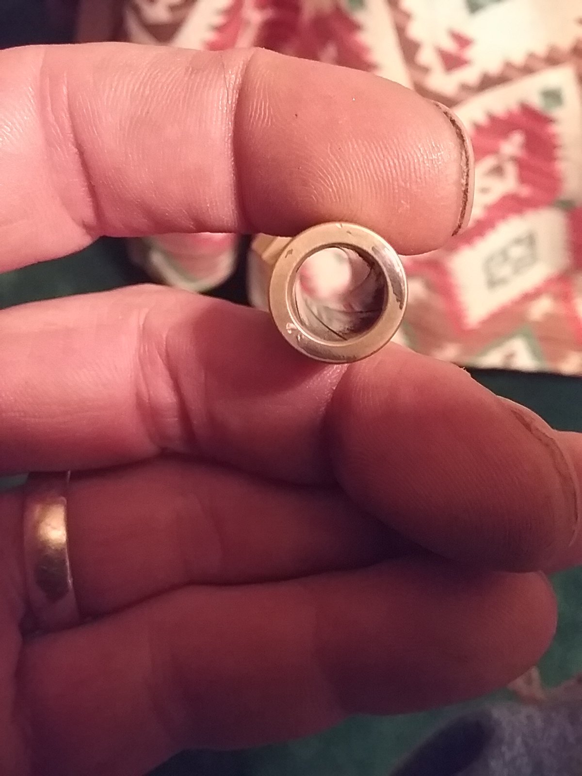

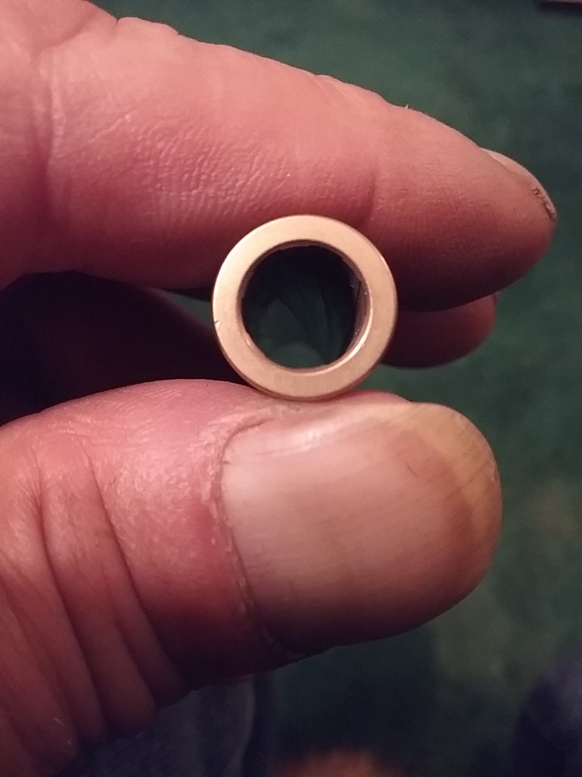

Just purchased the new Sig p365 spectre comp and this is the quality control they let out the door I ended up with. Nicks in the barrel and something like lead or solder globs stuck like a bitch at the crown. WTF, below is their reply. Just pathetic, IMO they should be begging for it back to make it right.
Hello David,
This appears to be removable judging by the pictures and would not affect the performance of the firearm. I would suggest in the future that you use 0000 not 000 steel wool when cleaning finished metal as it’s a bit less abrasive. If you would like to send it to us for evaluation, I can still set you up with an RMA but I have had confirmation from others that they believe you should still have a perfectly functioning firearm.
We can discuss this further and your other questions when you are free.

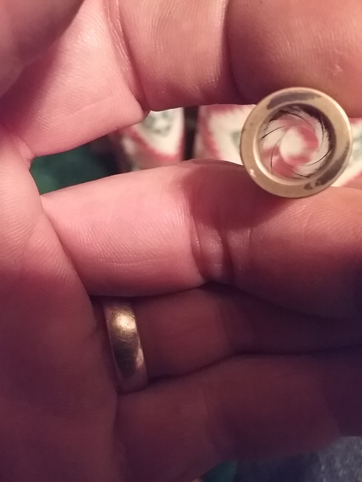

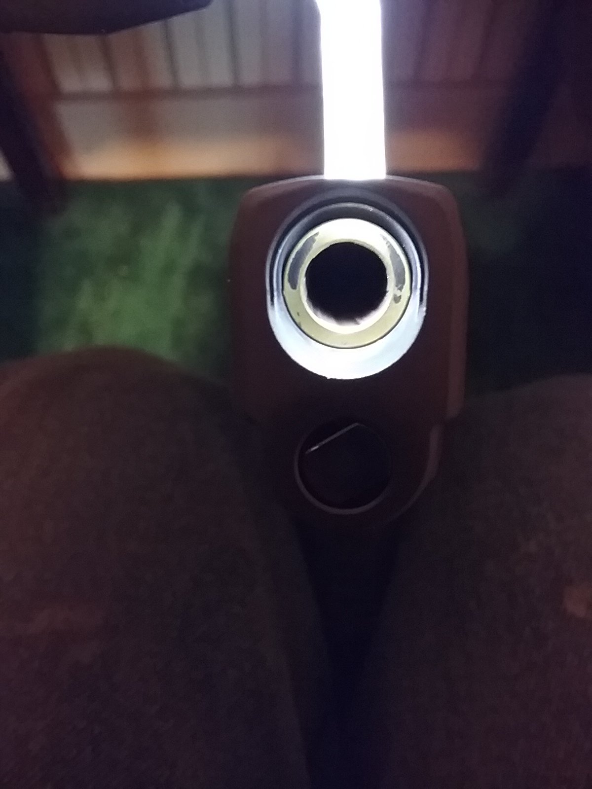

After an hour scrubbing and picking this is what we got. What would you do? Right now just keeping my temper and mouth in check but kind of expected more from Sig and better service for my $1300.

That's not a good look for them. That said, the 'after' pic makes me think you've probably used your time more wisely than chasing it further with Sig. But then again this kinda thing happens because too few people really make noise about it when it happens to them.

Having globs of lead at the end of the barrel isn't like having a dirty windshield. I expect powder residue from the factory test fire not melted lead globs on the barrel. I had to use a razor blade and 000 steel wool to get it off, not cool.
Not trying to be a smartass but is this your first handgun with a comp? You are gonna get lead buildup with any bullets that have an exposed lead base. It's a pain in the dick.
Sig missed it during QC for sure. No QC in the world is gonna catch everything.

Yes it is my 1st with a comp. all the others I own are not and I have a few from many different Manufacturers. If this is what happens from a factory test fire, my understanding is they fire them with one round to insure it functions like it should. At least all my revolvers had one cylinder that had powder marks, mabey semi's are different correct me if I'm wrong. Either way if the end of the barrel is gonna get all that lead build up on it after even a couple shots that to me would prove to me to be a very dangerous and VERY unreliable firearm to bet your life on.
Like I said I am ok with powder burn as that shows me that they did in fact test it but to have globs of melted lead anywhere especially the end of the barrel.. totality unacceptable IMO and before I started cleaning it off I could feel it easily with my finger and snag it with my finger nail it was just covered in black spent powder.

It is important that the compensator ports be kept free of buildup since excessive accumulation deposits in the ports, or use of incorrectly loaded ammunition, can interfere with the gas dynamics of the handgun and result in the bullet hitting the compensator port. Such buildup is inevitable if you are using bullets with an exposed lead base. For that reason, we strongly recommend that bullets with an exposed lead base not be used in any Infinity compensator equipped firearm. This is good advice for any compensated firearm, but is especially important for IMM Open Users.

You were saying you couldnt see how lead can build up. I posted it certainly can and will. No, a little lead on your barrel won't stop it from working. And with the generous clearances on your "comp" it likely never will either.
I get the pics are from a new gun. Sig likely test fired it. Your FFL may have even fired it. It didn't get completely clean before you picked it up. That's all. It isn't a conspiracy.

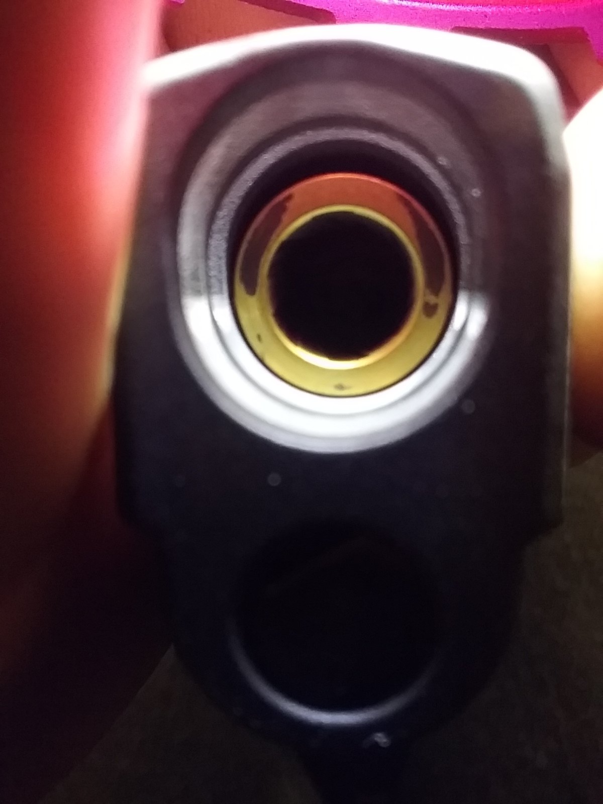

Here's a pic of it in the slide before I got the garbage off.
Well, you bought the model with the stupid built in ghetto compensator. Comps build up a LOT of fouling. And I have no idea where you got the assumption that test fire was only a single round; did Sig tell you that?
Look at the clearances between the barrel and slide in that POS. Wow. I'm betting they did that specifically because of the fouling levels they expected due to the comp.
BTW for future reference, well-executed comps don't have holes large enough to fit the barrel through them. This one is a necessity of being slide mounted, but that doesn't make it good and does bring it's own set of problems. It's similar in concept to those "bushing comps" sold for 1911 pistols, although I'll grant that it's arguably a little more effective.
