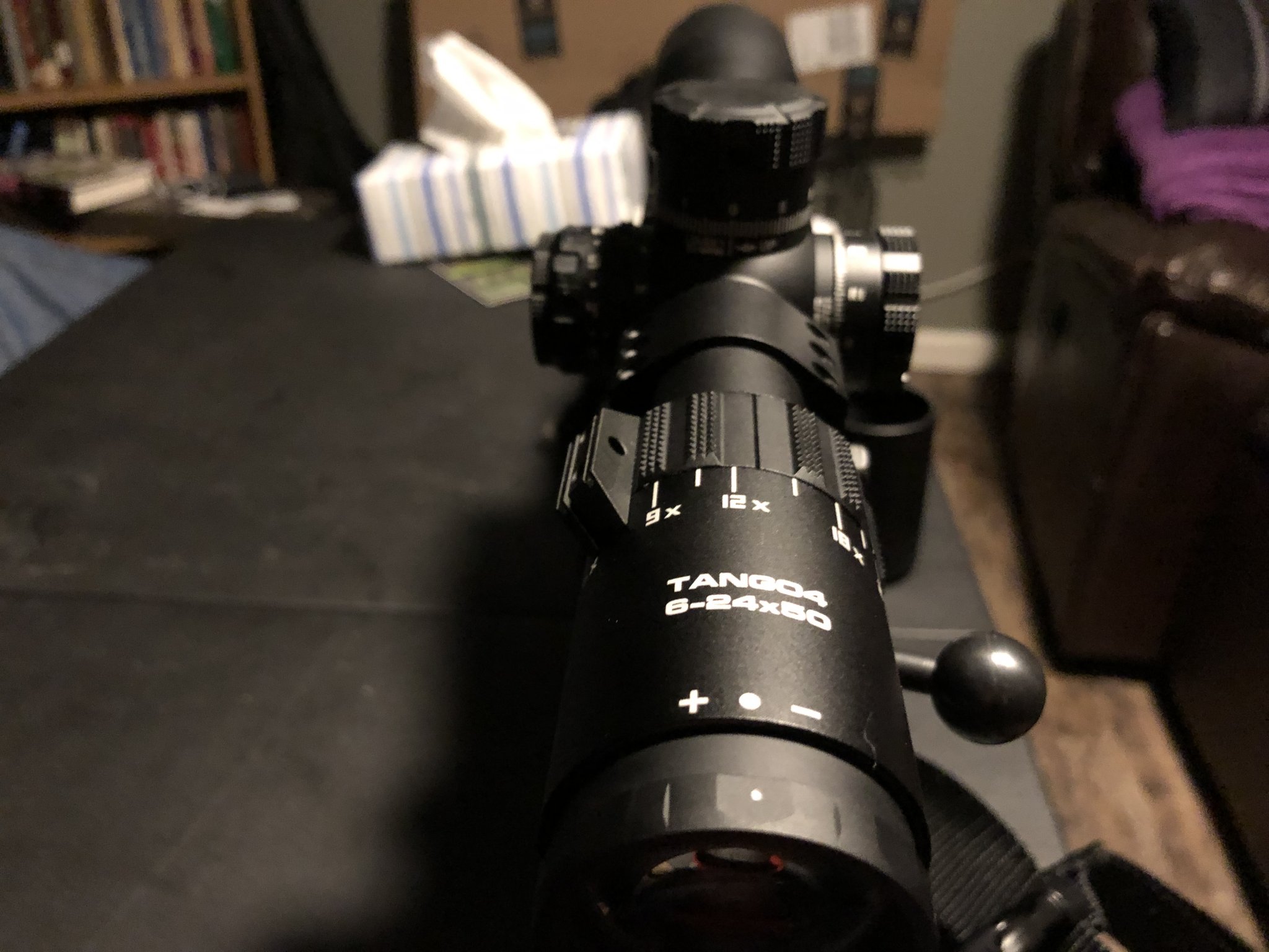

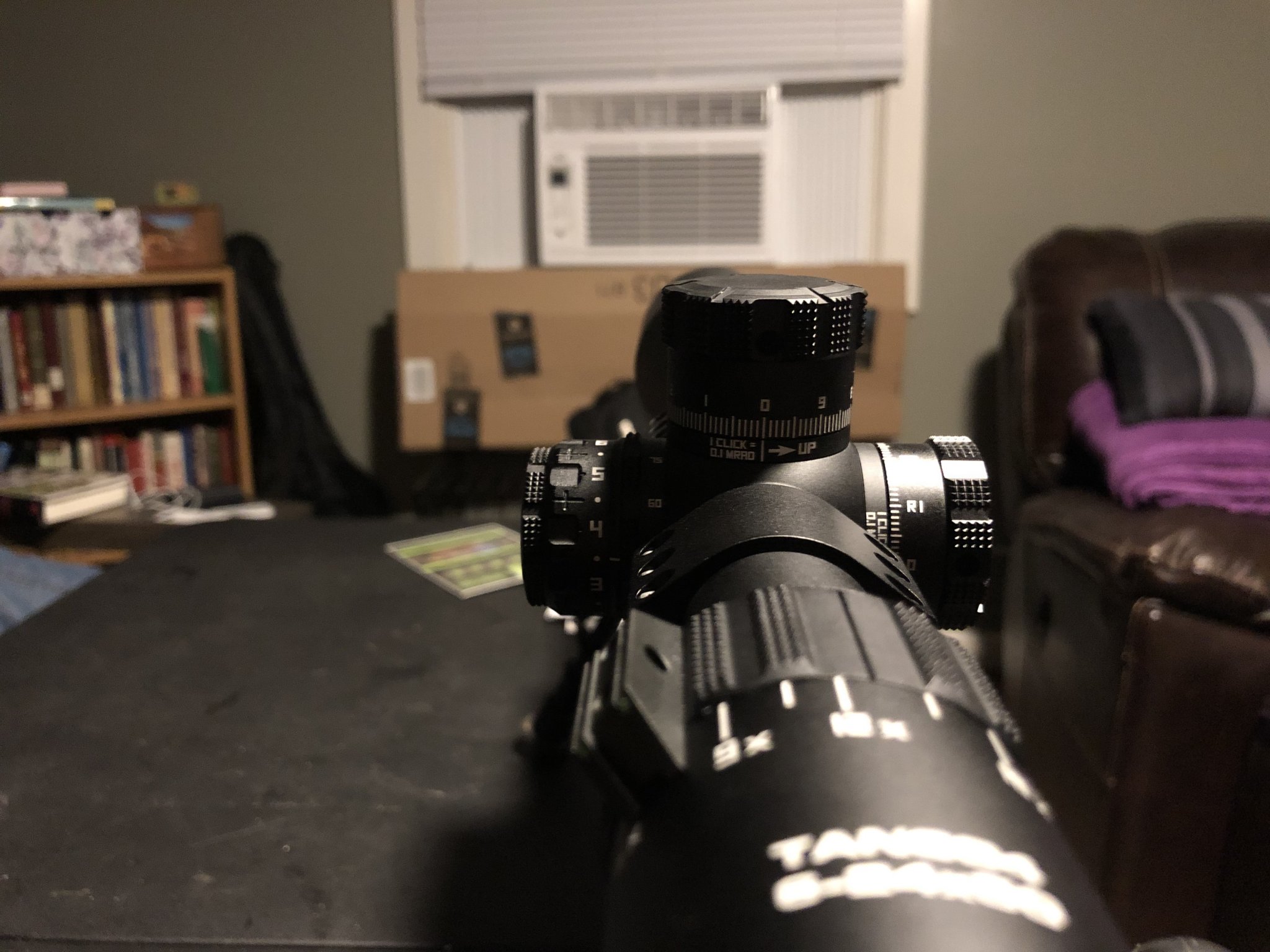

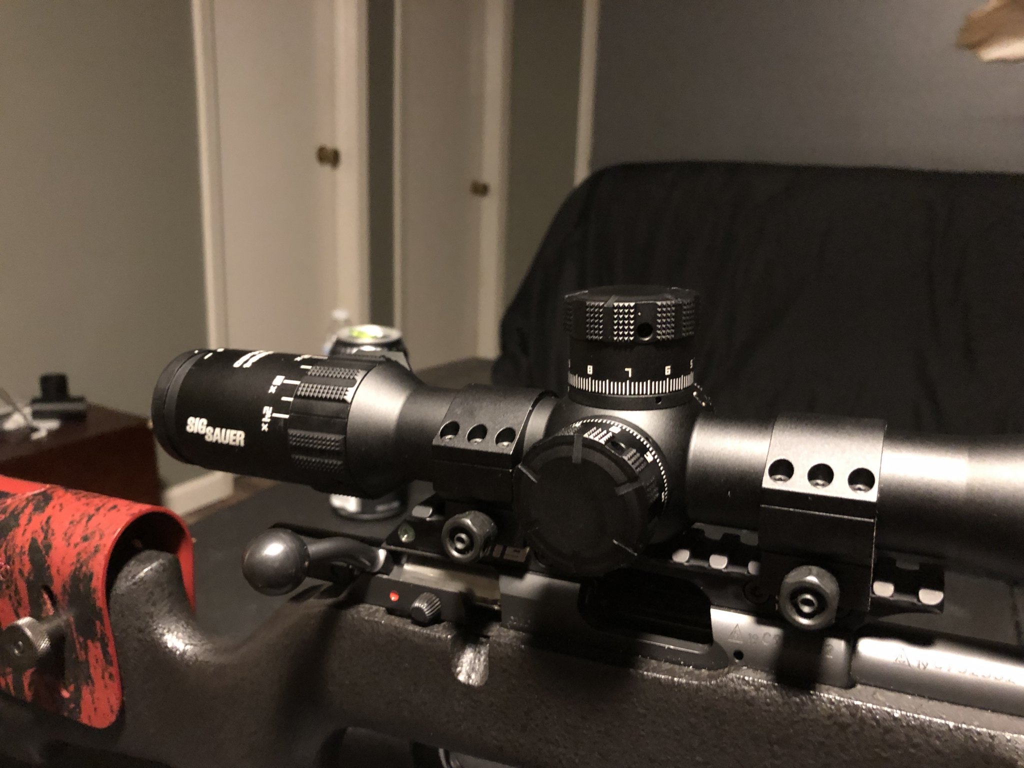

So I received a new scope from sig as a replacement for my old one. I cannot find any information on this thing. It looks like the turrets received a nice upgrade, but I can’t figure out how the zero stop works!

I have a gen1 tango4 6-24 on a rifle that I dont regret buying at all. I also purchased a gen2 tango4 6-24 recently bccause it was a good deal online. I havent been able to get my hands on it for I am not home. I was sent pictures when it arrived and I noticed that the turrets seem to be different than the gen1....I would be ok with that for they were odd to quickly set/read. I also noticed from my pictures that the turrets didnt have the "SIG" on each cap, yet online pictures all show that they do BUT yours doesnt seem to either. I was getting the feeling that I may have received a knock-off but if you say you got yours as a replacement from them, then I feel better.
how do you like the new turrets?
what happened to your gen1?
why the issue with the zero stop? ever get that sorted?
Turrets are a little mushy.
They also don't lock, which is bullshit because they still advertise them that way.
Zero stop is literally just loosening the screws and pushing the turret down at 0 then tightening the screws.
I bought one, got rid of it for a gen 1 with the locking turrets (since that was 90% of the draw for me).
