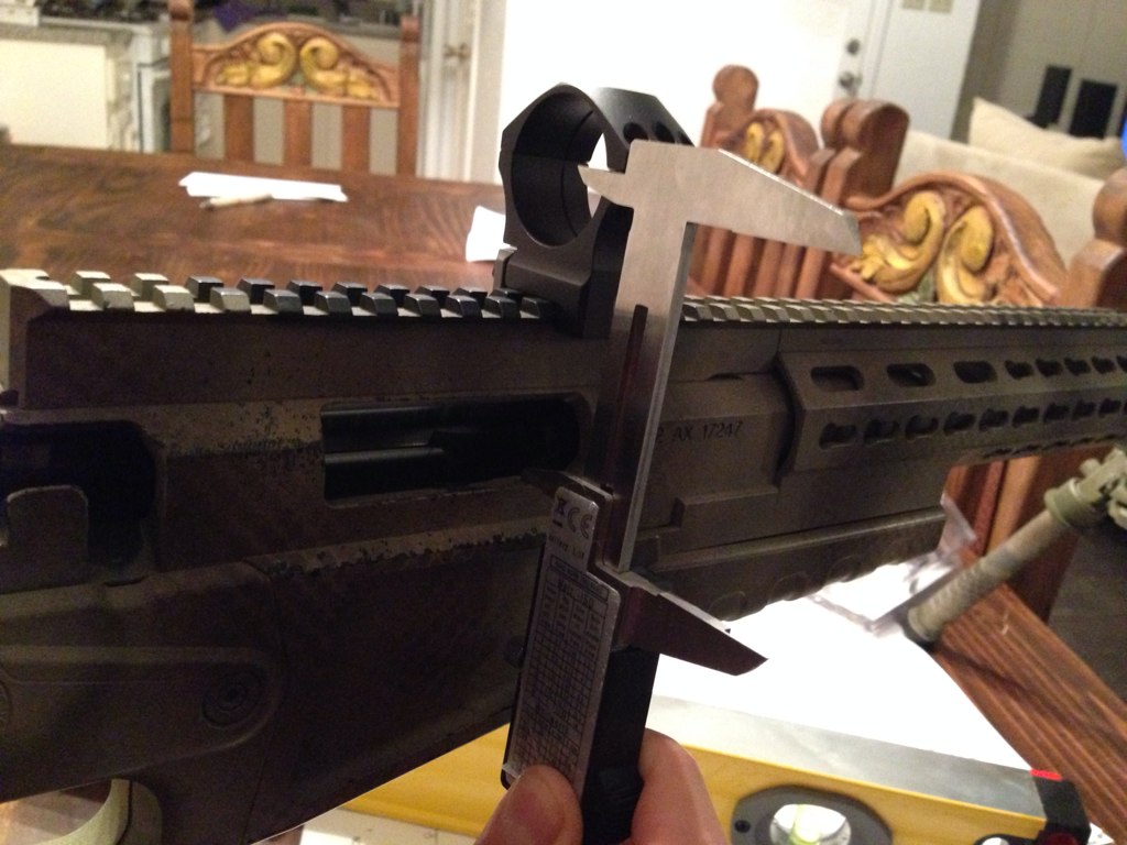

took this pic many years back while discussing the same topic

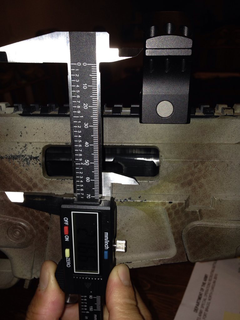

Just making sure that I'm doing this right. Center of ring (where the two halves meet) and bottom is the bottom of the rectangular opening where round ejects from.
I get a total of 2.766
ImageUploadedByTapatalk1405229373.113494.jpgImageUploadedByTapatalk1405229474.747323.jpg
Sent from my iPhone using Tapatalk
closer to center of the ejection port, or centerline of bore. That's the # you need. after you input that, change the height +/- in your app and see what happens.
