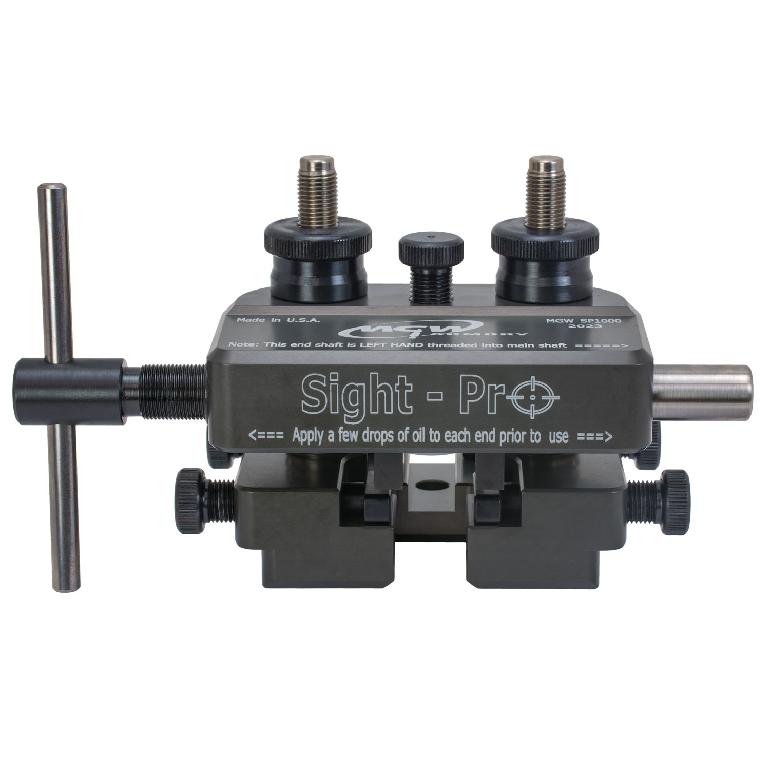

This is a buy once cry once sort of thing. I have used the cheap shits, brass/punch and then finally this, and had to buy one. Since then have changed a few dozen sights out and NOTHING is better.
Buy it and you can pass it down to grandkids. They actually came down in price from when I bought mine about 10 years ago.
I'll try the one from Nstar since atomic says he's used it to install tall sights ,and the price is alot more reasonable , would hate to spend 300$ and then find out it won't work with tall sights , thanks for the info guys .
Agreed - this is the best I've ever used - will easily adjust to suppressor height sights. The only caveat - you have to buy separate slide plates for various brands / models. But, it's great.

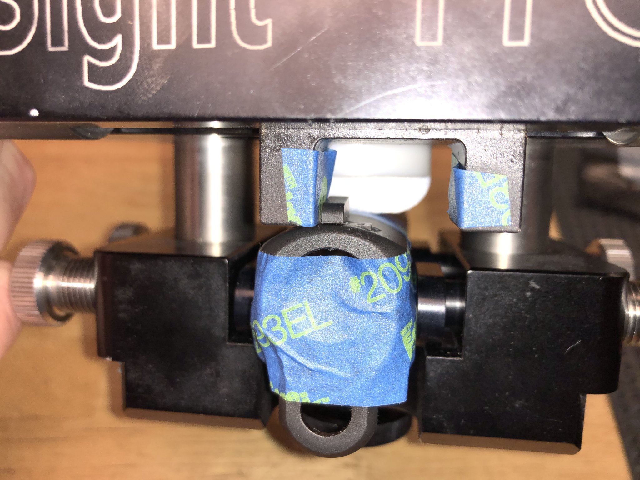

The NC star will work on a m&p, I’ve done a few. Just make sure to tape it up good so you don’t beat he piss out of it.

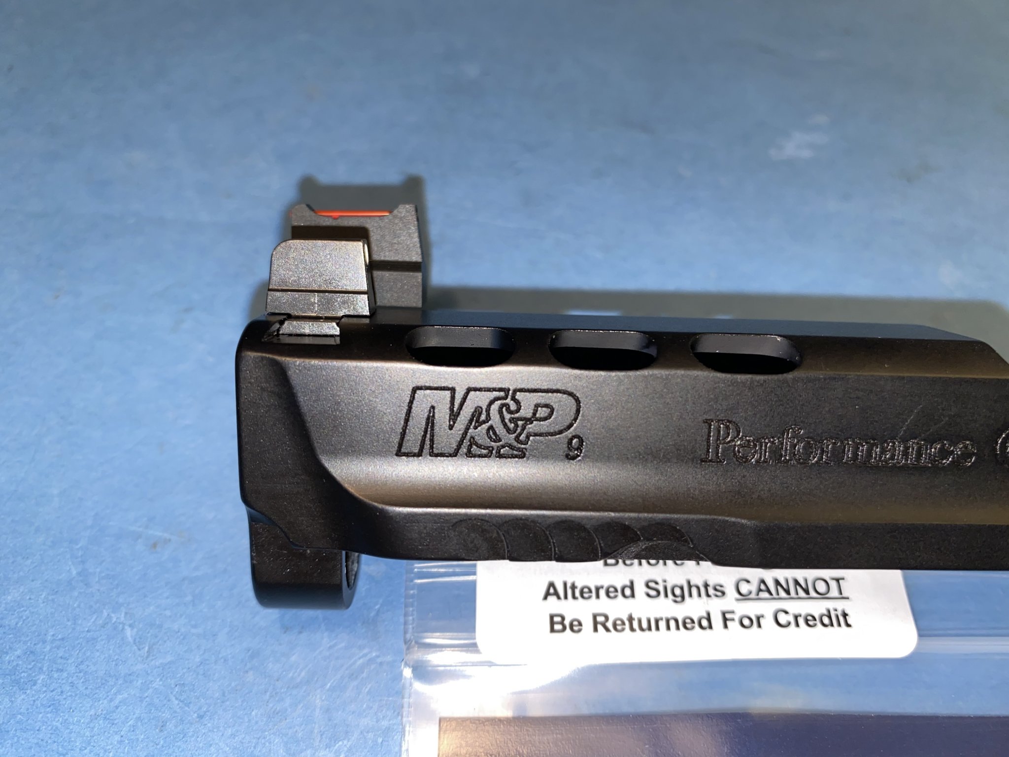

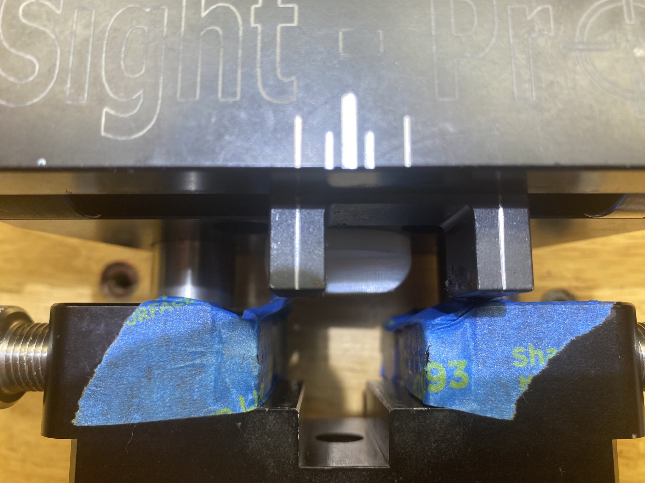

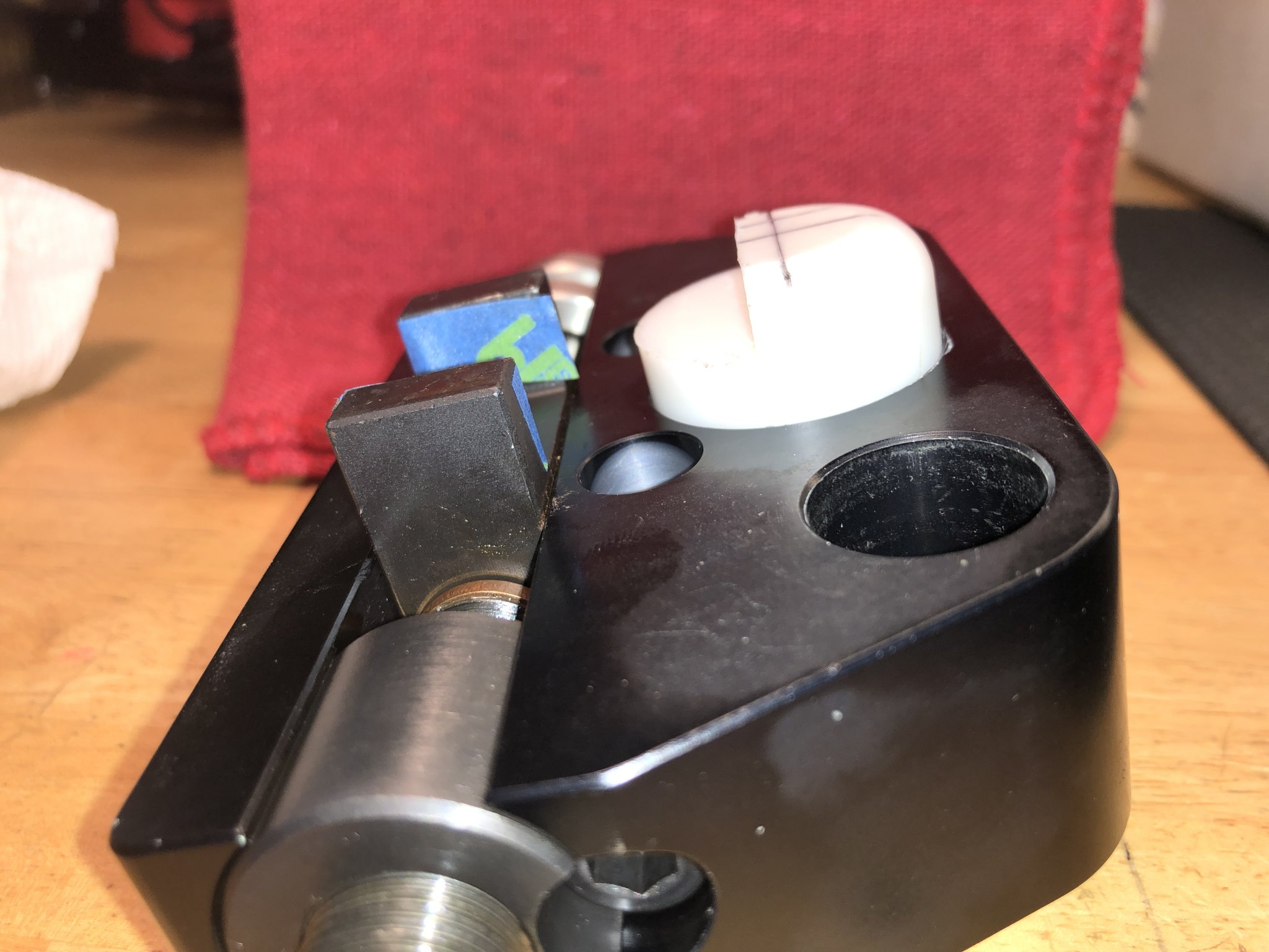

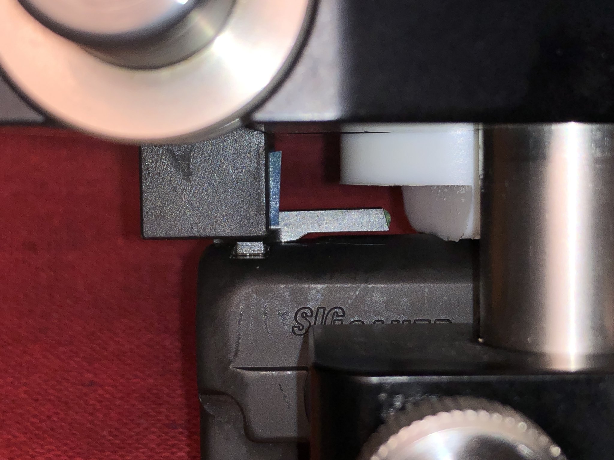

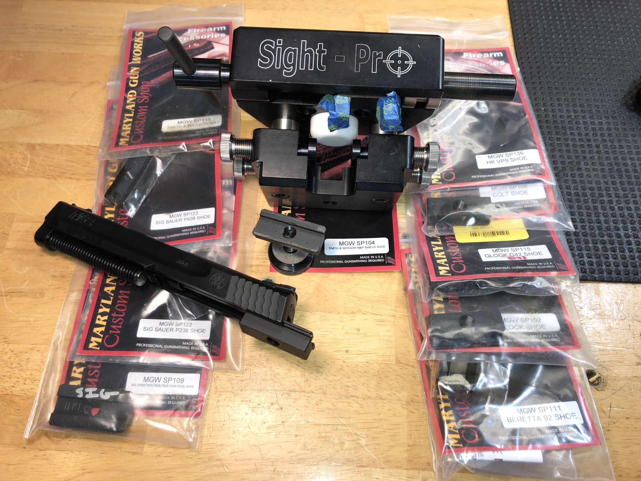

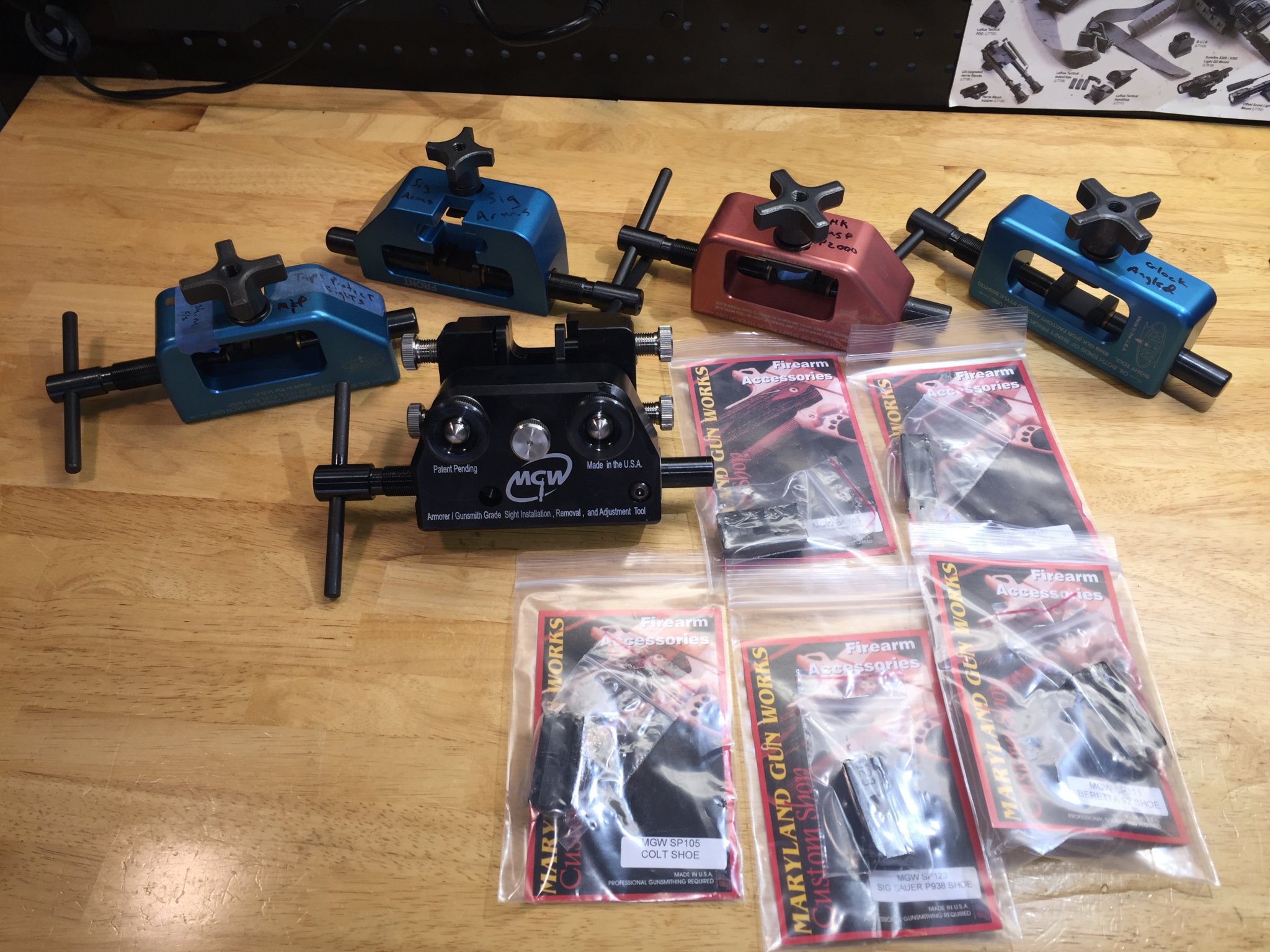

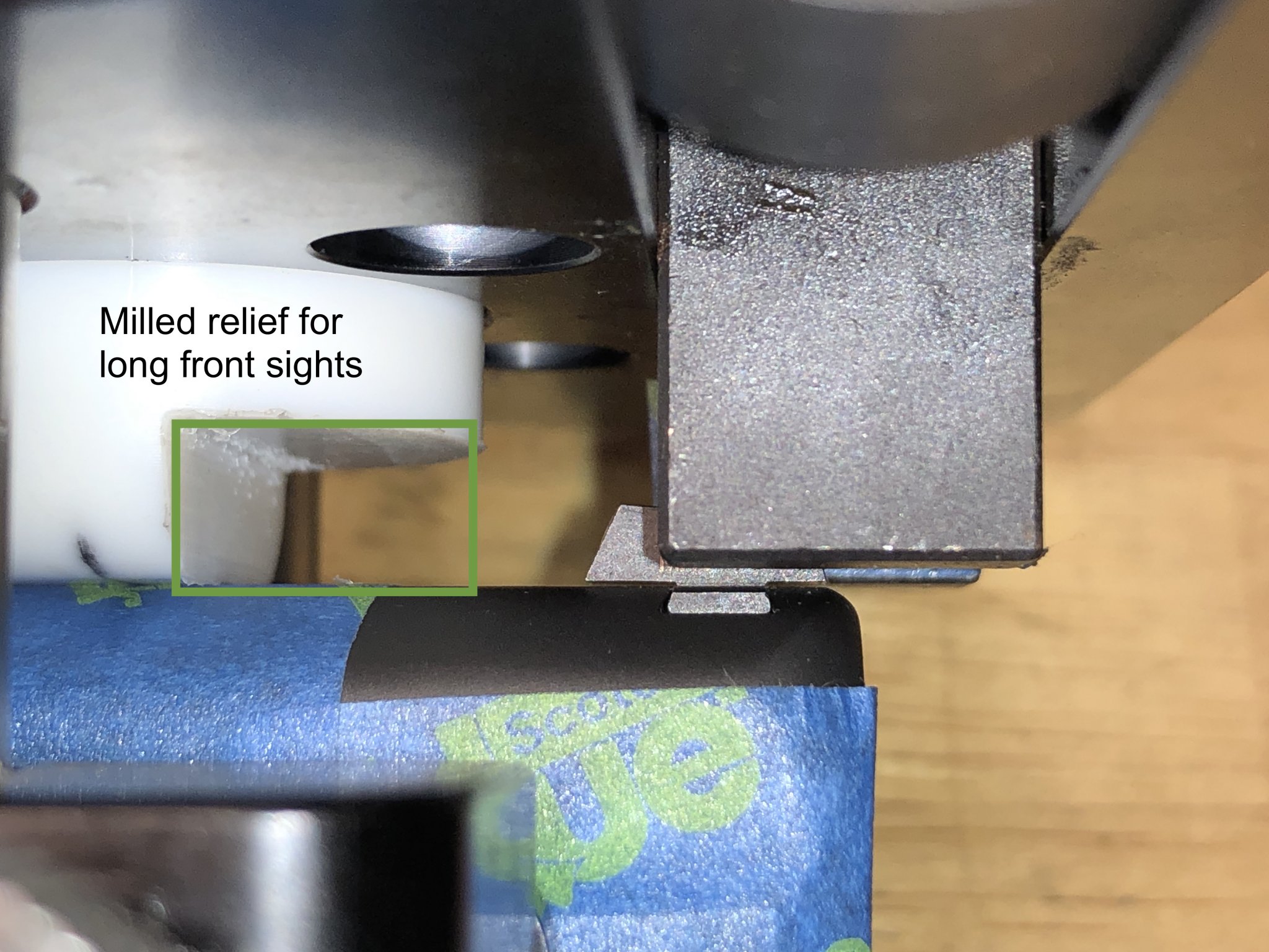

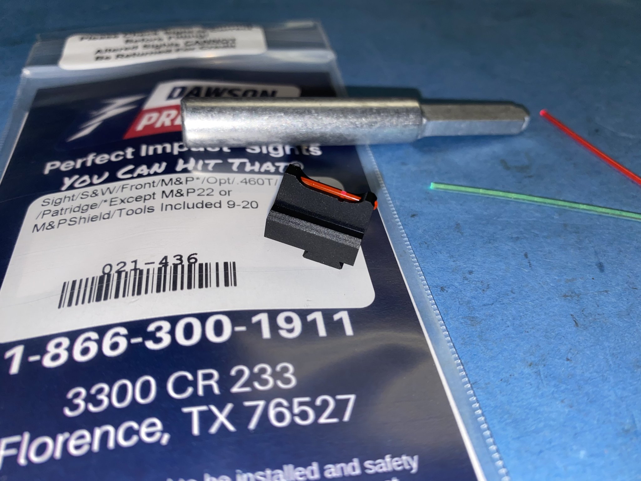

With a good vise, properly shaped punches work just fine. Many years ago I started purchasing the MGW firearm specific sight pushers as that was all they offered. The Sight-Pro with firearm specific pusher mounting "shoes" is the best I have used. It will accommodate installation of tall sights. Two shortcomings I have encountered are (1) the top slide polymer support diameter was too large to install long front sights so I modified it for those situations (2) there were no centering marks to assist in guiding the sight to desired position, milled some lines to solve that issue. These Dawson front sights are 0.460" tall with room to spare.

With a good vise punches work just fine. Many years ago I started purchasing the MGW firearm specific sight pushers as that was all they offered. The Sight-Pro with firearm specific pusher mounting "shoes" is the best I have used. It will accommodate installation of tall sights. Two shortcomings I have encountered are (1) the top slide polymer support diameter was too large to install long front sights so I modified it for those situations (2) there were no centering marks to assist in guiding the sight to desired position, milled some lines to solve that issue. These Dawson front sights are 0.460" tall with room to spare.View attachment 8192662View attachment 8192664View attachment 8192665View attachment 8192666View attachment 8192668View attachment 8192669View attachment 8192670View attachment 8192672View attachment 8192673View attachment 8192680
When I was shopping around that was the best design and most versatile tool I saw. If I had known then I would be building as many pistols as I have I would have bought it then. Ive paid more than $300 for parts and other dumb crap.

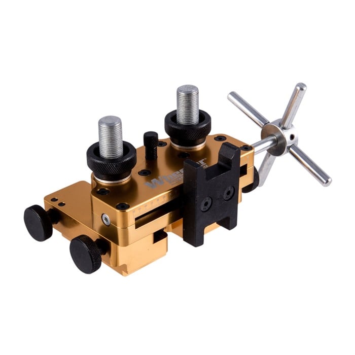

Last two times when I needed to replace iron sights, I ordered a used sight pusher from Amazon Warehouse, it is a copy of Wheeler pusher Amazon product ASIN B07ZQF7G79The pusher worked well, and after I was done I just returned it, paid $5 or $7 for return shipping label.
I'll keep that in mind, I doubt it would have worked though, that front sight was a sumbitch, wish I had just milled it out to begin with and saved alot of time and frustration, the sight picture is alot better than the photo I posted , it really is a big improvement over the stock sights and they're night sights too.
