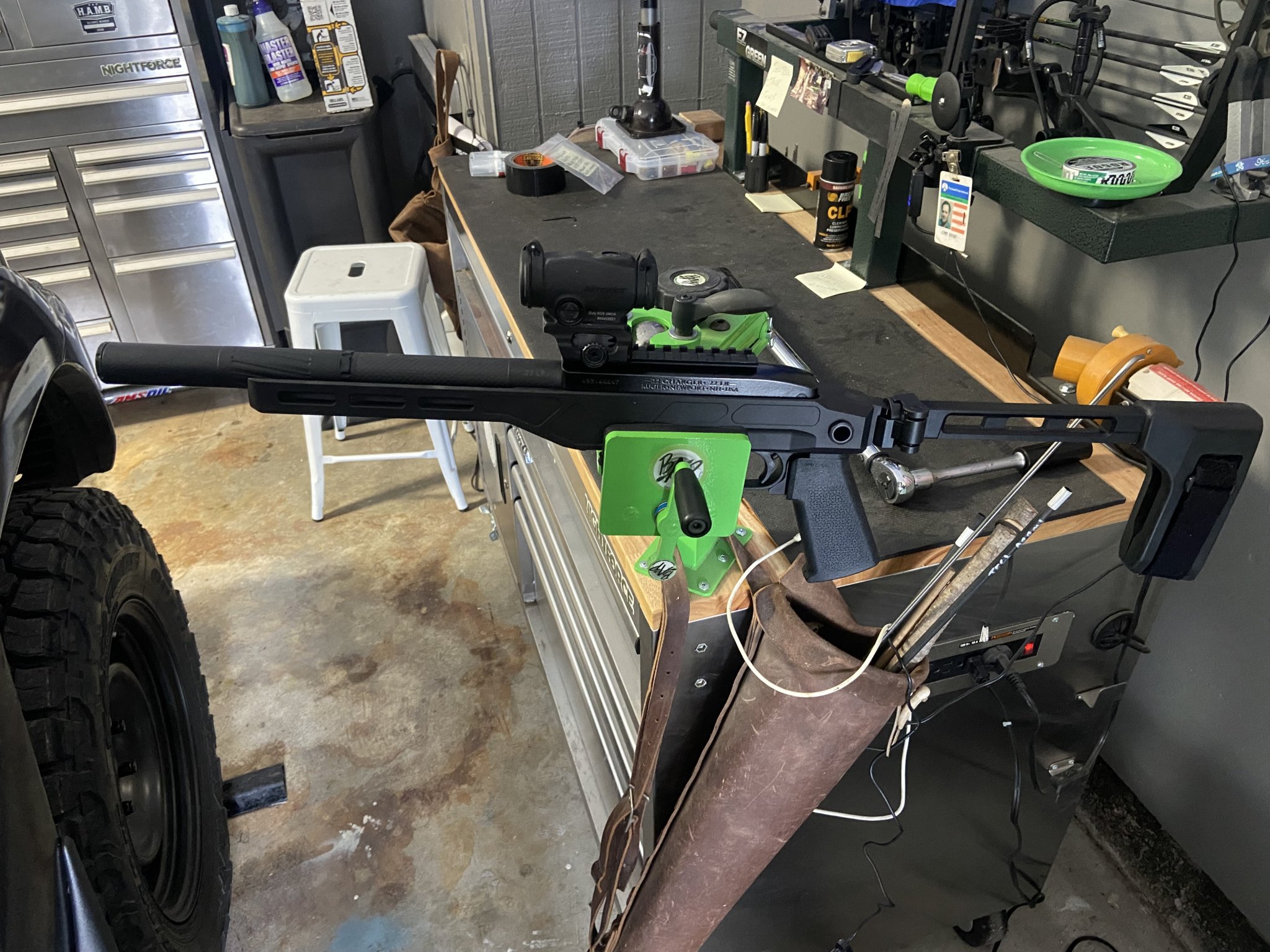

Took charger out for first time.
Aimpoint duty in a 1.53 tall mount.
Hv ammo(1235)
I plan to use cci sv though but didn’t have any.
Hitting 1.5-2 in low at 25 yards with my elevation maxed.
Should I get the 1.94 high mount,a diff pic rail with moa built in or just zero at longer distance and live with it?

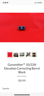

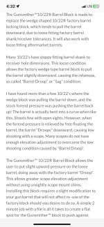

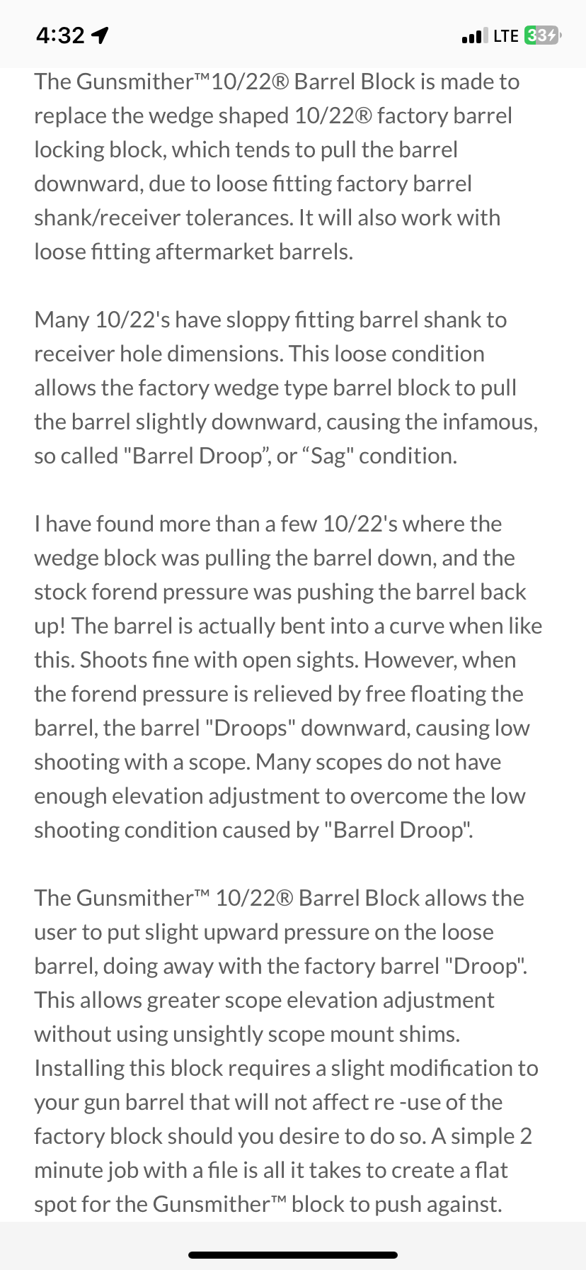

Barrel took some effort,not loose at all.V block torqued to 12in
