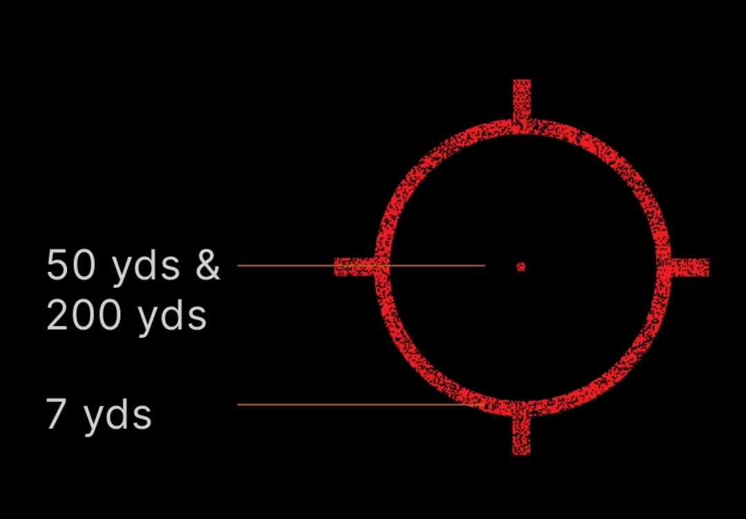

I finally got to the range and sighted it in at 7 yards. It was right on when I shot below the circle, but when I took it out to 50 yards it shot really high, almost at the head of the silhouette. Am I doing this correctly?

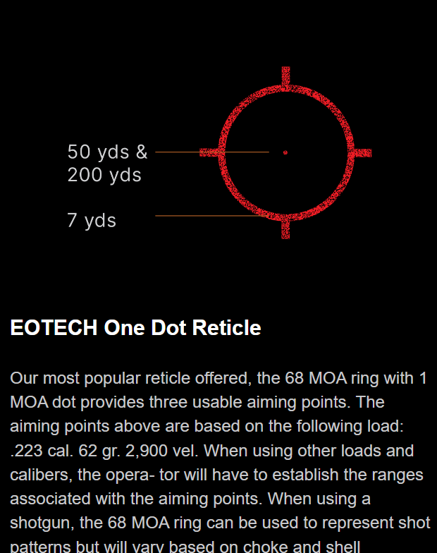

As it shows in this pic, I zeroed in on the picture where it says 7 yards.

You won't be perfect doing it per the video, but even w/different ammo you won't be way off either, not @ 50 yds because 50yds. for a rifle round is basically a "line drive". Something is "out of whack" bet. the Eotech/it's mount/the gun (barrel)
Saying that doesn't help U though, so as somebody else suggested, you might need to go ahead and zero it @ 50 yds. first.
I'm indeed curious as to what the problem is, so be sure and drop a follow up, regarding what turned out to be the glitch as U spend more time w/the Eotech.
What long gun and ammo are U using w/it.
BTW: When it was high @ 50 yds. what part of the silhouette w/U aiming at/can U provide a pic to show what U were aiming @ and where U hit.

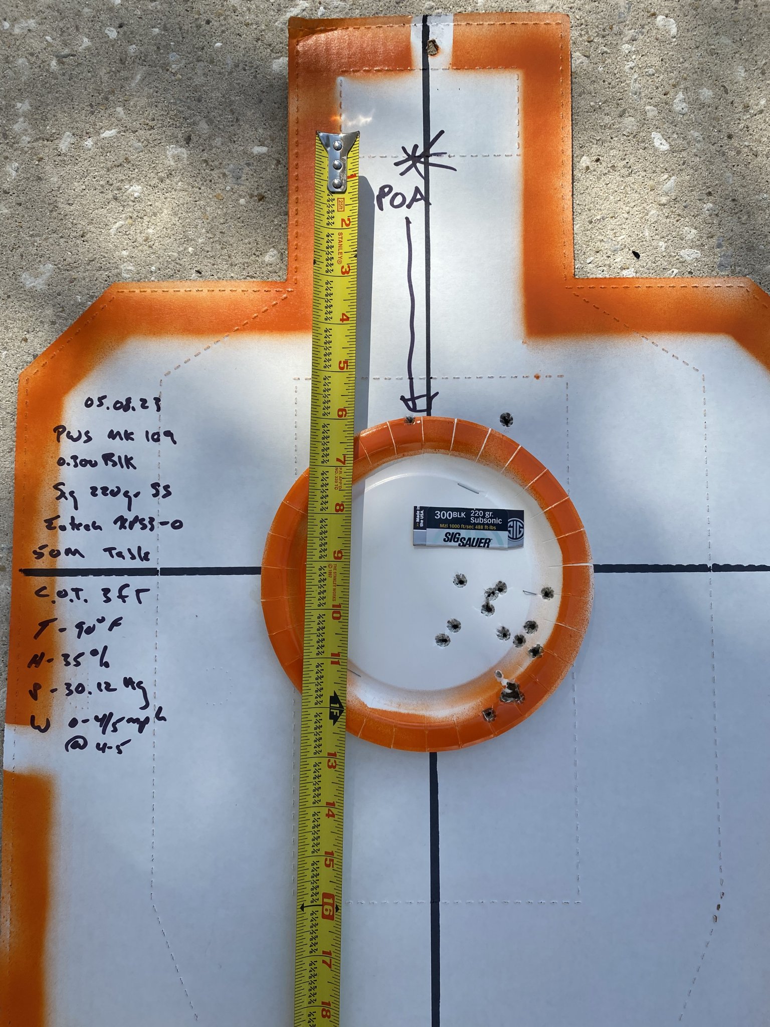

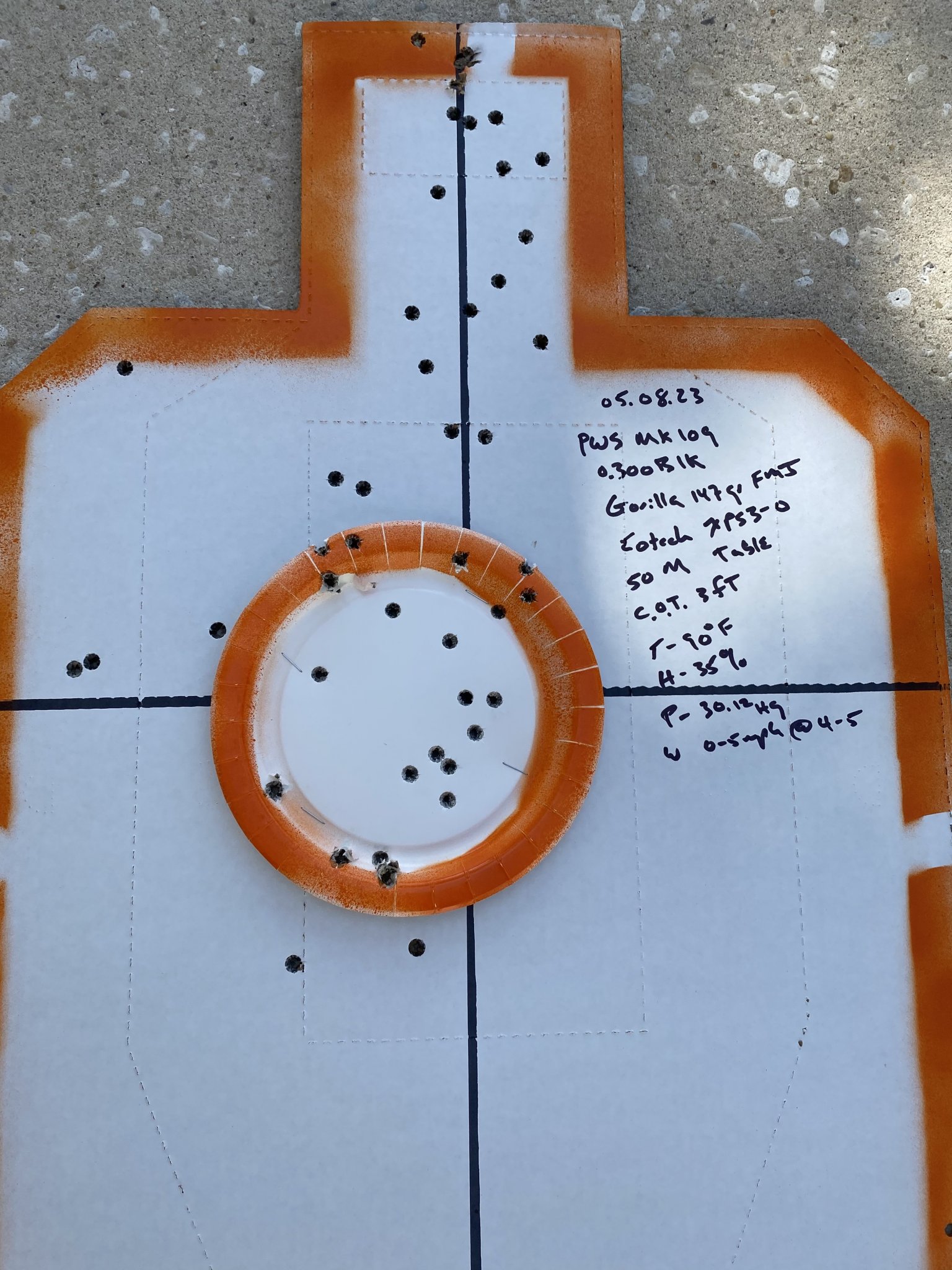

I was zeroing a XPS3-0 @ 50 meters the other day mounteg on a PWS Mk109 (9.75") .300BO. Quite a difference (10-12") of POA-POI differential between 147 FMJ @ 1820 fps v. 220 gr sig subsonics. I would recommend starting at 10 yds then move out at 10 yd incremeNts to stay centered on paper.
You're using the right part of the reticle at 7 yards, right? I would do this to get on paper (if you have to) then sight it in at 50 yards. That should put it back on at 200 yards depending on velocity and ammo of course. By the way that reticle is set up for 62 grain, it'll fluctuate a little bit with different ammo...
