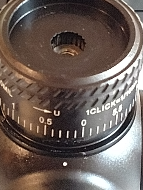

On my scope, I noticed that both the elevation and windage turrets are marked "U->", missing the customary "R->" on the windage turret. I contacted support via email to request a replacement windage turret. They advised individual parts are not available and I should produce an RMA request. I did so, but decided not to eat up the discount on the scope with shipping to fix a problem easily worked around. I'm assuming that the "U->" on the windage turret means "Right".

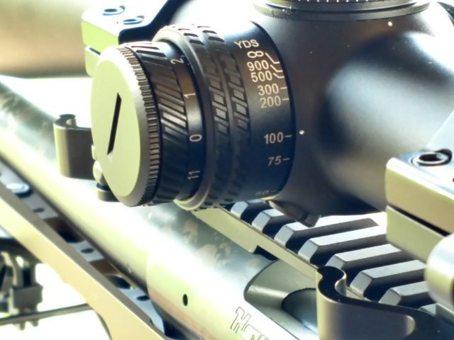

They are understandably rather low profile in view of the 11 MIL advertised adjustment range. The clicks are acceptably loud and crisp. The windage turret appeared to snap louder and crisper though. Here is the range of adjustment on my scope installed on the 20 MOA rail:
Elevation
3.4 MILs Down
9.7 MILs Up
Windage
4.1 MILs Right
8.0 MILs Left
Despite the advertised range, the above shows a total of 13.1 Elevation and 12.1 Windage adjustments. At zero to zero rotation is 6 MILs.
There is no zero stop, but there is a zero lock. This is done by pushing the turret cap down fully. Reset to zero is achieved by removing the screw top of the cap, lifting the turret off, then replacing it with the 0 over the white index dot.
Two things bothered me about the turrets. First, the splines do not exactly match up so the 0 is directly over the index dot. You have a choice of .1 MIL one way and .2 MILs the other way. The other problem is a lack of rotational indexing. The turrets do not raise during rotation, which means there are no height indicators to show number of turns. If you go past zero one way more than one revolution, you have to remember how many clicks get you back to zero.
The focus/parallax turret is capped by the reticle illumination control. The good thing is the setting of 100 yards really was exactly 100 yards. The bad things are the turret is very hard to turn and you have to cope with the illumination control ring. Hopefully, mine will loosen up after more use.

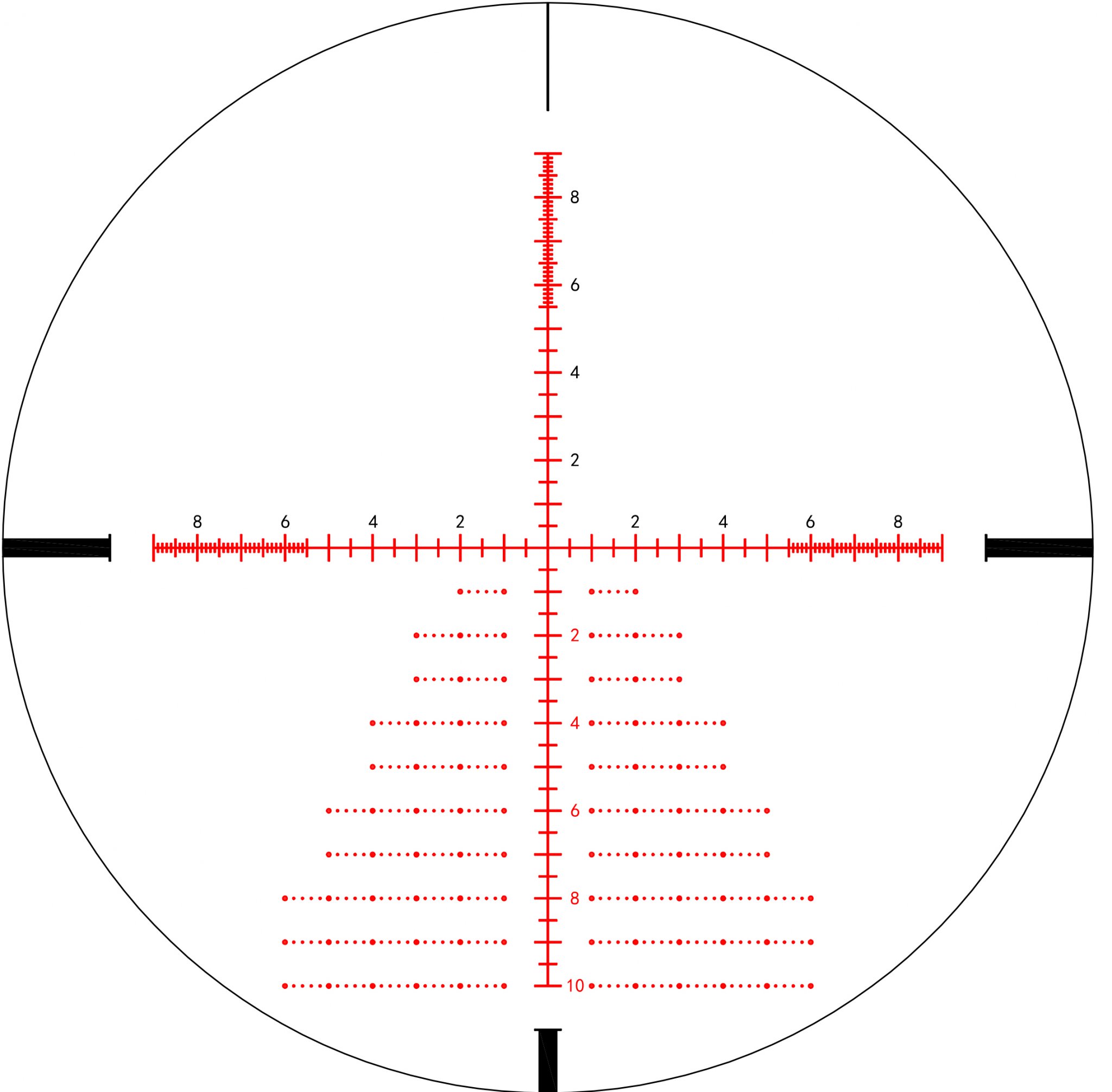

The reticle is sharp and fine. Sightmark calls it the LR2 reticle. Being an old school Mil-Dot type of guy, when I first started seeing these reticles, I was amused. Now, I am looking forward to exploring the possibilities. I will admit that theoretically, the reticle may lend itself to more accurate lead and hold-over shots at longer ranges.

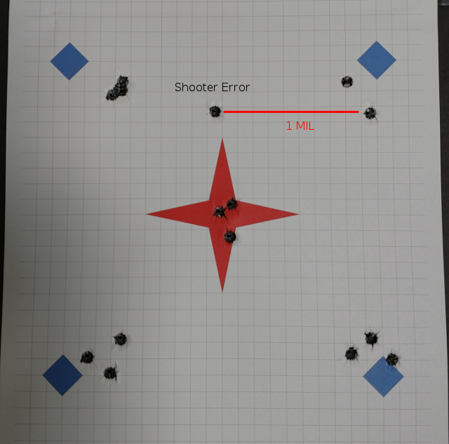

I ran a box test the best I could with the ammo I had loaded, weighted by my rusty marksmanship. Overall, the results are quite good:
One round was fired at the 100 yard target between each adjustment. The order was center, bottom left, top left, top right, bottom right, repeat two more times. The grid lines are 1 centimeter. The good news is the tracking is dead-on, as you can tell by the respectable group at top left. The bad news is the clicks do not appear to be a true .1 MIL each. To me, the group centers look more like 8 centimeters as opposed to 10. The only way to tell for sure is to bolt that scope down and track across a measured grid. The "Shooter Error" hole at the top center of the target happened right before cease fire. I hurried and dialed in the wrong adjustment.

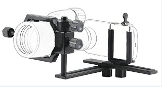

BTW, I have ordered what appears to be a suitable scope/phone photo adapter and I do have an excellent printout of the 1951 USAF resolution target, so I quite possibly may be able to upload some through the scope pictures later in the week.

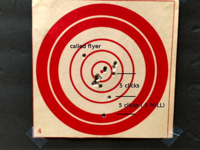

The cold bore shot was low 6 o'clock. Then I worked up 5 clicks twice to get to center. Everything except the called flyer are the result of dialing in. Pretty good 10 shot group at the 7 o'clock. After that I did one click up and one click right to finish up with the two almost dead center.
I really didn't have good targets for the conditions at longer ranges today. Between the mirage, dust, glare, and terrible wind conditions, I decided to wait for another day for that testing. The wind was zero to 15 all over the place, mostly direct right to left. Needless to say, no pictures from the 200 yard fiasco.
Lastly, phone/scope adapters suck. I'll do my best to get some pictures through the scope next time as well.

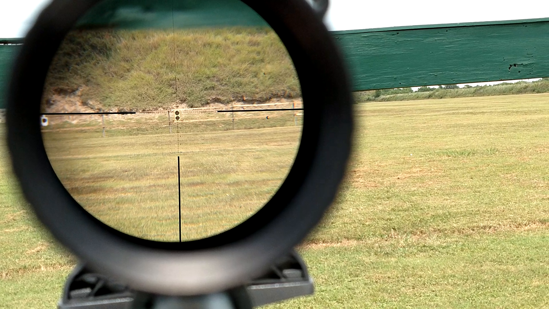

I finally managed to get some kind of images through the Sightmark Citadel itself.
This is the view of the target line at 5X.
The is the view at 30X
To be honest, the lack of sharpness is more due to the phone itself (or my use thereof) and the mirage effect. Naturally, the scope is not as sharp at 30X as it is at 5X, but it is still quite good.

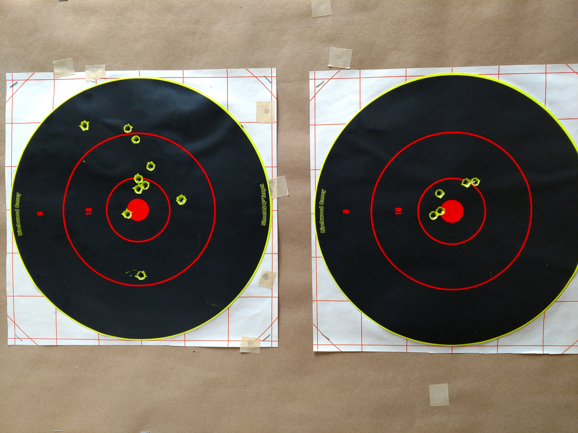

The following targets at 200 yards prove an interesting story.
The left target was shot with the LC/LR thrice fired reloads. The six-o-clock hit is after coming directly from the 100 yard line zero check with no come-up. After dialing in the 5 clicks up according to my range card, the next hit was an 8-o-clock bullseye. The fact that the rest of this hits are all over the place are due to me being out of practice for a long time, getting used to the Stinger rest, but mostly the ammo.
The cause of inaccuracy is pretty much verified by the right target. For those five rounds, I used the reloads with the new PPU cases. Though the individual loads were not hand measured and the SD was all over the place, the accuracy of the PPU based loads is much more respectable.
The lesson is, once fired LC/LR is always a gamble. You never know what fired them, but you can figure that a lot of them went through M60's, M240's, and M14's. The chamber size and headspace are going to be all over the place. I can pretty much tell that if I want any accuracy out of them at all, they will have to go through a small base sizer, get their necks trimmed, and anneal them. I had just been using them for plinking practice, but I think I'll do some work and see if I can get some accuracy out of them.

Truth is, that crazy tree style reticle is beginning to grow on me.
Once you use a tree for a bit, there’s no going back. Who has time to twist knobs? Reticle is thin and unobtrusive when scanning for the target on low power, zoom in, make the hold and bang. Also great for measuring misses and adjusting.

I've got the same scope on my savage 110 tactical .308 with 20 moa rail. My issue is with a 200 yard zero, i still only have 5 mils of elevation left. Seems the 20 moa rail would help but hasn't
That really doesn't sound right.
Elevation
3.4 MILs Down
9.7 MILs Up
If the reticle was center at zero, there should be 6 MILS at scope height above the bore line with a 0 MOA rail.
With a 20 MOA rail, at 100 yards, that would be 20 inches of down reticle. At 3.47 inches per MIL, that should be 5.76 MILs, right?
According to the Applied Ballistics online calculator, there should be only around a 3.2 MIL come-up for a 200 meter zero. Interesting thing I learned about ballistics calculators. They freak out with a zero range of zero. I had to use 10 meters.
Just using the above fudge numbers, it sure sounds like you should call Sightmark for a replacement, or at the very least get their opinion.
Good luck.
spec sheet says the scope should have 11 mils total adjustment, which isn't much.
A 20 MOA rail and a .308 would still have trouble getting you to 1000 yards at sea level.
That is the problem you run into with budget minded, high magnification, 30mm tube scopes.
The 3-18 version boasts 17 mils of adjustment which is better, but not really good either.
I'm not hating on Sightmark, they have come out with some dandy stuff.
As an example, the Sightron SVSSED 4.5-24 sports about 35 MRAD of adjustment, but it has a 34 mm tube, the Bushnell XRS II sports around 33 mils.
The Athlon Midas Tac 4-16 has 30 mils adjustment in a 30mm tube, which is quite impressive. They are quite the dandy scope as well.
