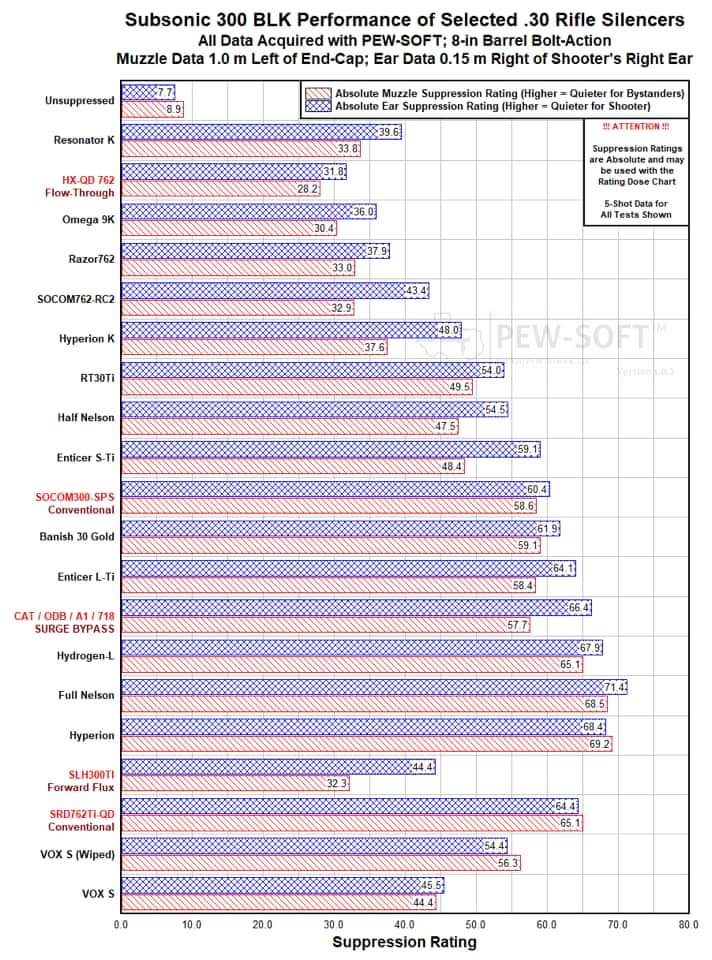

Pew science is your friend. I have the Enticer S that I shoot everything 30 cal and down thru. Awesome can. I don't see the Nomad on this list, but I'm pretty sure he has tested it.

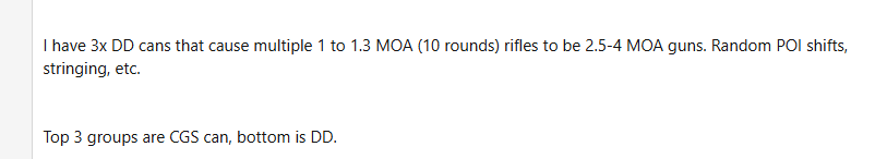

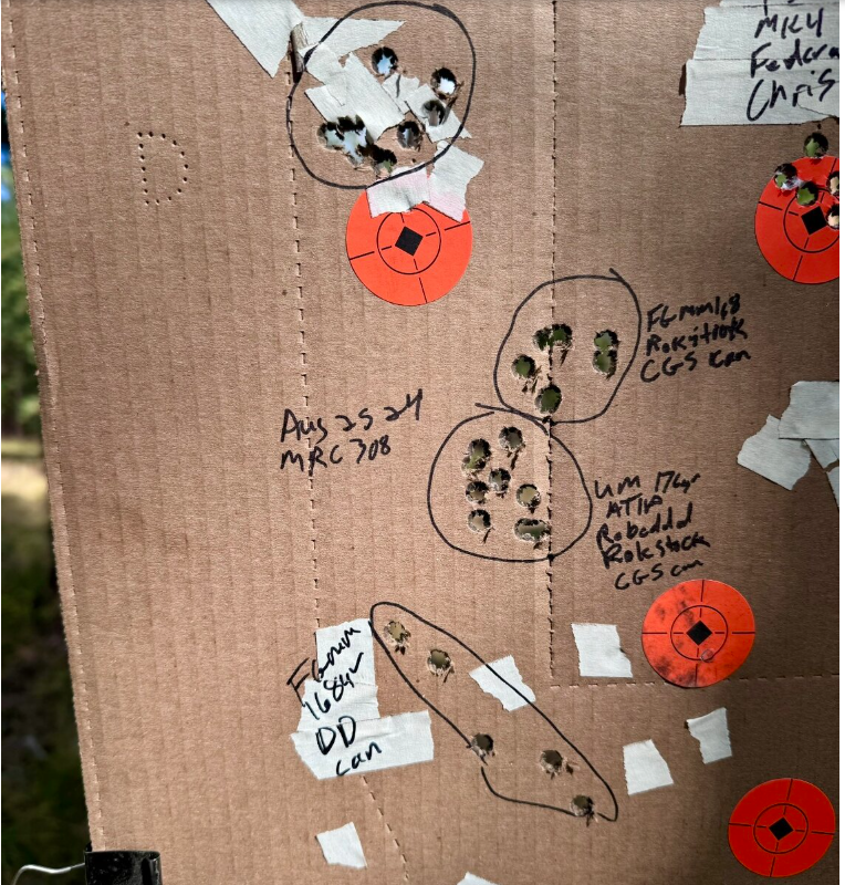

I’ve seen enough negative reports on enticers impacting accuracy and having issues that I wouldn’t go that route. Prior KGM manufactured nomads seemed to have a lot of failures but I haven’t heard the same with the printed XC versions.

Some that I recall linked below. Seen others, mostly on the same forum. Lots of people without issue as well.
Reactions: kthomas
Thanks for sharing.
I don't really see anything in there that suggests systemic issues, but not surprised to read some isolated reports of issues. Sounds like DD was on top of their CS in every case, which is always comforting.
Thanks for sharing.

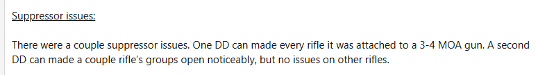

More from same forum:
Guy had DD "Straighten up" his can after it was having cold bore issues.
Reactions: kthomas
This is an interesting thread - not exactly confidence inspiring.
