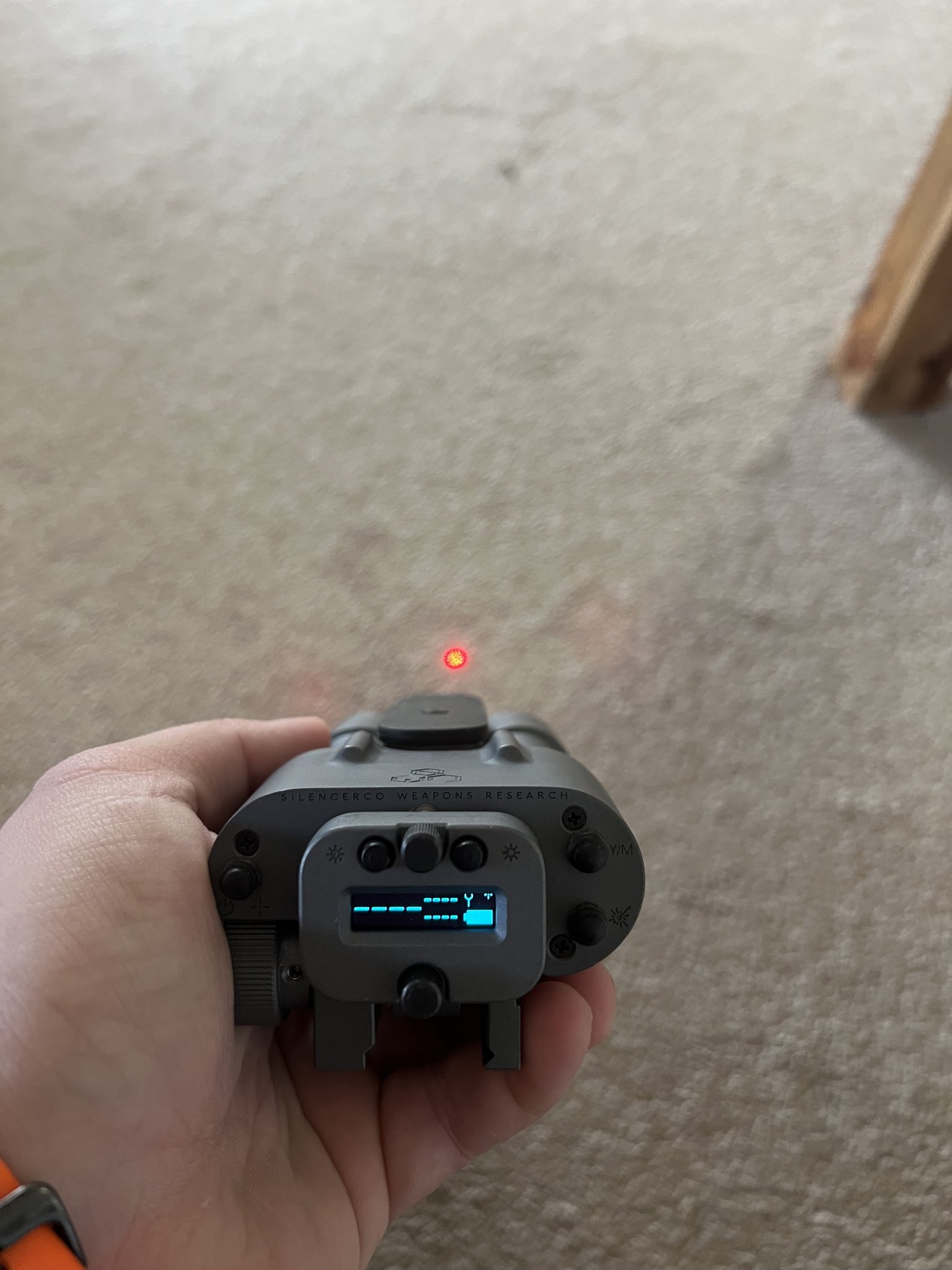

Here are a few pics. The first is the unit right after power up in Yards.

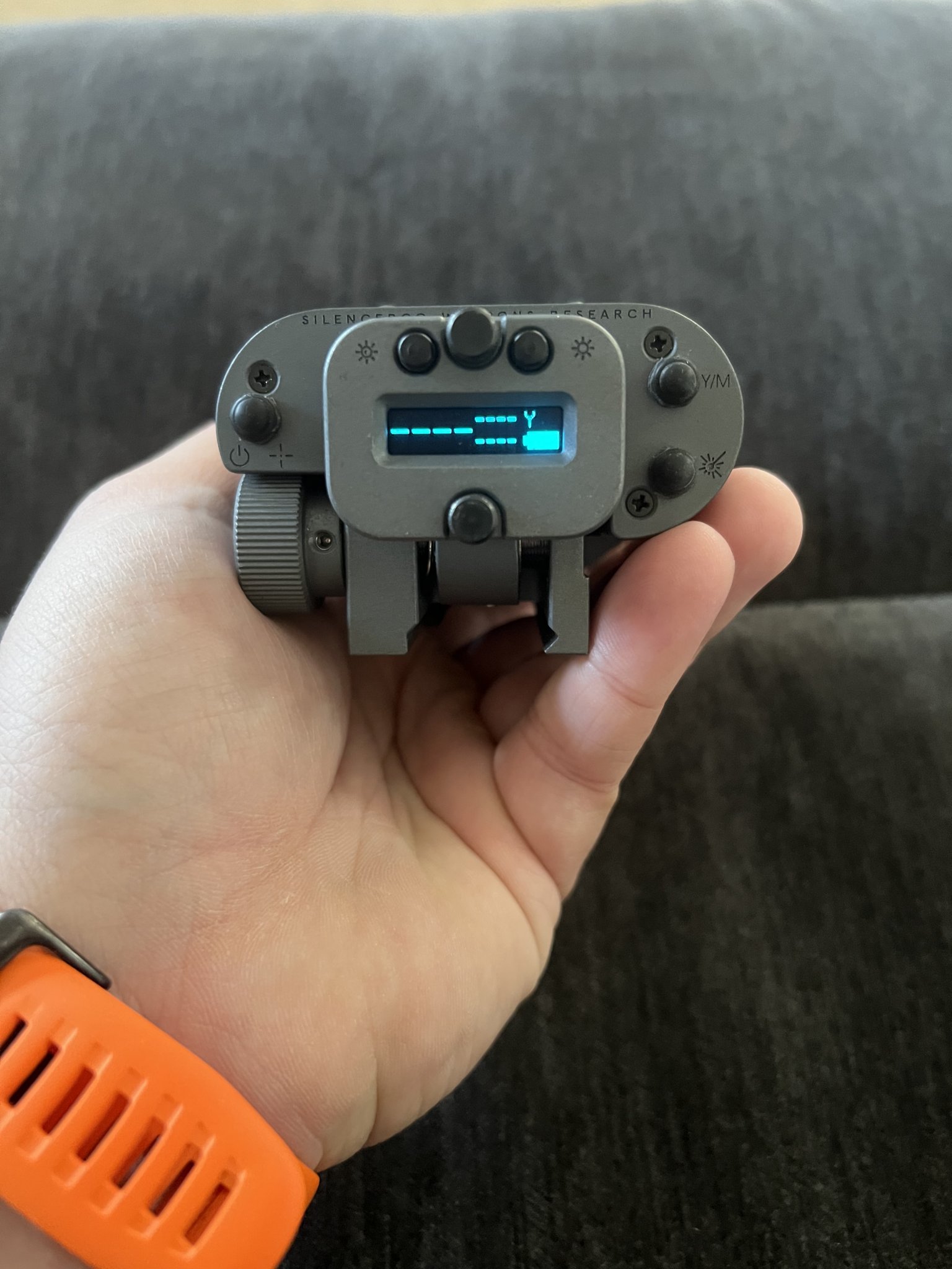

The Second is the unit after being powered up but before attempting to hit the “ranging” button. I put the visible laser on to show that the display does in fact work before lasing a target.

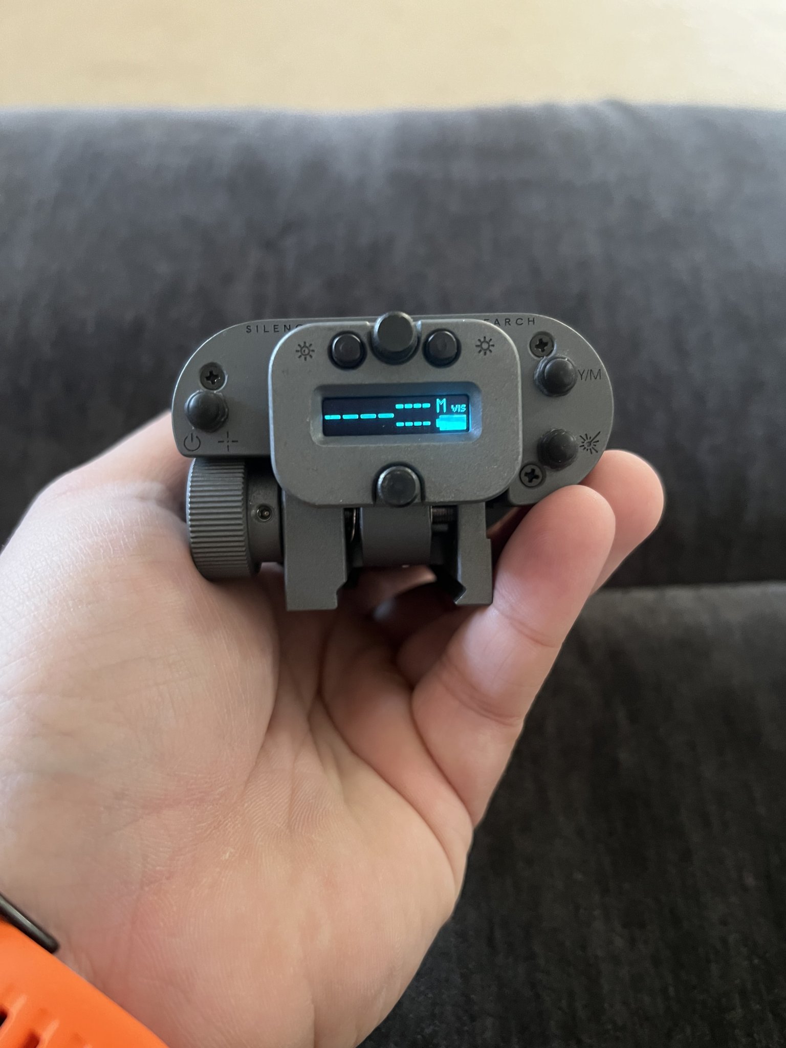

The third photo is the screen after reverting the settings back to yards and shutting off the visible laser. I then hit the ranging button and this is the screen that is displayed. The crosshairs icon stays on constantly and will not shut off after hitting the button, and no range is displayed.
The fourth photo is to show that once the “ranging” button is pressed the unit freezes and the display is locked with the crosshairs icon displayed. Furthermore, the visible laser will turn on and off, but the “vis” icon on the screen will not display when the radius is in its frozen state.
There is no damage to the outside of the unit and it was fully functional prior to being shipped.
