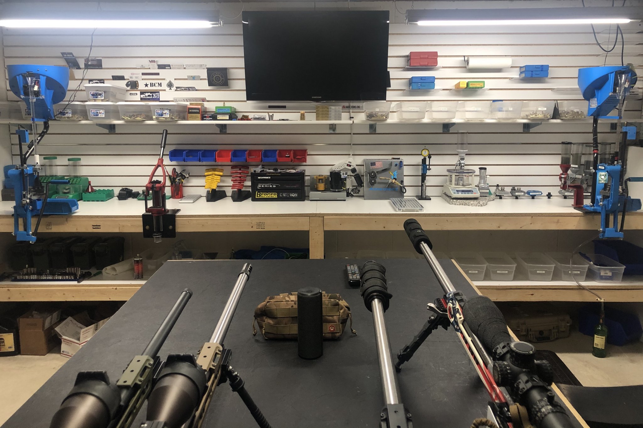

Wow, that is a beautiful set up... really well done! Did you replace the Dillon tool heads with “floating” heads (Whidden)? Regarding your arbor set up... did you go with the Wilson in-line die? Thanks for the feedback!
Thanks! Yes using floating Whidden tool heads and they seem to work well.
Yep, using a Wilson Micrometer top seater and I really like it a lot. Also, I’ve found the arbor seating process to actually be just as fast as the co-ax, which surprised me. The only thing I would do differently is getting the low force pack instead of the standard.
