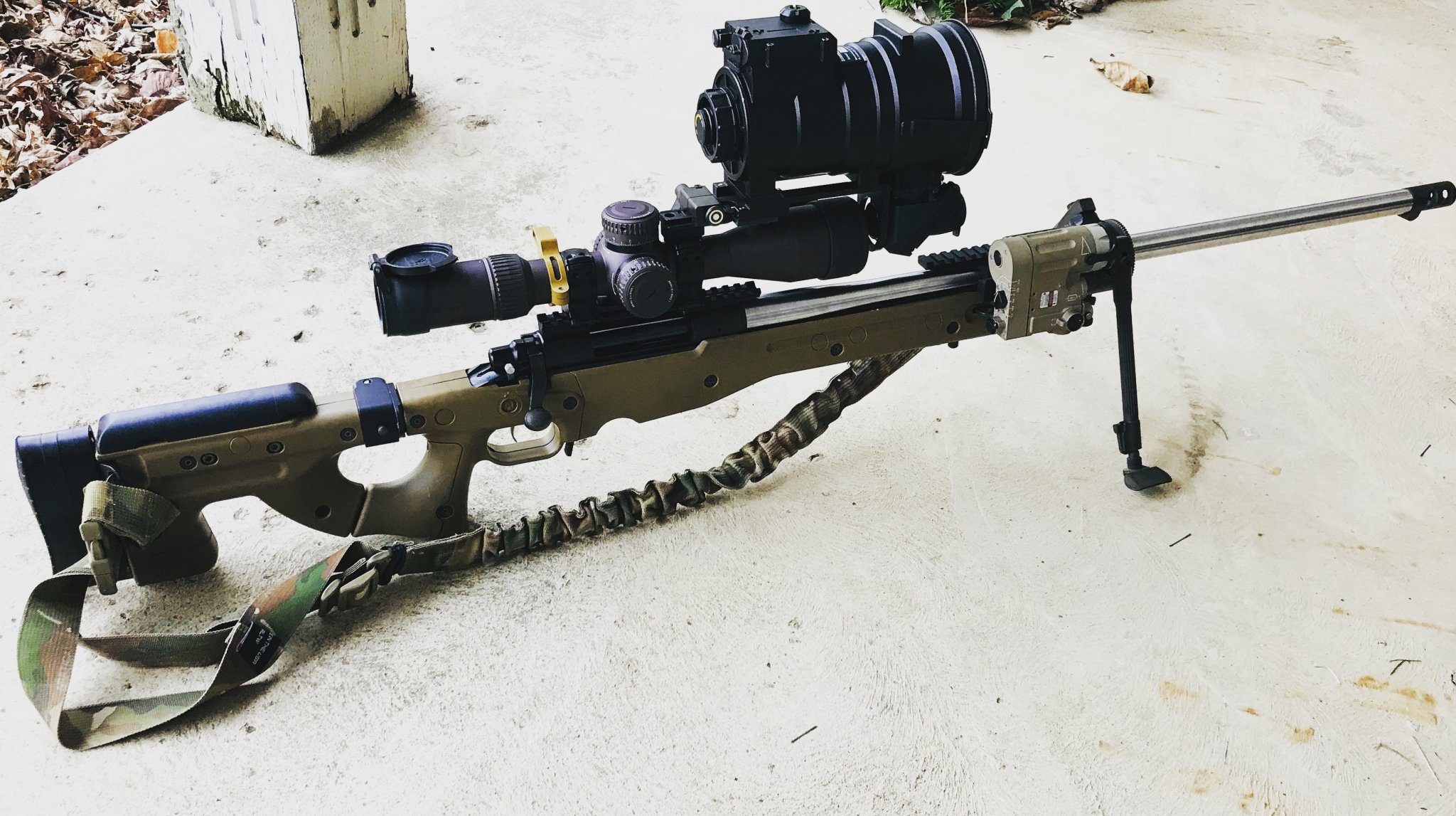

Looking for your preferred process to zero Simrad kn203.
also what is the offset/ shift of your scope zero to when the simrad is in use.
I’m loaning mine out to a friend to hunt and I won’t have a lot of time to show him how to use it.
thanks
I use two types of mounts.
spuhr with a simrad Mount
And
Badger simrad rings
per page 2-7 of the simrad manual, the kn203 POI should be 3.75 below the POA.
