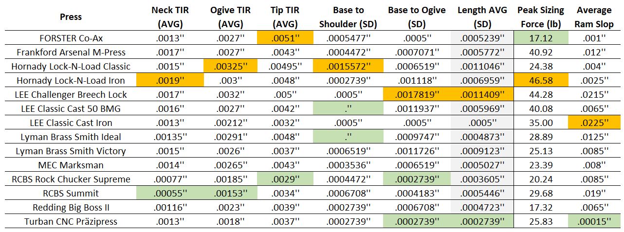

Ruebarb is right. Everyone is going to have an opinion. Here is mine LOL. The Lee Classic Cast Iron is pretty good single stage. I use it ONLY for my precision rounds.
The link he gave for the 14 press comparison is really a good one. I think the press, combined with excellent dies, and diligent case prep, produces very good ammo.
I think it's pretty much worthless for any other loading just because I don't want to spend the time making other ammo. I have a progressive press for that stuff. But my .308 ammo, I spend A LOT of time on that. Mostly careful and precise case/projo prep and selection.
Here is a picture of the case measurements from that 14 press comparison. Green being the best and yellow being the worst.
The Lee has the most ram slop, but for me, it hasn't been an issue down range.
7098841
Again, just my opinion, I think the Lee Classic Cast Iron does a pretty good job. Especially for the money! It works great for me and my long range shooting. For extended long range.. who knows. Maybe a different press would be better. I haven't made it to ELR yet.
I hope this helped. Also watch the 14 press comparison and read the resulting data.
