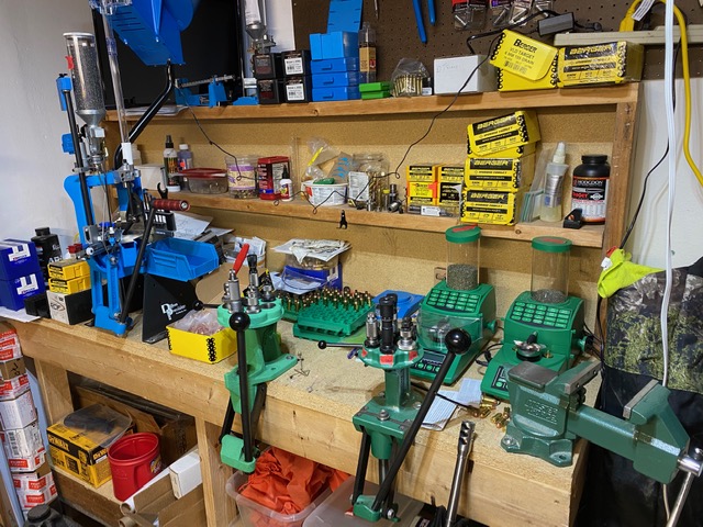

i've got the rcbs and right next to it T7. I've got my 6.5SS, 6.5 Creedmoor, 6 Dasher and 6 creedmoor set up on the t7 and rcbs. Like the fella said above, i like setting things up then not screwing with them. I also have the Boss on another bench to use for 338LM
