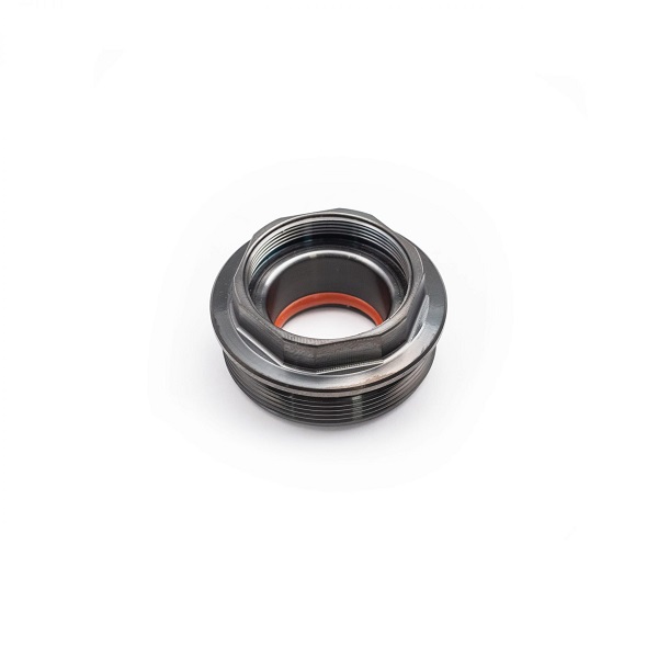

so you screw the adapter onto each rifle.
You have to buy an adapter that screws into your suppressor.
Now you can move the suppressor between rifles.. since they all have the area419 adapter installed. You can also add muzzle brakes and move them around the same way
Yup! Soemthing like this....
