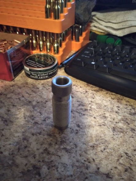

I reload a couple different 6.5mm cartridges. At the moment, I'm working on my tools for 6.5 Grendel which I use in a bolt-action rifle. I use Starline brass.
First of all, I full-length size the cases every time with a Redding body die. I have it adjusted to bump the shoulder a couple thou according to a Sinclair comparator tool.
To size the necks, my die set came with a Redding Type S bushing neck die. To get the correct size bushing, I measured a fired case and compared it to a loaded one, thus taking into consideration the thickness of the Starline brass.
Fired case OD: 0.300"
Loaded case OD: 0.288"
I started with a 0.290" bushing with no expanding button and the cases came out 0.288". Redding documentation indicates this will happen when sizing the necks down more than ten thou in a single step -- the neck will come out smaller than the bushing size. It's also indicated to cause issues with concentricity, but I have not measured that.
With an OD of 0.288", I had basically zero neck tension and my seated bullets would sometimes push into the cases with finger pressure. I bought another bushing, knowing the cases would come out of it smaller than specified. So I bought a 288 bushing. Sometimes the cases will come out of it at 286, but sometimes they will come out at 287 or 288.
I started annealing all my necks every time. Although I think it is good practice, it still does not resolve the inconsistency when sizing down more than 10 thou with a single neck bushing.
Previously, I had not been using the expanding button at all. When I bought the smaller bushing, I got the carbide button but did not use it. Even if I had it installed, it would not touch the brass. The original button and the carbide button are 0.262" and my Starline brass would have to have an OD of 285 for the button to touch the inside of the neck. It would need to have an OD of 284 for the button to actually move the brass a thou.
Apparently, I needed a still smaller bushing, maybe a 286, but I could not expect the results to be consistent unless I also bought a 292 to bring the size down in steps smaller than ten thou.
At the time, 286 was out of stock and I was frustrated, so I bought a Lee Collet Die instead and used it to smash the necks onto the mandrel and get a 286 OD, two-thou under a loaded cartridge.
It's been about a year now and I'm loading for this rifle again and looking to do it better as ever.
Should I get a Redding 292 and 286 bushing and bring it down from 300 in two steps?
Should I use the LCD to bring it down under 290 with light pressure on the collet, and then finish it with a Redding 286 bushing?
Should I get a Redding 285 or 284 bushing and then use the carbide button to pull the neck back to an OD of 286 but from the inside instead of outside?
Should I use a Redding 285 or 286 bushing or the LCD to smash the neck down and then open it with a Sinclair, Wilson or K+M mandrel to an OD of 287?
Considering that I am not turning the OD of the neck, should I be forming the outside (bushing) or the inside (mandrel or button) as the last step?
