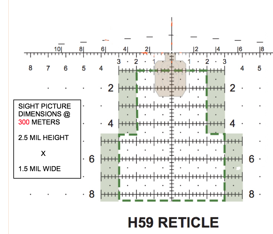

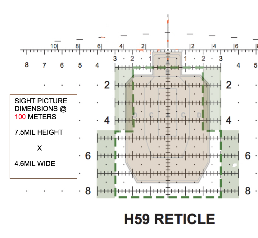

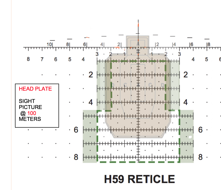

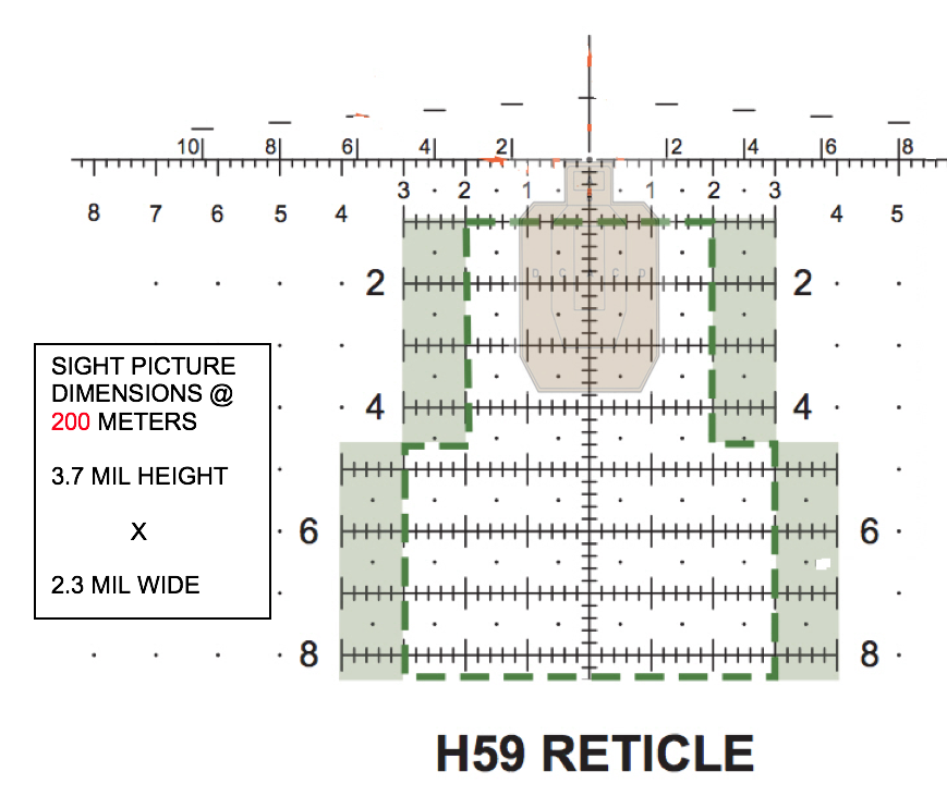

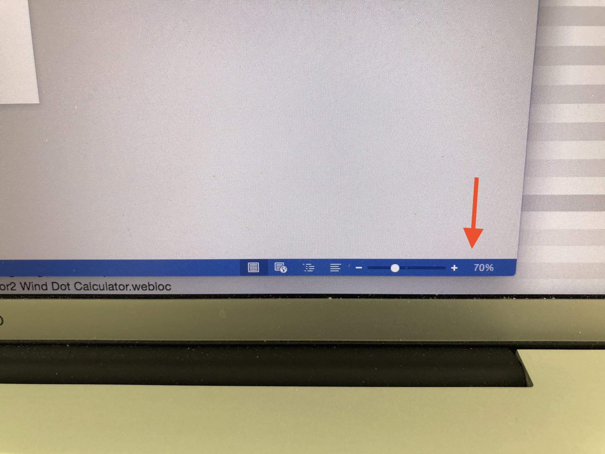

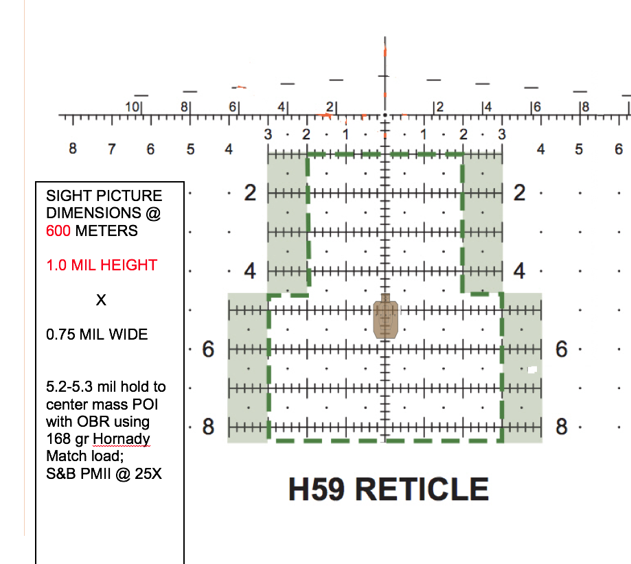

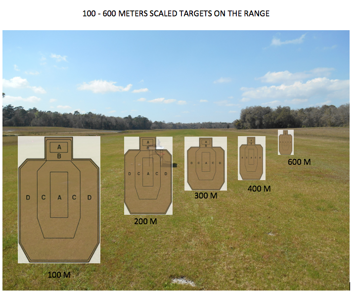

IF I want to train with the IOTA viewing IDPA target silhouettes with one of my Horus reticles, I scale the target sizes relative to each for various distances. The targets can be used side x side on a Word document laptop screen or superimposed on your favorite shooting range. The distance from the scope objective to the laptop screen is determined, in my case 11.5 feet works well; as mentioned, adjust the brightness of the screen if needed. I use the Word document screen size slider set to about 70%, this calibrates what I am viewing thru the IOTA at my 100 meter scaled target; then when transitioning from target to target on the computer screen they all remain in proper scaling as viewed thru the scope without any further adjustments as well as allowing you to practice rapidly changing the holdover at various ranges.
These are how the Word document laptop screens appear, adjustable for brightness and correct sizing.

You can overlay the properly scaled targets on to your favorite shooting range situation.
This is a photo embedded in a Word document with target images overlaying the photo; position them
anyway you want; could make partial exposed targets easily as well.
Use the Word document sizing scale to get the correct thru-the-scope reticle target sight picture @ your zeroing range; then scale the zero range target image to various ranges.
