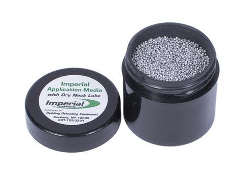

    Use this for neck and shoulders then lube pad for body and FL size.
