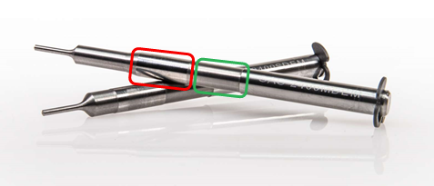

While this is the pic that they show of their mandrel for this die:
SAC calls it a “mandrel” but in reality it’s really just an improved expander-ball design, Mighty Armory does the same kind of thing with their dies…
Theoretically a FL die can’t really size and mandrel at the same time without the brass getting stuck, so they have to leave a few thou of play between the engagement of the walls of the die body and the engagement of the “mandrel” against the brass.
Those are diagrams of the modular sizing die. Imagine if the caliber specific decapping pin in your diagram had a section that was ground to a specific diameter, like a mandrel, in the middle of it.
That doesn’t make any sense. It doesn’t have to be any play or any thousands left anywhere. You just have to pull the brass down out of the neck bushing before you start running it over the mandrel.
Well, then the SAC die works exactly the same as an expander-ball, first the die body squashes the neck down before it’s then expanded as the “mandrel” is pulled through, pulling up on the shoulder on its way out (which is one of the things using a traditional mandrel avoids).

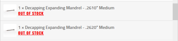

Ok, found this pic of mandrel/decapping die combo...and I'm still not sure if I understand. It appears that on the down stroke, it decaps and the bushing compresses neck diameter when the pin/mandrel has the narrow section in the neck (section in the green rectangle)....then on the upstroke, it pulls the mandrel section (red rectangle) through the neck thus opening it back up to the desired I.D.
So, how is this really other than an expander ball with an extended parallel section?
And I note, these decapping pin/mandrel are for the most part out of stock and only come in a couple of diameters per cartridge family?? E.g. image below.

Unlike an expander ball the entire length of the neck will be on their mandrel style expander at the same time. So I still think it's fair to call it a mandrel.
