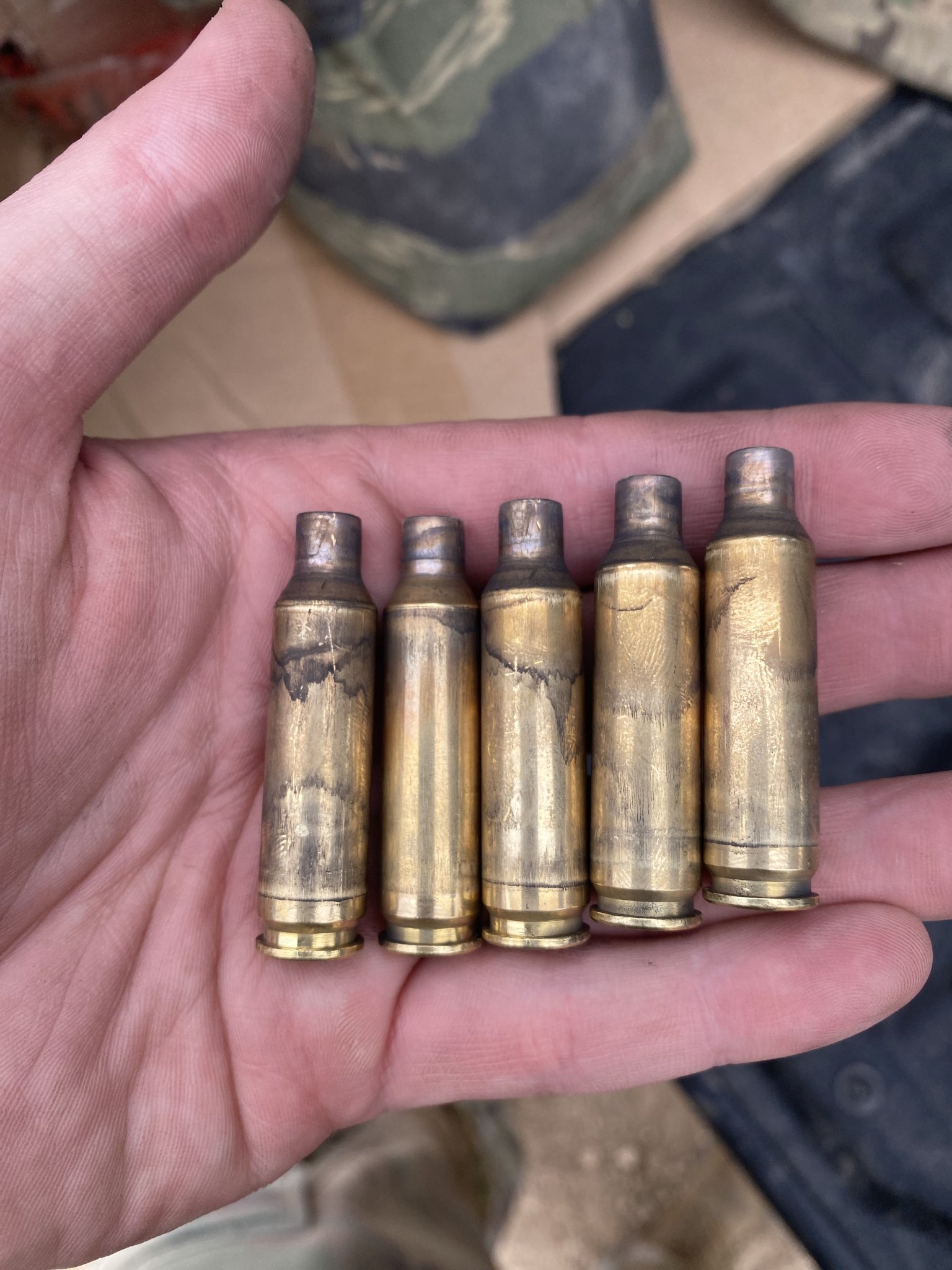

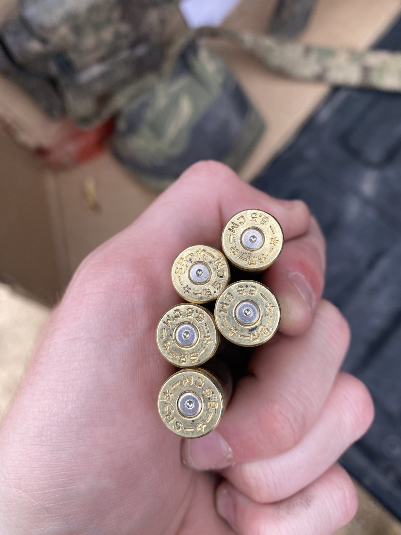

Having some issues loading for my 6.5 AR10. Loading ammo to 2.800 COAL, I have a criterion barrel that simply will not chamber All the way with my reloads. It used to fine but now it doesn’t. I suspect my die is not sizing the brass down enough, as factory ammunition chambered fine.
All the rounds fit in my delta 5 pro but they won’t chamber the last .10 inches of the case in my AR10. They get stuck to the point I have to actually pry the bolt back with something to get it unstuck if they don’t fire. If fired they extract fine. Also the brass looks scratched up tremendously.
I’m using hornady match grade 6.5 dies. I had not had this problem with my other 18 inch barrel from criterion, I even sent this barrel in to see if it maybe needed to be reamed out a little more and they said it was within tolerance. Headspaced, bedded it and gave me a free bolt. I ran 5 rounds through it after I returned from the range of standard hornady 140gr BTHP and it cycled fine working the charging handle which leads me to believe my dies aren’t sizing correctly. Anything else I can do to check? Magazines were fine and the COAL was good on all rounds IMG_8484.jpeg

This is what it looks like if I try to chamber a resized round. After I get the bolt back open the bullet is scratched up and the round looks like it has been sanded with rough sandpaper on the outside.

I suppose you could try using Dykem or a sharpie to see where the deficiency in sizing is, if you’re hesitant to fiddle with your sizing die.

The hornady bullets COAL is 2.800 for the 140gr BTHP. After measuring all the bullets the base of the case on the factory ammo is .464 and the fired and resized brass is .471 so I believe my theory about the case is why it’s getting hung up.
