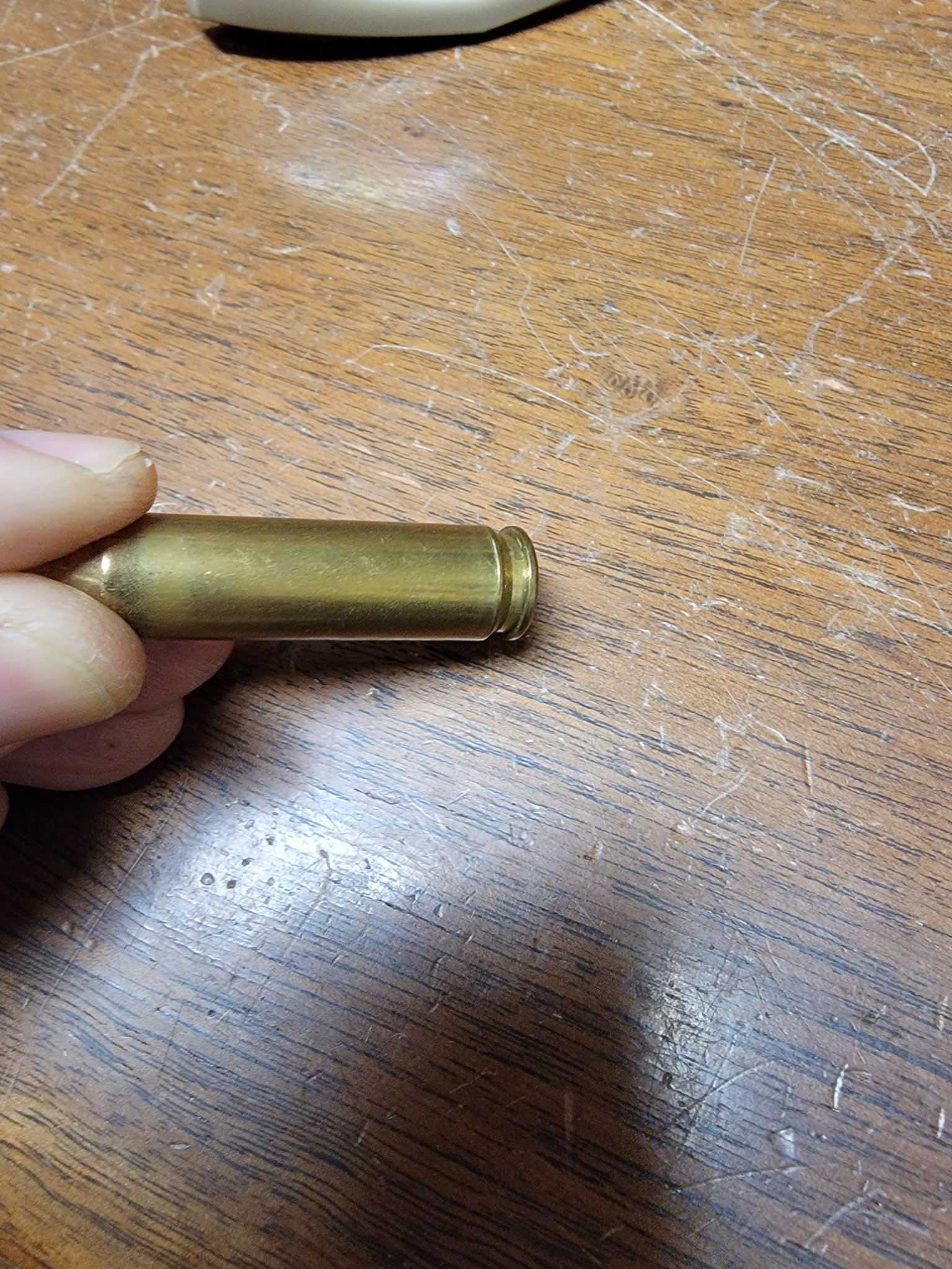

What’s the best method? Bushing die or expander mandrel? Have a regular Hornady die with expander button or a Redding type S.
These were not fired in my guns. May use some for bolt gun prairie dog rounds or in gas guns, just a bunch to have around. Most of it is in good shape, some dents here and there.

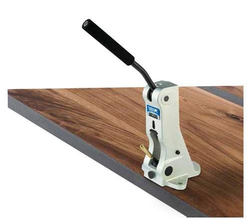

As long as you have a turret die, the whole thing is easy enough, just an extra handle pull. Collets or mardrels will fixed ding in neck. Collet basically has a mandrel inside it. Annealing and pin gauges are also good idea if you don't already do this. They all really go together. (y)

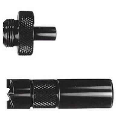

As for the .223/5.56 range pickups... I don't reload 5.56, although I do have the means and equipment to do so. I don't run a progressive press, so I don't feel like hand-cranking that shit for 1,000 rounds with multiple steps per round. So, every single piece of .223 and 5.56 NATO brass that I pickup or acquire gets cut down and reformed into .300 BLK.
And for all semi-auto (mainly .300 BLK & 6.5 Grendel) cartridges that I reload for, get FL resized every time. I only neck-size brass for my bolt-actions.

Tagging this for interest in the same question. I've got a lot of LC brass laying around. Can't make my mind up if I'm going to load 5.56 or cut it down for .300 BLK. I've been getting set up with mandrels but haven't used any of them yet.
Hey not to derail his thread, but since it came up, and it sounds like you're the perfect person to ask... I always wondered about premature case head separation on brass fired out of a machine gun. Seems like with the looser chambers, you'd get a lot of stretch around the web and pretty short brass life, is that not the case?
I can add a little insight to this question. I bought 500 once fired LC 7.62x51 years ago. The headstamp was 91. Some of this brass was stupid hard to fl resize. I got it sized, but due to my inexperience at the time, I did not segregate the hard to size brass from the normal brass. Needless to say, quite a few cases had partial head separation upon the second firing. None came completely apart, but I don't keep any 7.62 cases of mine that have a 91 hs. I'll keep a few just to use toset up the annealer, otherwise I crush the necks and toss them in the junk brass bucket.
If it's legit mg brass, proceed with caution, and separate the normal sized stuff from the blown out cases.
Reactions: SERE8541 and J. W.
Interesting. The bulk of this brass was bought from here. Seems to be in decent shape. I don’t have a brass gauge. FL size then just see if it chambers? Or do I need some sort of gauge and check it all?
I mean, Hornady .308 case gauges are like $20…And will last indefinitely. Worth the investment if you have large amounts of random pickup brass to ensure its sizing down to spec to become fire-formed in your chambers.
But, if you want to do it the old school redneck method (which I still do most of the time, because I only have case gauges for semi-auto cartridges), FL sizing, then seeing if the empty brass will chamber works to give you a baseline whether your die is sizing them back down enough, or if you are going to need a “small-base” FL sizing die.
5.56. Most of it seems to have four notches as crimps verses a circle around the whole primer pocket.
You’ll need an RCBS Primer Crimp Removal Tool for that. Small size for 5.56, large size for 7.62. Get yourself a drill adapter for it and thank me later. Midway sells all of that.
Small
https://www.midwayusa.com/product/1012921650?pid=254170
Large
Handle
https://www.midwayusa.com/product/101293377?pid=477820
Drill adapter…

At 50 per thousand, you are over halfway to to a Frakford Arsenal swagger. Its a lot easier than cutting them when you are doing them by the thousands. I know I see people say they can cut them faster, and they can clean cases faster with steel wool and drill than tumbling. I feel like those might be people who don't do a lot of volume, or maybe their fingers look like this. :ROFLMAO: :ROFLMAO: :ROFLMAO:
^^^^^^Dude probably had one of these Lee Trimmers. 😳:ROFLMAO::ROFLMAO:
I swaged a couple two gallon buckets with my Frankfort Arsenal swagger. No finger pain.
Small
Large
Handle
Drill adapter…
I like this one
Reactions: NH4X and FuhQ
I did buy the RCBS one. It worked okay. Used both that and a standard reamer, between the two it went okay but fingers still needed a break every 200 or so.
