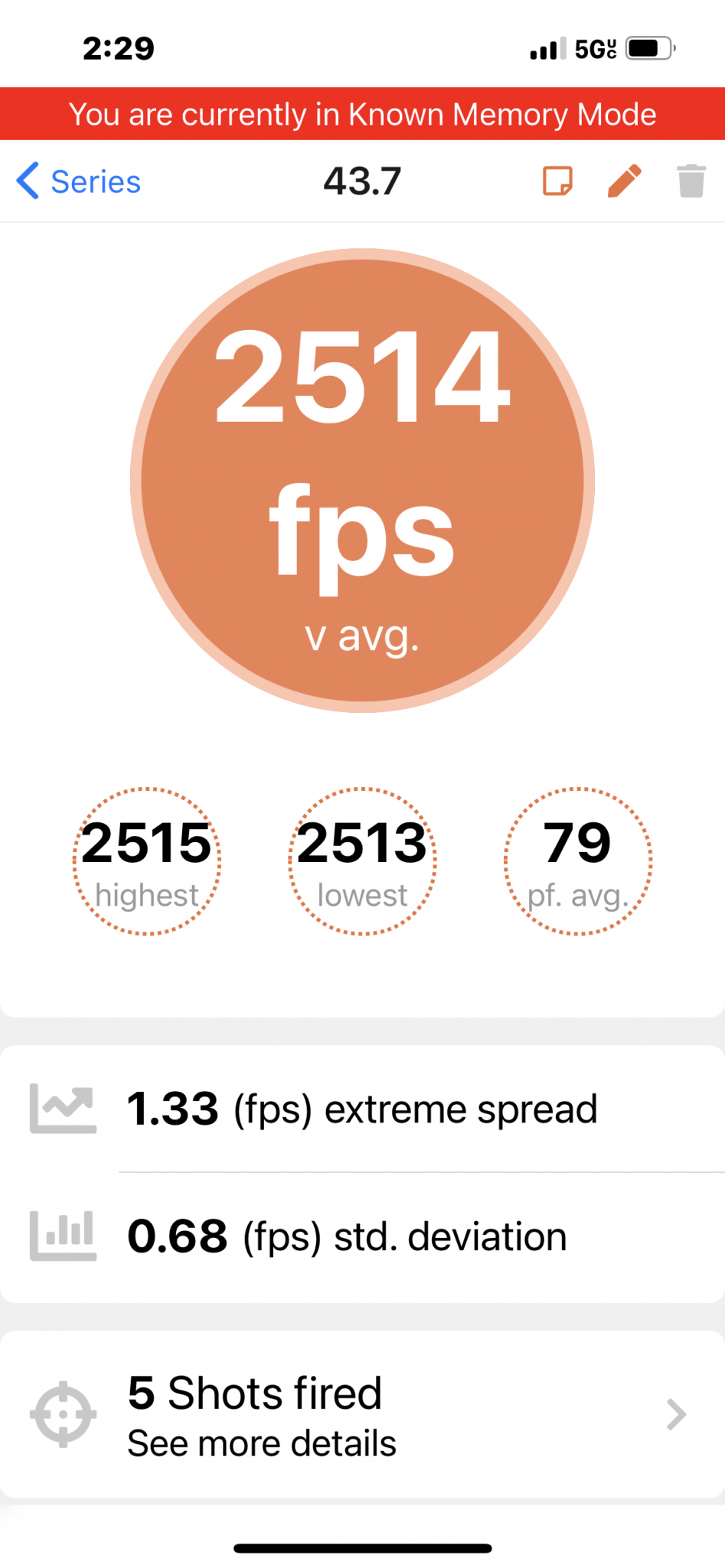

Today I tested 50 rds with hornady virgin brass
I got some shocking results lol
43.7 Varget
Hornady virgin brass
168gr ELDM
