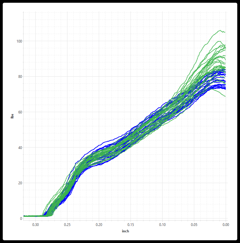

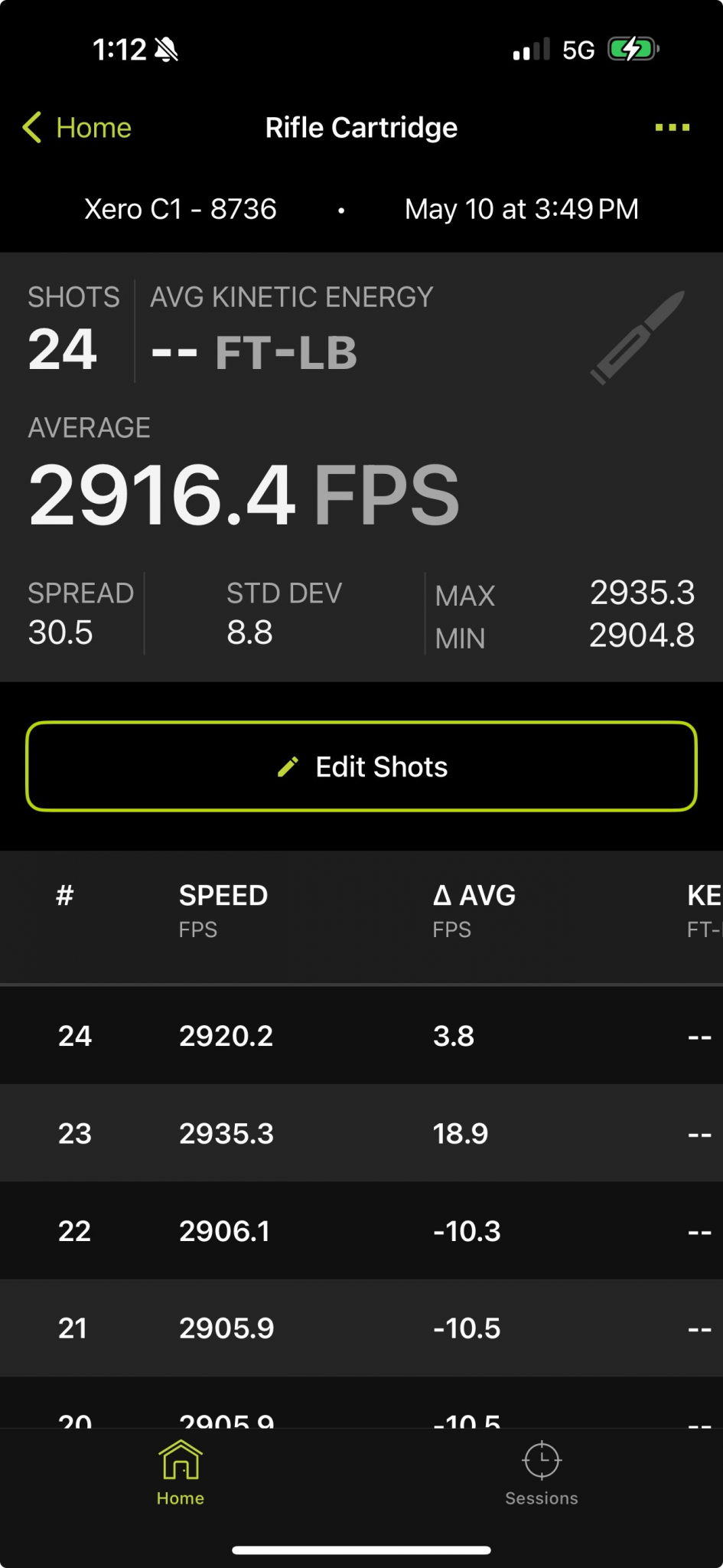

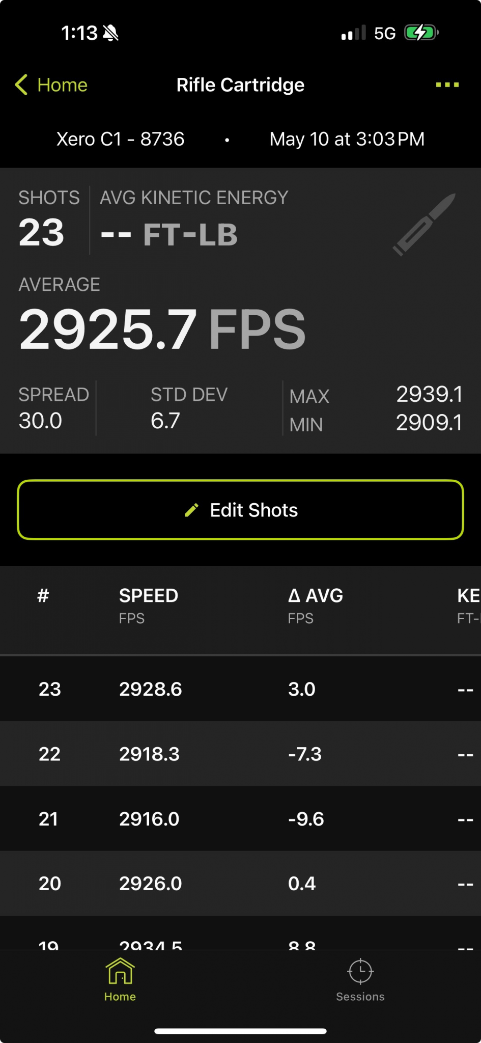

By the way, I had mentioned to you that I was going to a private range last week to run another test of lubed necks vs. not. Unfortunately, I got only half the data I was looking for (SD impact of lube vs not) because the bench I was shooting off of was wobbly and my groups were all over the place. Before you ask, I really didn't want to shoot prone because it was in the 90s and there was nowhere to shoot prone in the shade. I'm going out again next week to try again... with a sun shade this time.
On the SD side, I had the most pronounced difference between lubed-neck SDs and non-lubed-neck SDs:
Non-lubed:
Lubed:
Here are the AMP Press plots for these (blue=lubed, green=non)
Non-lubed:
Lubed:

It sure seems like you are on to something with lubing necks. I appreciate you sharing all your info on this.
Maybe the lube has something to do with the neck tension of the seated bullet? If that is the case, I would also test the dry with less neck tension scenario.
All of this plays into what I call "Effective Neck Tension", which is a combination of all the forces in play that conspire to keep the bullet in the neck during ignition. Lube lowers that effective neck tension - or looking at another way, not using lube raises it. The main thing, however, is that lube makes it more consistent.
Lowering interference fit (I won't call it neck tension :) ) will lower the magnitude of the variation of the force holding the bullet in place, but they will still be there.
That's cool. I just can't help wondering if a .002 larger bushing would have a similar effect on SD.
