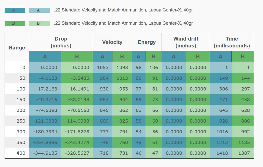

Has anyone had access to SK factory spec numbers on what is acceptable for ES,SD numbers?
Reason for asking is if Red rifle match,Long rifle match and hv match are “match Ammo” why are velocity so different within their respective unit.
example: shooting sk red I have sd of 7ish long range 5ish and hv 15ish
why SK hv “match“is not in single digits velocities are all over the place?
If they can get Long range velocity very close why not hv seems like proper powder,bullet and case the velocity should be the same in theory.

At 50 yards an ES of 40 fps produces about 0.25 inch of vertical spread.
That's about half moa before factoring in wind and shooter skill.
At 100 yards that same 40 fps ES produces an inch of vertical, at 200 yards it's 4 inches.
