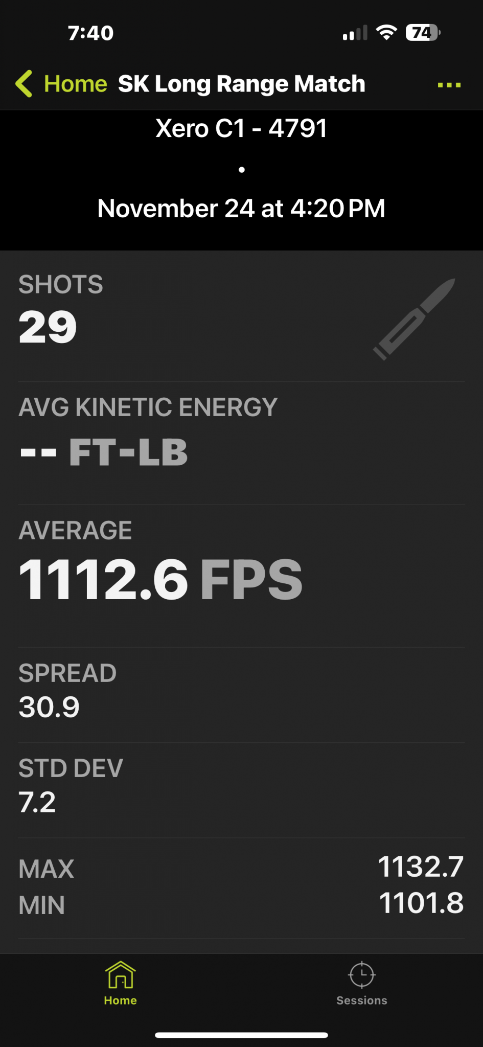

Here is my chronograph data. I have been using Center X but this seems to shoot just as well. Is this consistent enough for PRS type shooting? Thoughts?

It is a decent ammo for the price. And a good practice ammo. Out of 6 different Lots that I tested in my Vudoo - 1 shot very well, 1 shot just OK, 3 of the Lots would not be useable in a match situation and will be used for practice ammo only and 1 Lot was complete garbage. The testing was done at various ranges out to 330 yards.
I will not use it for match ammo in my Vudoo once these Lots are used up. There are better ammos out there for that.
