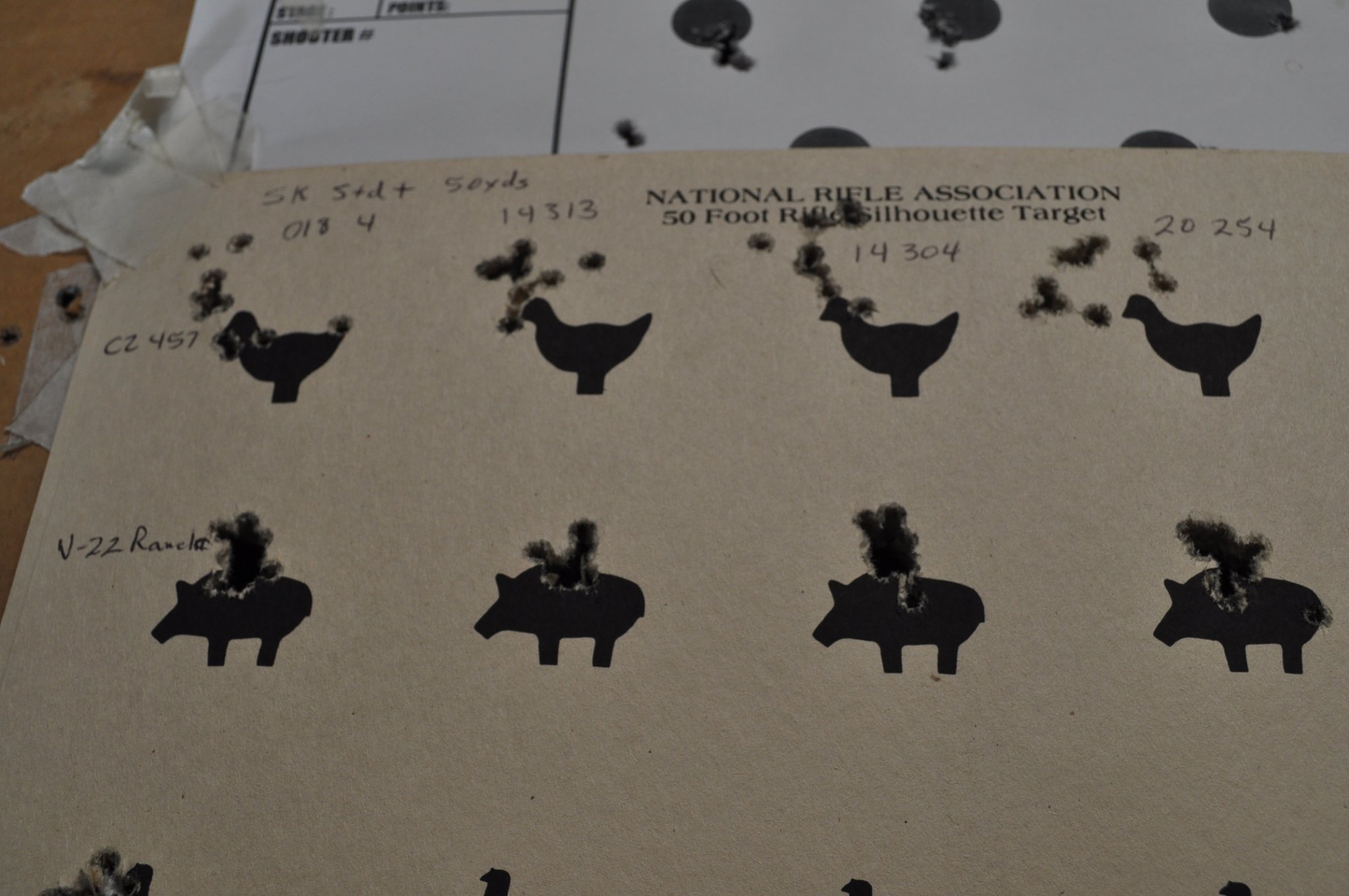

I got in three lots of SK Std+ for testing a couple of weeks ago, and had to wait until last Friday to get decent enough conditions to do any shooting at all with them. Shot 10rd strings of each lot at 50yds off a portable bench with a big & heavy V-top bag, using a fairly new CZ457 American, then followed that up by shooting 10rd strings of the same lots in the same order through my little light weight Vudoo V-22 Ranch. The CZ was pretty loosey-goosey with all four of the lots (I had a few bricks left of a lot I got from Grafs about 1-1/2yrs ago) I was shooting, but the little V-22 was putting most of the 10rds of each lot into one big ragged hole. After looking at those eight groups, I decided one of the three new lots was better than any of the others, and ordered a case of it. I've shot a couple of 10rd strings of this lot of Std+ through that V-22 Ranch that had no fliers outside the main group - the first time I've ever gotten those results with Std+. Before this, there were always one or two shots in every 5 or 10 shot string that would land well out of whatever group had formed. FedEx was scheduled to deliver that case today, but never showed - suppose they had the van clear full of stuff on a Monday, and so I'll have to hang around most of tomorrow to sign for the ammo when it does arrive. But anyway, I've seen an occasional lot of SK Std+ that's pretty darned good in the past, and I'd like to believe that this lot will turn out to be one of those exceptional lots. I know none of these are 'bragging' groups, but felt I needed to post the photo to give an idea of what I'm talking about. I bought a case of lot# 14313, the 2nd from the left in the photo. Hope it turns out to be good enough to at least practice with...

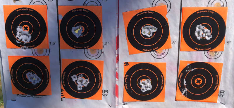

Some targets yesterday for your consideration. These are all from my 10/22 build:
Targets are at fifty yards, 10-round groups, winds 1.2-8.5 MPH when measured over a 30 second period. Starting at the top left moving right:
  1. SK Standard Plus
  2. SK Rifle Match
  3. SK Flatnose Match
  4. SK Pistol Match
  5. SK Pistol Match Special
  6. Lapua Center-X
  7. Wolf Match Extra
7045484
I was pretty pleased with the SK Rifle Match. Of course this is only 10 rounds of each. Considerably more testing is required.

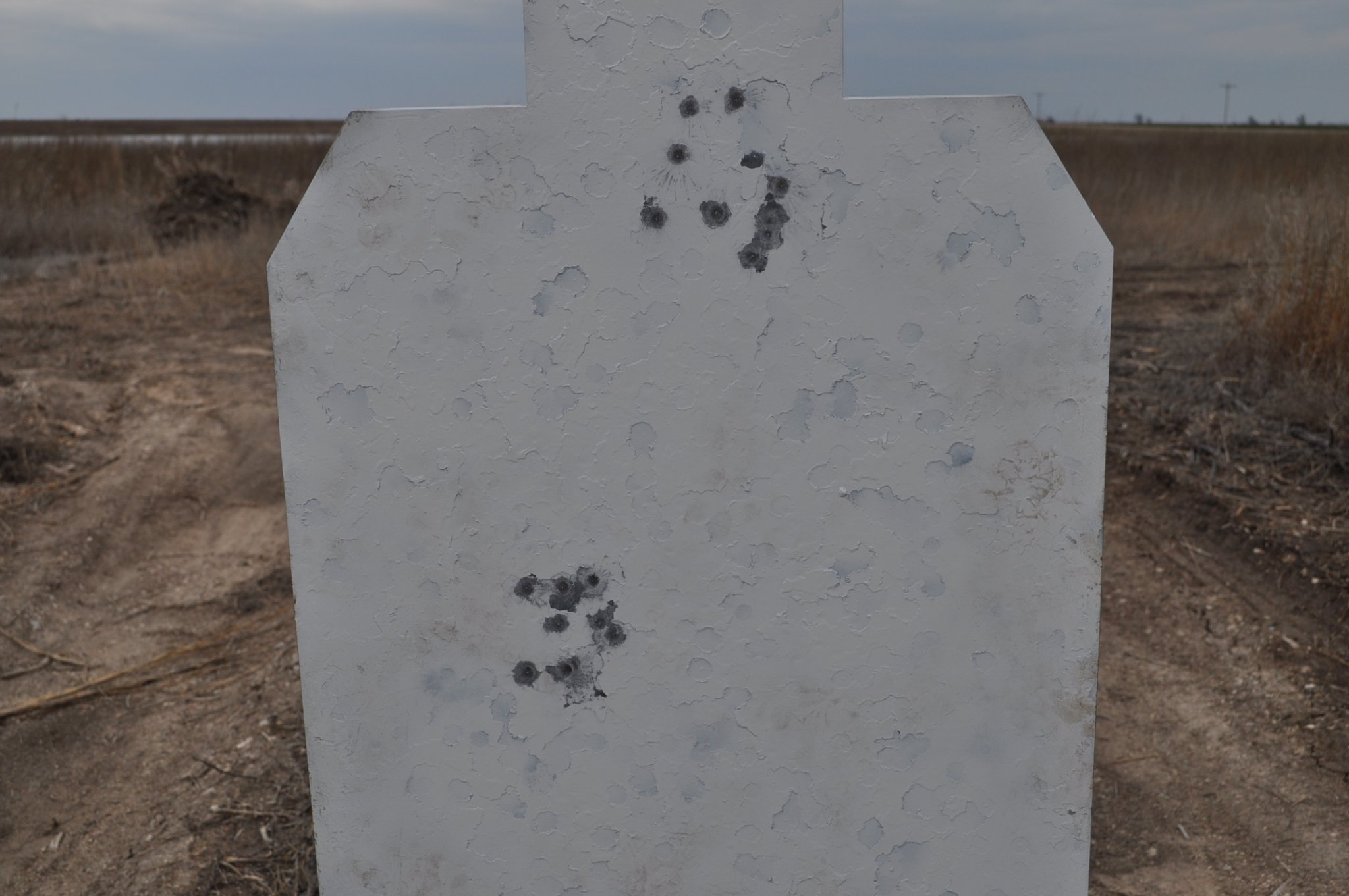

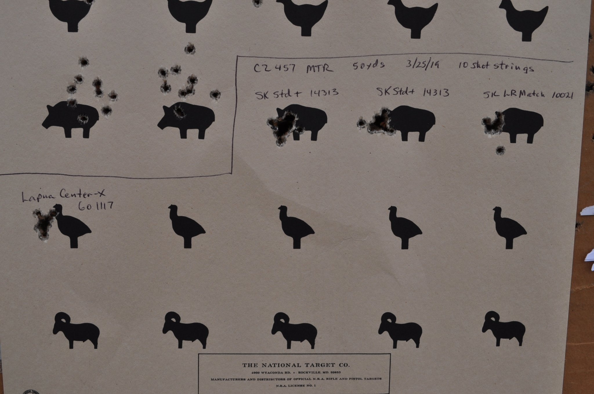

A couple of days ago, I had a new CZ457 Varmint MTR out shooting w/bipod & rear bag off a portable bench at 210yds over the chronograph. I'd already run 50rds through it with a new lot of Std+, LR Match, & Lapua Center-X at 50yds, then moved a steel IPSC target back to 210yds. Shot two 10-shot groups, first with SK LR Match, followed by 10 of Lapua Center-X (the same lot# that Dan Cliff & I decided was the one to go with after his testing of one of my V-22s out at Mesa). 1st photo is of the 50yd groups, 2nd photo is the IPSC at 210yds, with the upper group being SK LR Match (just over 3"), lower one Lapua Center-X (just over 2.5"). You can bet I'll be shooting more of that lot of CX through the MTR as time goes on - need to see how consistent it is with that ammo.
