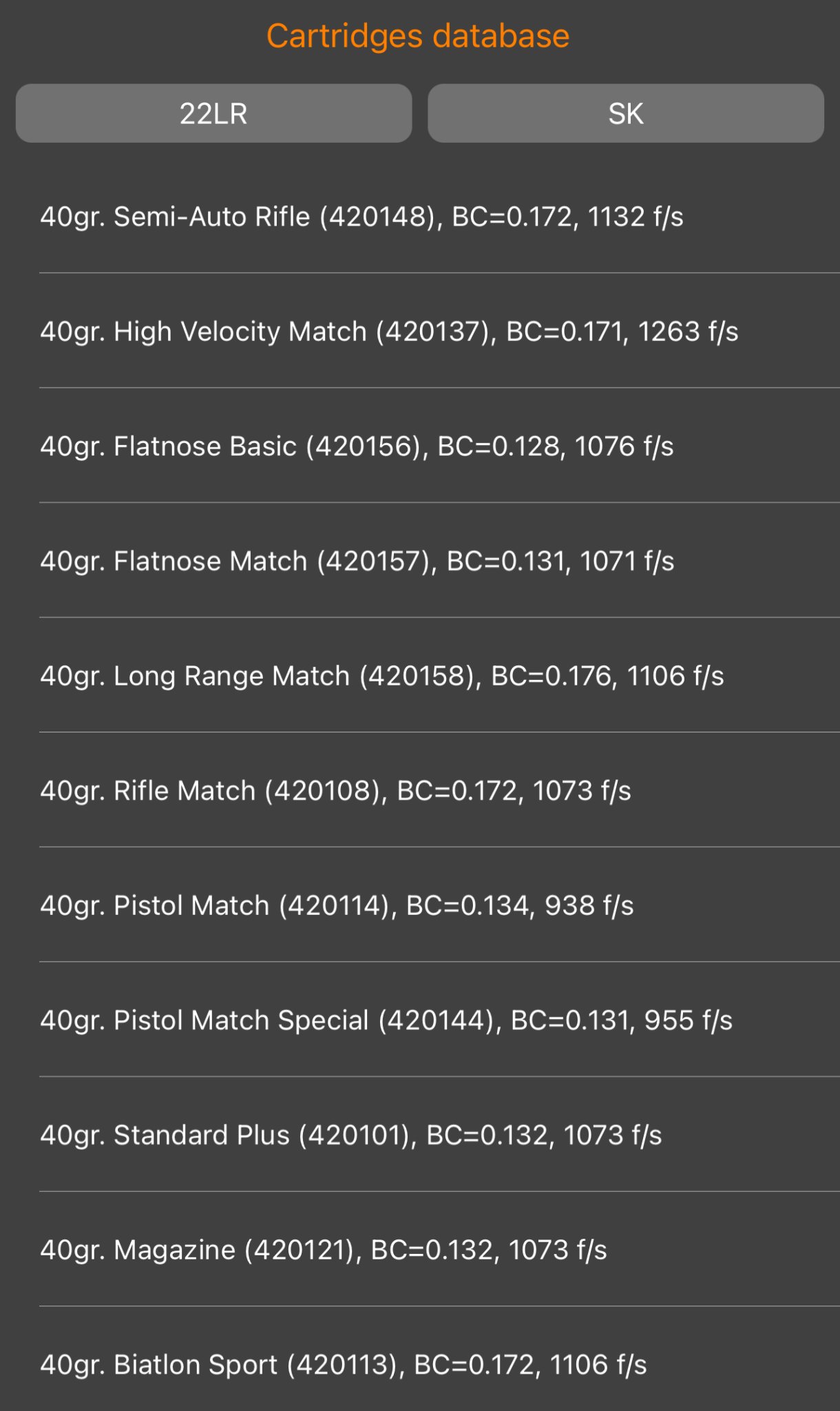

T Tommy38 Private Minuteman Nov 20, 2020 12 6 United States Jul 4, 2024 #1 Jul 4, 2024 #1 Checking if anybody knows the BC for SK standard plus 40 gr?
G grauhanen Private Full Member Minuteman Jul 31, 2014 549 482 Jul 4, 2024 #2 Jul 4, 2024 #2 For what it's worth, SK publishes a G1 BC value of 0.172 for all it's standard .22LR bullets. But that number won't tell you where they will end up.

6 6.5SH Two Star General Full Member Minuteman Jul 24, 2020 6,415 11,501 Jul 4, 2024 #3 Jul 4, 2024 #3 SK publishes a G1 of .172 @ 75 yards. AB mobile lists a G1 of .122 My own measurements via LabRadar was G1 .132 to 100 yards out of my rifle. You will find everything in between if you look at the various PDM's in AB. Reactions: camocorvette
Rob01 Moderator Staff member Moderator Full Member Minuteman Jul 9, 2001 17,809 14,870 NC Jul 4, 2024 #4 Jul 4, 2024 #4 Usually falls in the .130-.150 area. Test it out and see where it is for you.
021411 hot loads B==D - - - Full Member Minuteman Dec 14, 2011 1,919 2,077 Houston, TX Jul 4, 2024 #5 Jul 4, 2024 #5 Strelok shows 0.132 with the SK Standard Plus.
Emerson0311 Old Salt Full Member Minuteman Feb 17, 2018 3,443 6,480 Dawson Creek BC Jul 4, 2024 #6 Jul 4, 2024 #6 I did well trueing the BC at distance with Strelok and SK ammo. The AB custom curves in the Kestrel kick ass. I’m not sure, but you can probably get them with just the app too.
