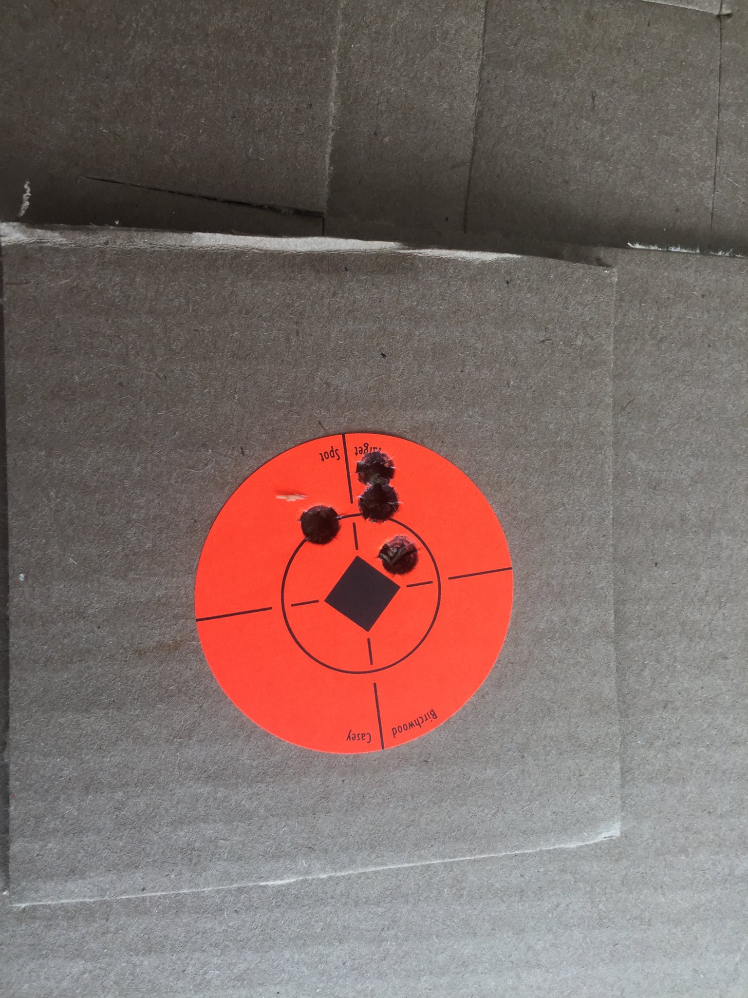

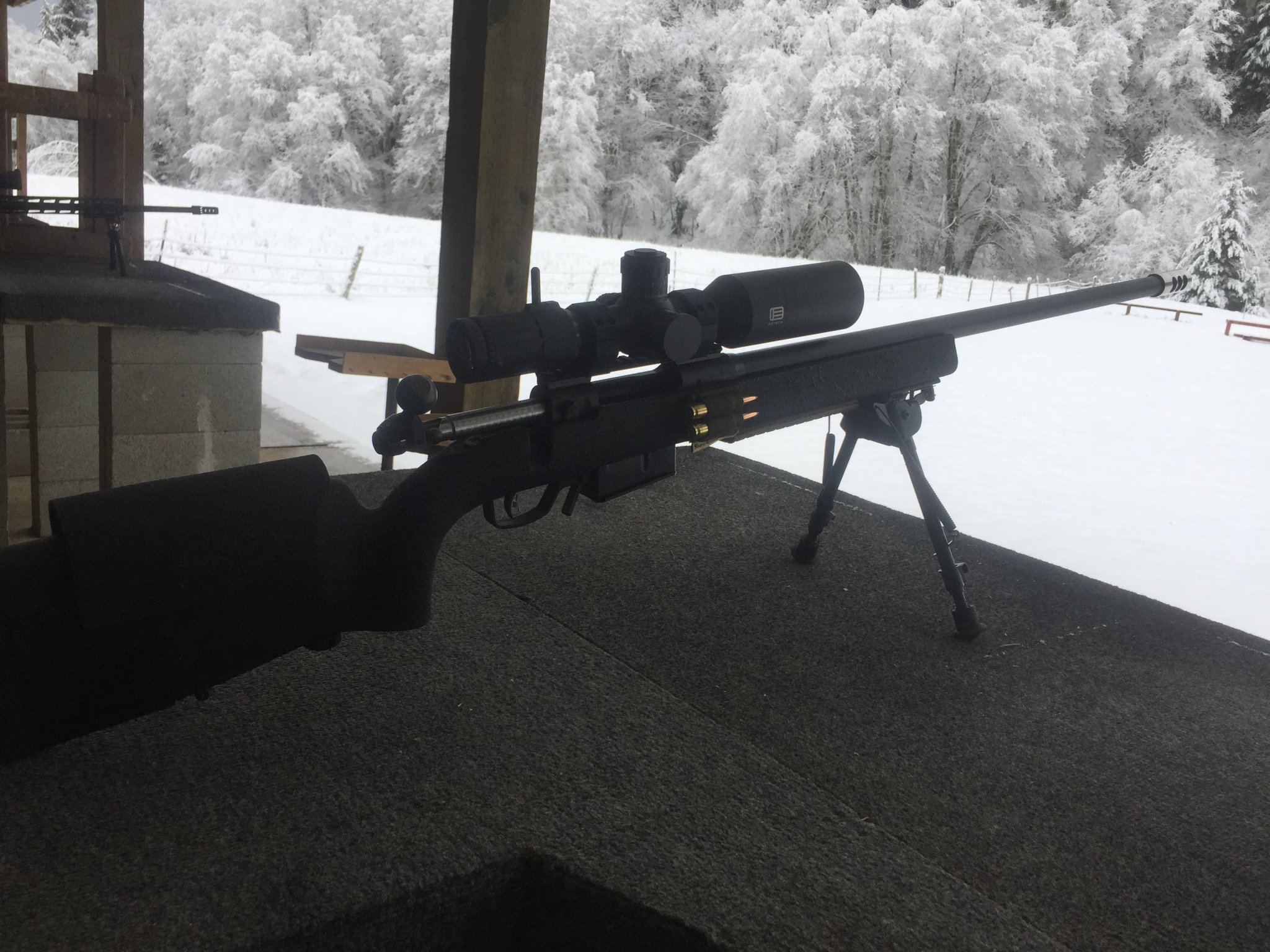

Alright bedded the recoil lug and my new rail got new scope on and everything to proper torque spec going out tomorrow to see how she shoots and snap some gun porn for you helpful folks
Thanks to all for their advice I put up a picture of my rifle all done up and ready I shot some groups and accuracy has definitely improved and my flyer issue doesn't seem to exist anymore the picture of the group in the previous post is five shots and the group measures out at 0.486 inches needless to say I'm more than happy with That from a factory action and barrel
