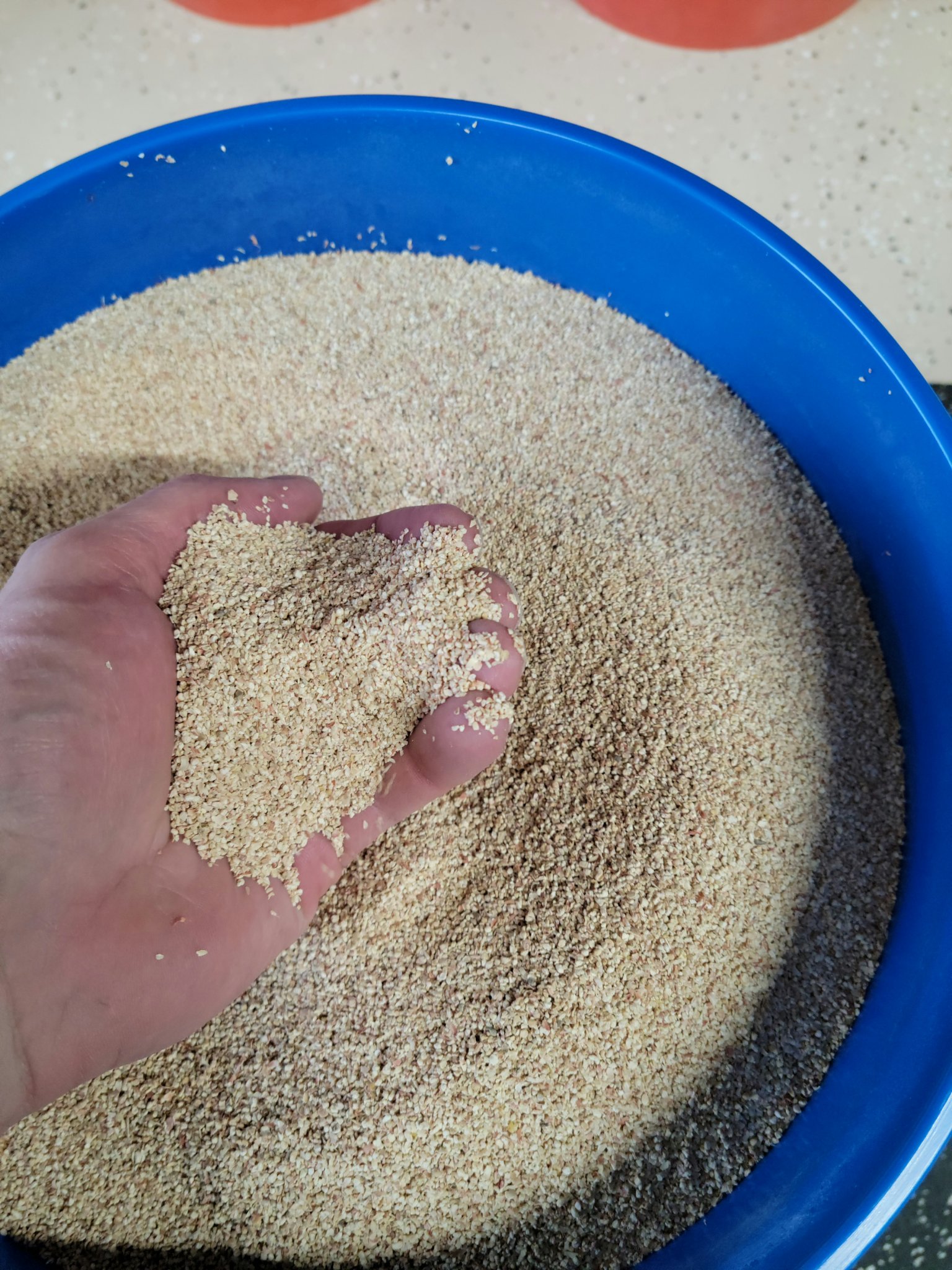

Tumbling off lube with 20-40 grit corn cob is the jam, it flows through flash-holes like water when you're done. It's much finer than the usual corn cob stuff most are familiar with and is worth spending a couple of bucks on just based on how easy it makes things.

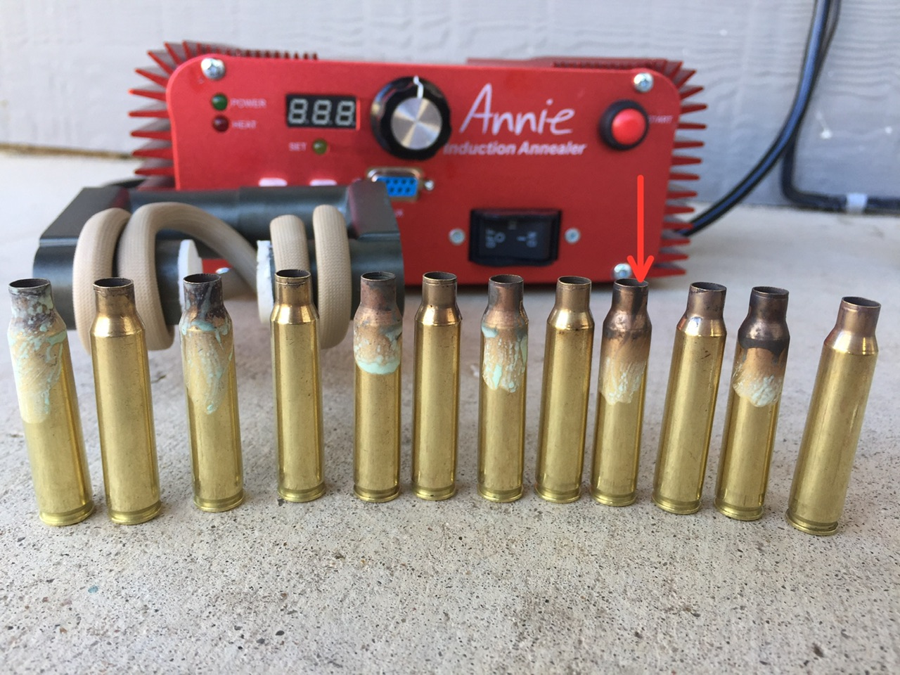

I anneal until the 750 tempilaq turns just below the shoulder. Thats what leads to consistent bumps and not just neck sizing. Even then I don’t get heat migration issues.
