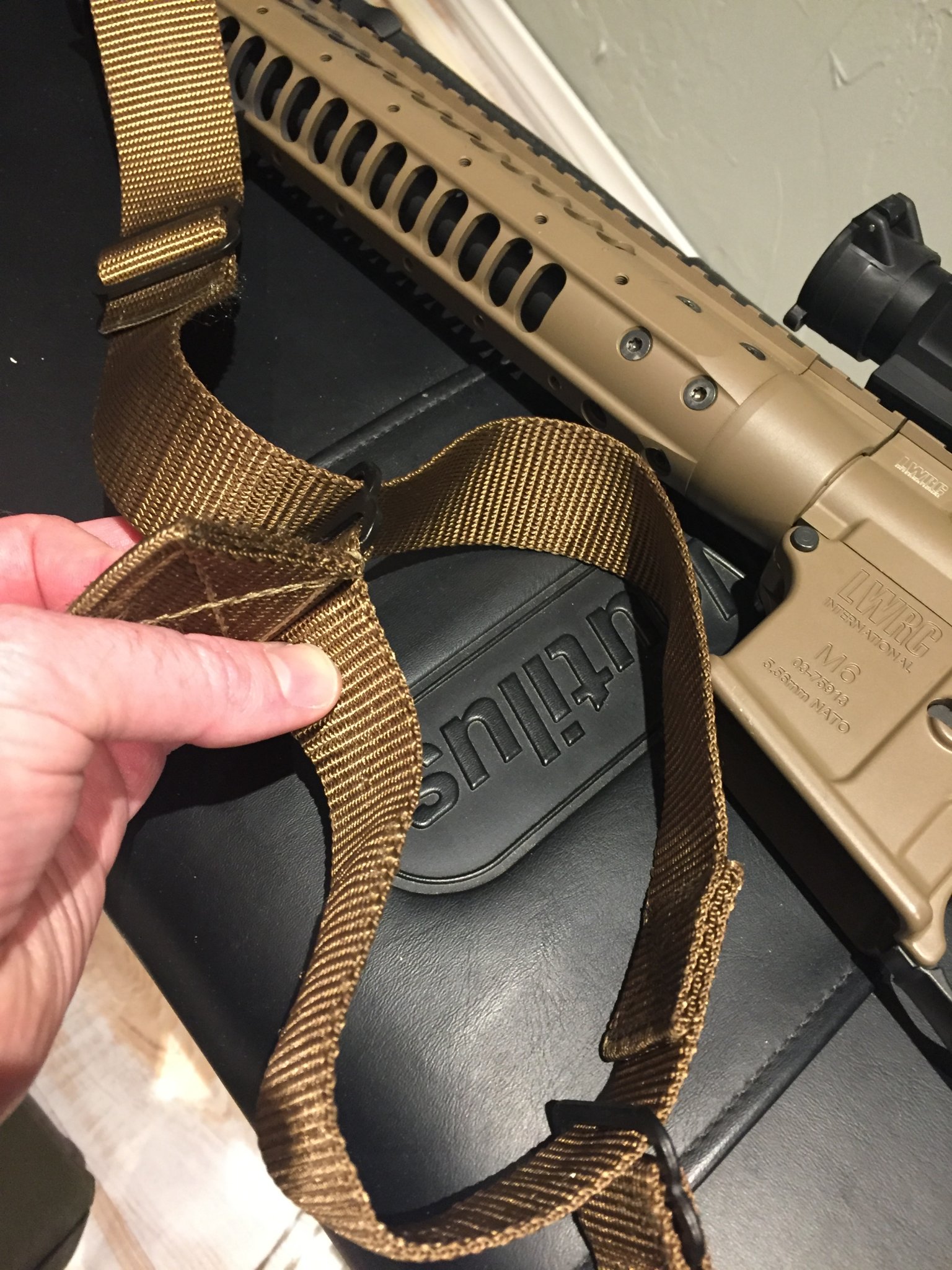

Answer: the loop opens up with a tab and you can put your support arm in pretty easily with one hand. The idea, if using that loop, is that it slips tight around your arm just above the elbow. Easy enough to get into, but takes a little longer to get out of, although you can move between positions with it on. It is well made and I like it. If helpful I can take it next time to go to the range and pay more attention to how I use it and post back.
Worth noting that the double layer sewn part that you see below mag well keeps the loop from closing all the way up, which is important.
