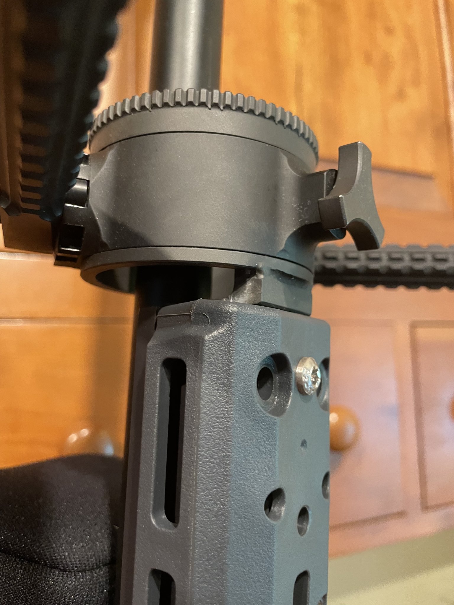

I recently bought an Elite Iron bipod off a Hide member (great transaction; as always), and it came with the Sako / TRG mount. That seemed ideal, since I am going to use it on a KRG XRay.
When I clicked it in, I found that it has 1-1.5cm of forward/back slop. After poking at it for a bit, it really seems like a design issue, rather than an Elite Iron or KRG issue.
Anyone else have similar experience or thoughts for me?

No experience with elite iron but my brothers trg bipod on his trg42 has a fair amount of slop in it. Same thing when mounted on his tikka in a krg bravo.

Update - since the aluminum Elite Iron bipod is made of ... aluminum, this was trivially easy. For anyone having a similar issue, just note the location of the spring. My hole nicked it by .1mm, which was fine, I could just bend it out of the way a little, but drilling my hole 1mm further back on the mount would have been optimal.
Screw is just an M5 I had lying around; still deciding what size/sort of knob to put on it.
