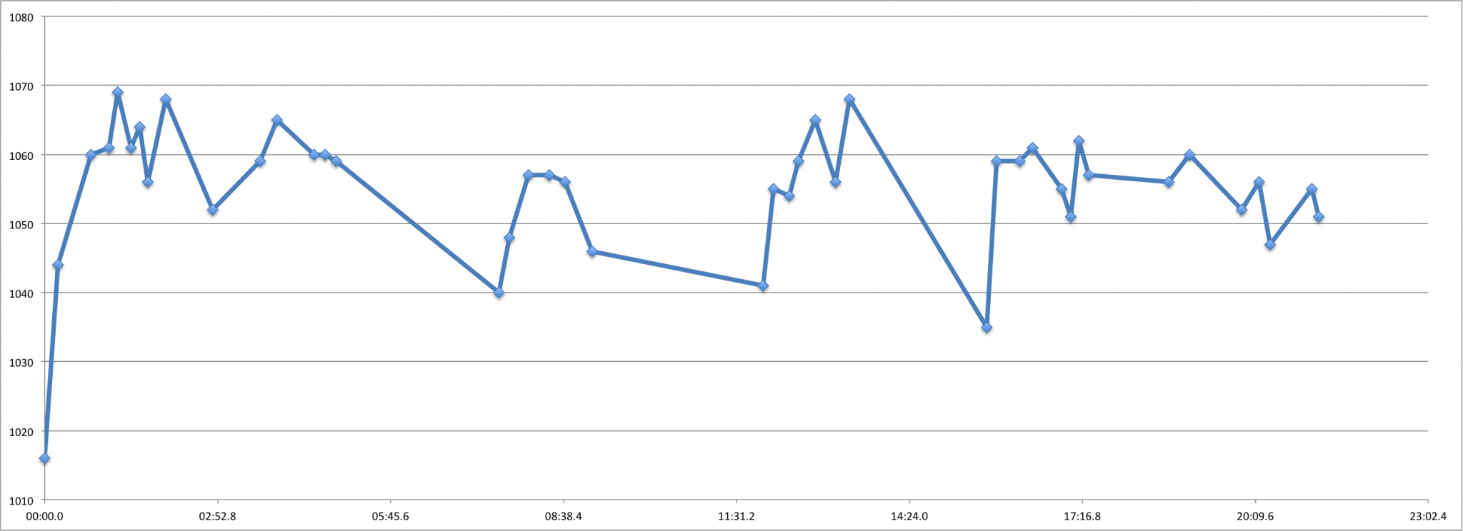

It was 65 out and cloudy yesterday and we were under cover. Got some pretty good data out of my Labradar shooting my 40X that was re-barreled with a Douglas 24 inch. Got data for 40 shots after I had re-zeroed and got some dope, so it wasn't like it was
I've always seemed to notice that the first shot of a string would shoot slow. Looking over the data, I had four times when I had over two minutes between shots. If I include those shots, my data looks like:
max1069
min1016
Mean1055
ES53
STD Dev9.61
When I take those shots out:
max1069
min1044
Mean1057
ES25
STD Dev5.86
You can really see it when you plot the velocity versus time between shots. When the time between a shot is over two minutes, the velocity is 1040 or under.
The slowest velocity was the first shot, which would have been the coldest bore because I was setting up the Labradar. That is 1016fps.
I've attached a plot of the shot vel as time went by. You can see how a pause causes a lower, maybe even how it takes a few shots to stabilize in the 1055 range.
I also did a plot where I looked the time between shots and velocity. Not counting the initial slowest shot, the three slowest shots are the three longest time between shots. And for a linear plot "Vel= (-10485)(seconds between shots) + 1059.8"of those shots, the slope is negative with an R-square value of 0.39. Not huge, put pretty interesting. (didn't label axis', a pet peeve of mine. Vel on y, x is time for the shots min:sec)
Cold bore I get. Warmish bore surprised me. It has had probably 150ish rounds through it since my last cleaning. Like I said, I've noticed this mostly in our PD matches were we shoot at 200ish on the last string and it seemed like my first shots would be low compared to later shots in the string. It really doesn't show up in shorter ranges in accuracy, only in 125yards plus.
Is this normal?

Sounds like bullet lube temp as in barrel lube temp.
That is what I am thinking as well.... the lube is in the back of my mine as surely the viscosity will change with higher temps in the barrel... but I don't know.. that stuff is slick as snot when you are loading as it seems body heat alone from your fingers will make it "slicker".
I would think it would have to be lube related. I would think that the barrel is too big to heat up itself, in bulk, and cause that change. I was just surprised that it had that big of an effect and that it takes only 120 seconds of so to show a 30-40fps difference. I wonder if it is the Lapua Center X lube in particular? I have thought about keeping the ammo in like a close chest pocket to get it warmer and at least more consistent- if that is hot enough.

Well...all I can say is this correlates with our long standing trend accross 10-15 well known rifles in our circle. The general understanding is this:
Long range results can be very sporadic in temps under ~80deg.
When our southern delightful summer arrives, if you have a stellar lot of 922A, CenterX, or Midas, the planets seem to align.
If memory serves ALL our (that our is not me but several shooters) record scores have been logged in 90+deg weather. Apache has the score cards going back to 2010. My best scores were ALWAYS shot in very hot humid weather....always.
There is a correlation between ambient temperature and higher or lower scores. I'd say those score cards would tell an incredible story.
As far as Crono numbers, I don't know of anyone in our circle that does that, we always put lead on steel. We have some impressive lead smudge pics.
It can be a lube thing, but that isn't all of it. The waxy lube of 922A definitely isn't performing until at least 80deg, but eel snot is a bit more forgiving, but not much.
As to the BiPolar....I've backed that horse a time or two. I think it's mostly a dead end street for our purposes. Yes the lube is very waxy....almost hard even, which scrambles my brain a bit for cold weather ammo.

Rimfire BR guys have noted this, and accompanying impact shifts, for years. Their solution has largely been to try to keep the time between shots to 45 seconds or so.

A few years ago, I was shooting a Rem540XR that had a few miles on it. It shoots great but it always took 5-10 rds to warm up and settle down. Also, if I paused for more than 60sec between shots I could expect the groups to expand until it warmed up again (~5 shots). If I stops for say 5 or 10 minutes due to the range going cold for tgt placement or any other reason, I had to shoot 10 more shots to warm it up and get it to group at its best. Anytime the bbl was cold or cooling, it would disperse the POI more than usual. I failed to record any data which indicates if the dispersion was more or less in the vertical vs horizontal. I thought this was normal until I purchased a 2nd Rem 540XR which was in near unfired condition. This gun had a tighter bore and would warm up and settle down much faster and was far less temperature sensitive than the older, well worn model. My recollection is that cold bore shots were usually high-right at 50y. I did not shoot either out past 200y. The old worn out 540 still recorded my best 100y groups and some of my best 200y groups. These were with both Eley and Lapua ammo.
Speed of sound is lower at colder temps. It is about 1086 fps, at freezing which means that the typical tgt ammo may be hovering close to going supersonic in very cold temps. I think the most of your biathlon ammo including the Polar Bi-match Lapua stuff is dialed back a little to insure that it is not going ballistic since that would upset the accuracy. The lubes are different too.
If you have a way to slug your bbl you might be able to mic the slugs and see if it is slightly loose? or not when compared to a rifle that is less heat sensitive? Guessing now. You said it was a Douglas 24"? Is it cut rifling or button rifled? Are you using any kind of muzzle dampener?
