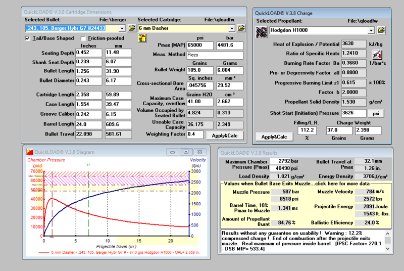

Here is H1000 in a dasher, if you don't know what you are looking at, it's not good. If you need a compressed load, buy a pound of RL 16 and try it.
