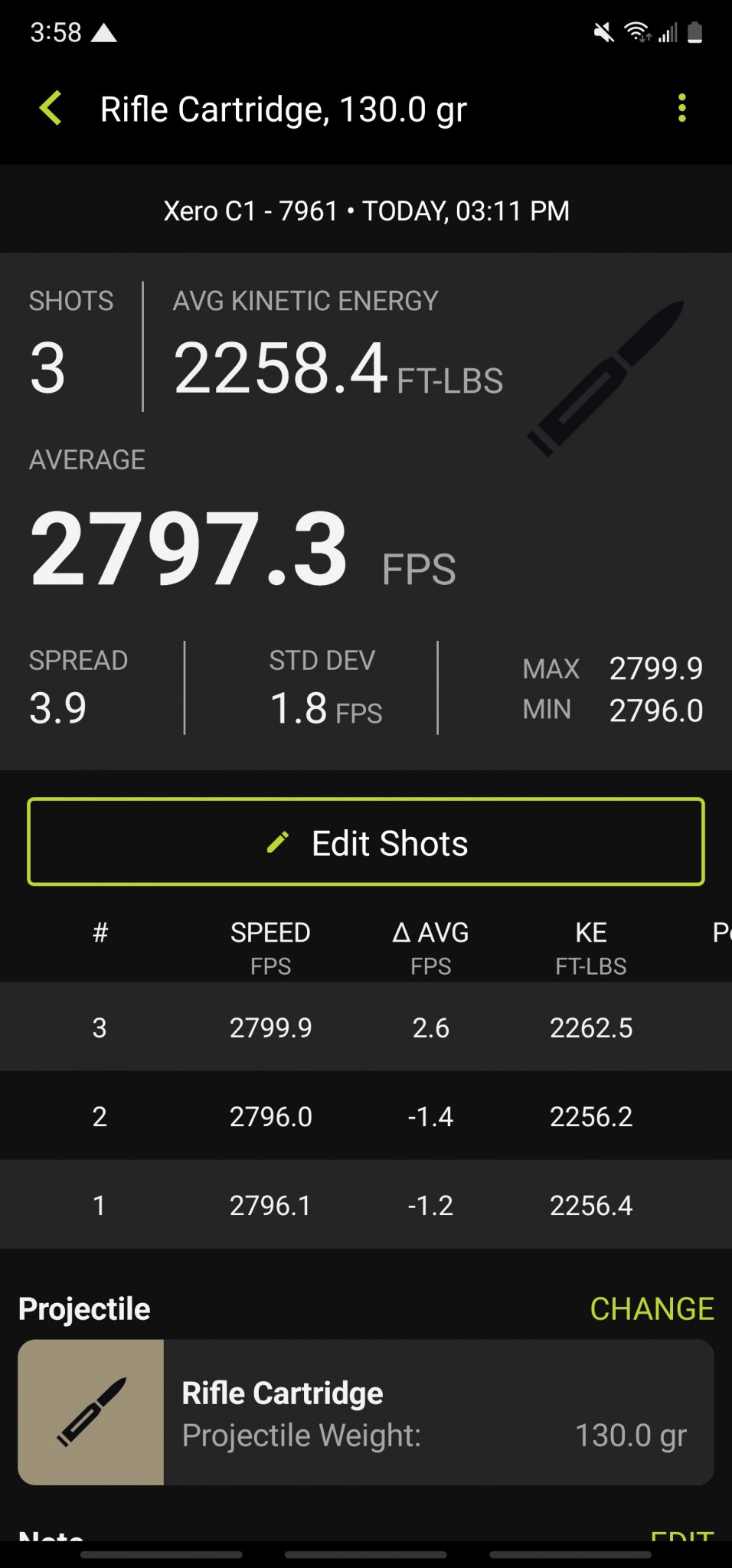

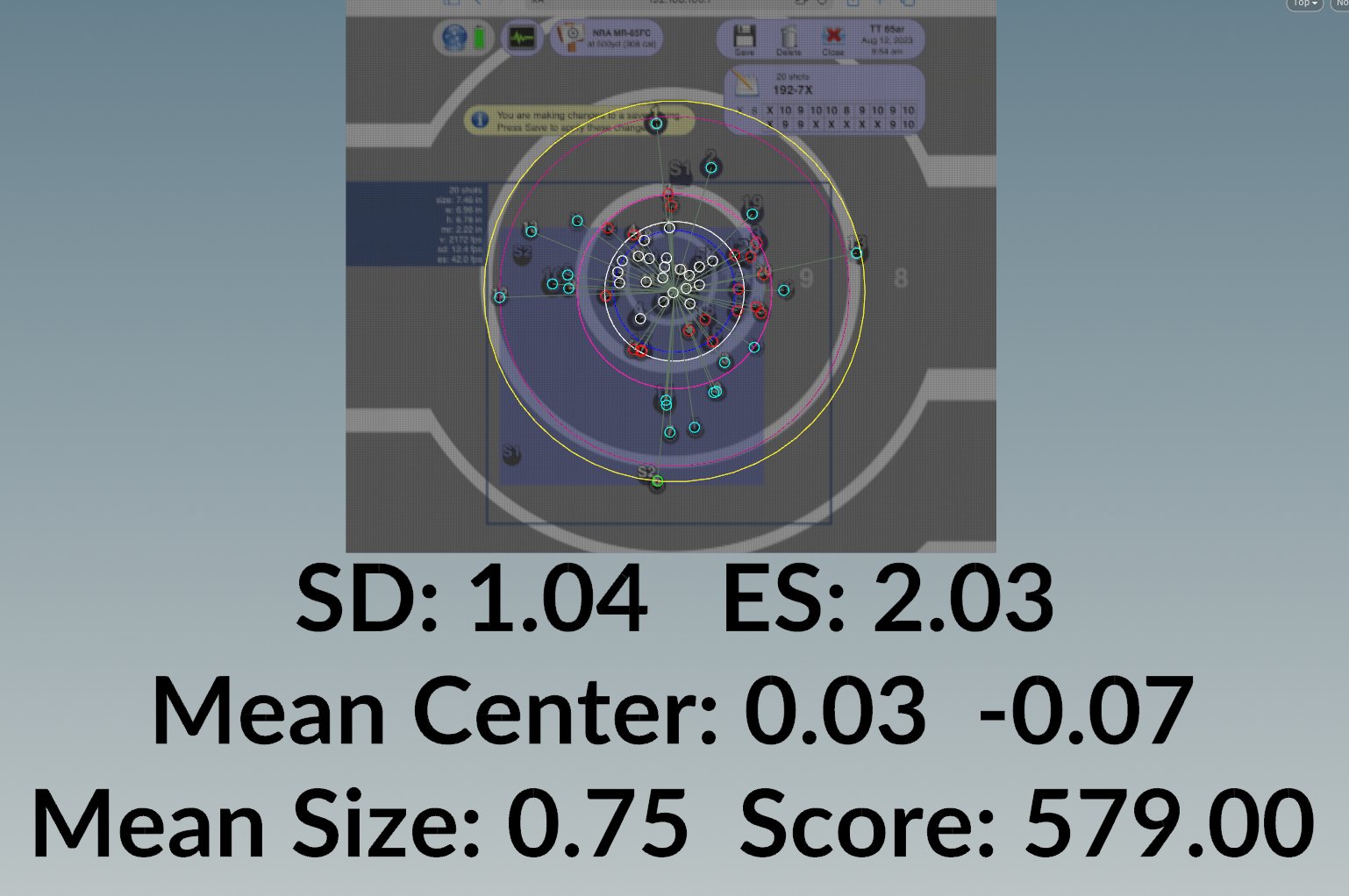

Attached pic is the Superformance load. 60 rounds for record @ 500 yards. SD and ES are groups size. For Mean Size, ordered each shot by distance from mean center and then grabbed shot 30 and doubled it for diameter. SD is basically ave distance from mean center x 2. Metrics are for me so I can compare loads.

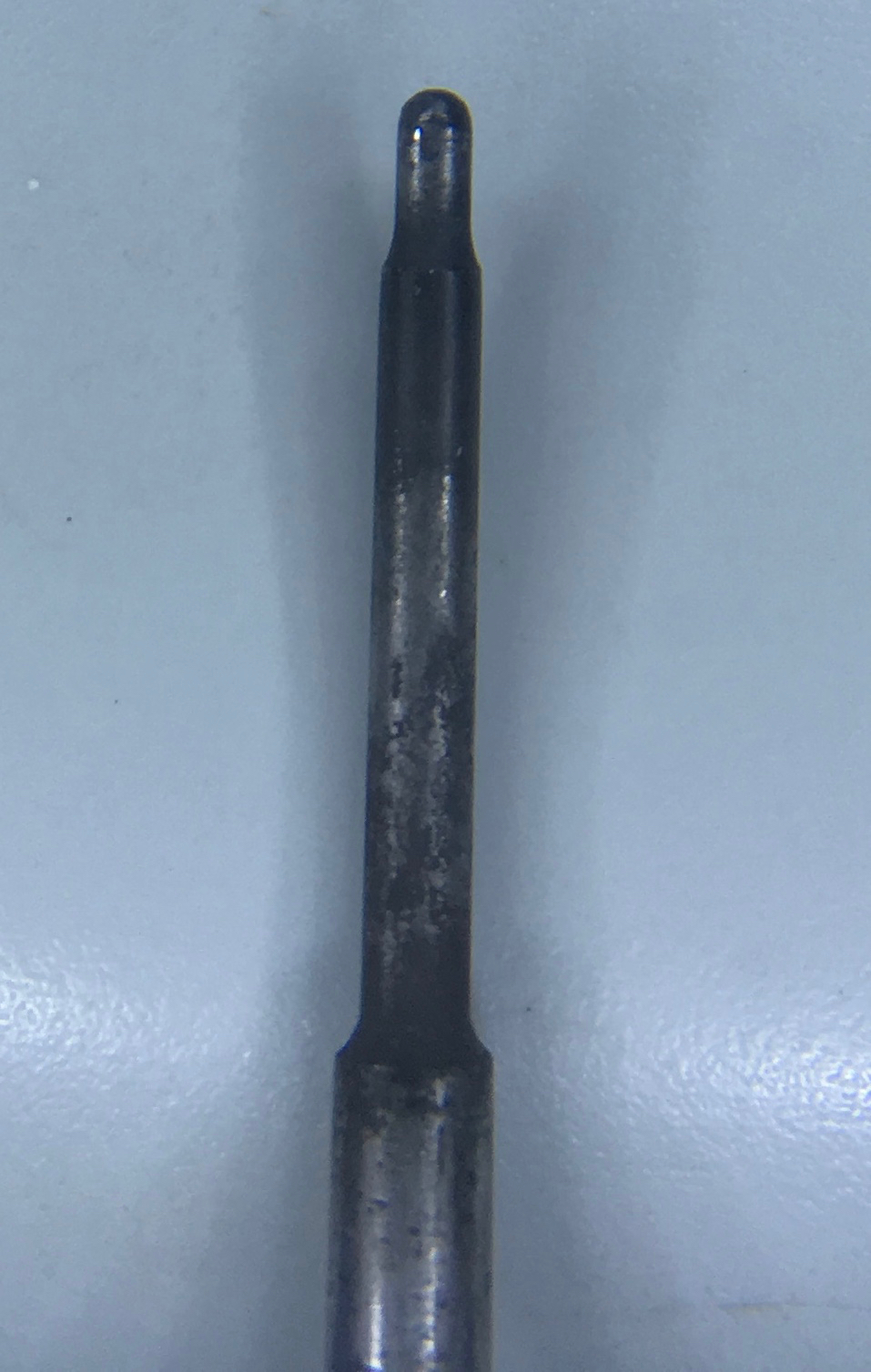

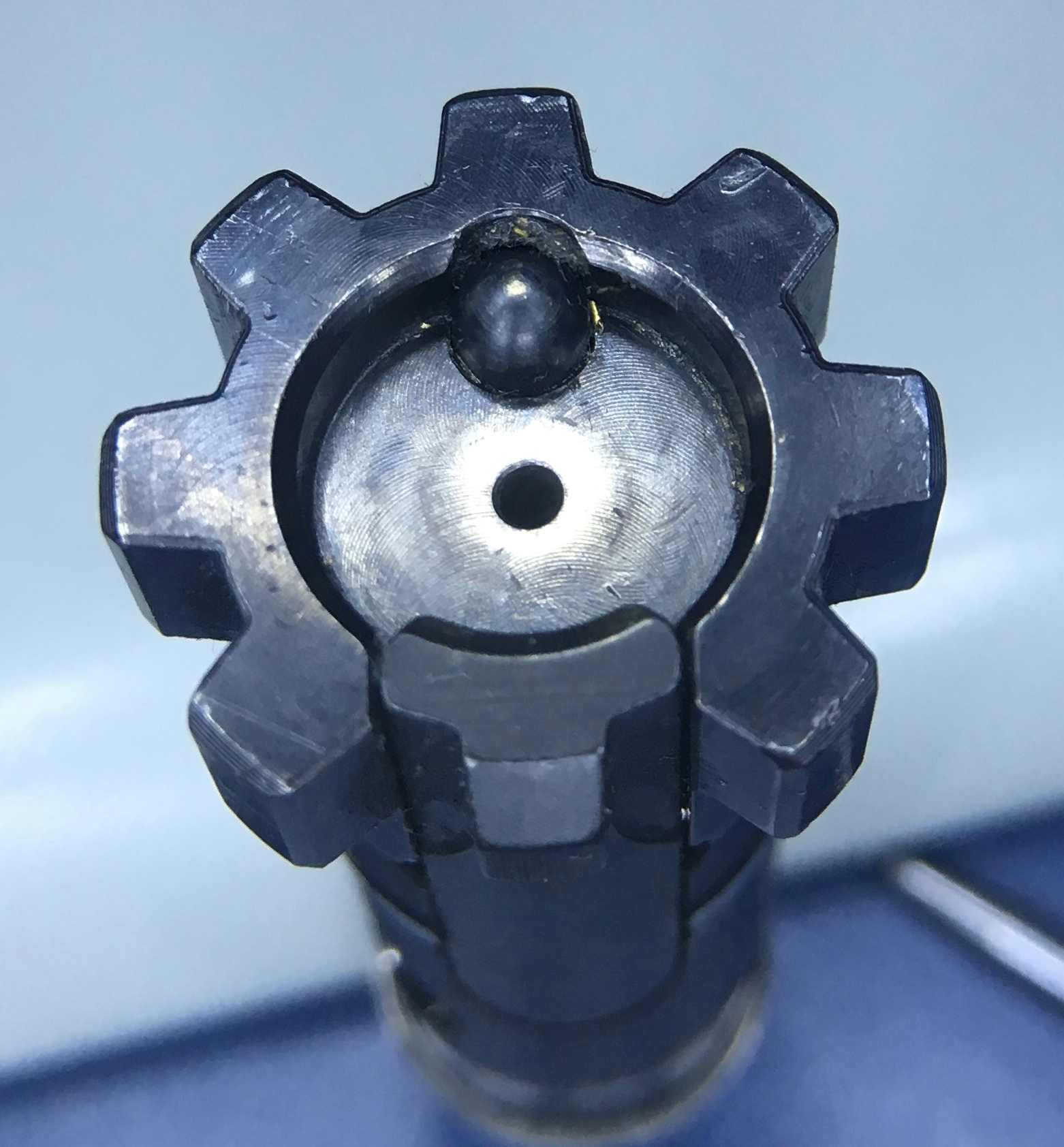

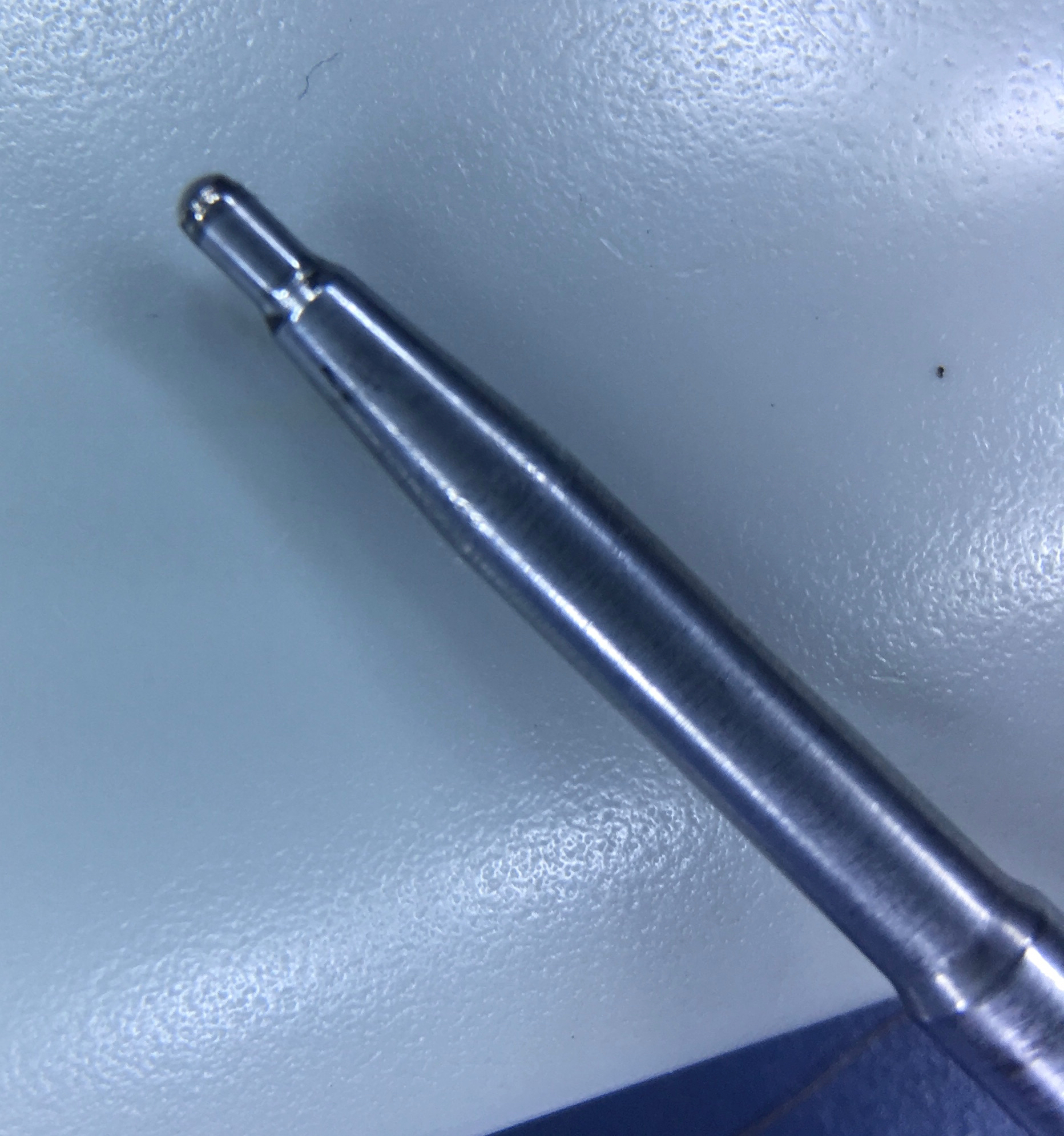

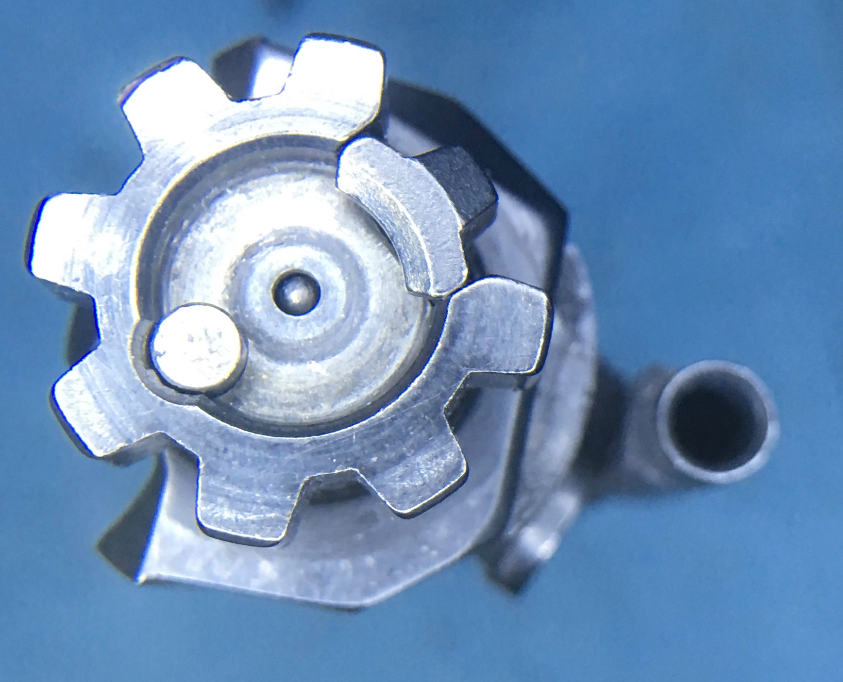

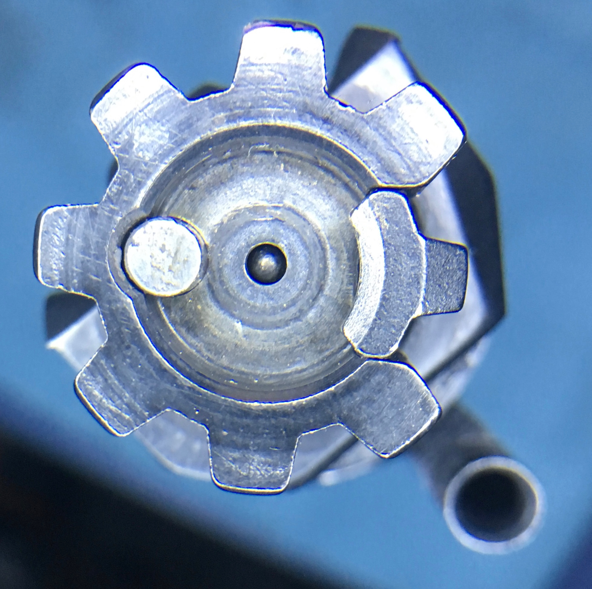

3471, 3466 and 3467 are the original PSA BCG and pin. The darker looking (lighting) is the Odin bolt and darker pin is Odin. It's the narrower type HP bolt.
I've treated the PSA bolt poorly for sure. I've had to replace the fp retaining pin a few times. There's not excessive wear on the lugs The visible dark ring is inset/embossed. No idea if it came that way. I haven't cleaned the PSA pin.
I also have PSA dual extractor BCG. Bolt face looks smooth and flat. Lugs are the most worn of the three. Worn on just one side.
But the pin is toast! Tip's broken off. Glad you made me inspect.

I'm seeing ~2600 on my 140gn projectiles with StaBall match and H4350
2700+ with StaBall 6.5
2500 with Varget.
Factory ELDm 2600
Factory ELDx 2640.
Factory Berger 130's were 2800
Factory Berger 144's were 2700.
