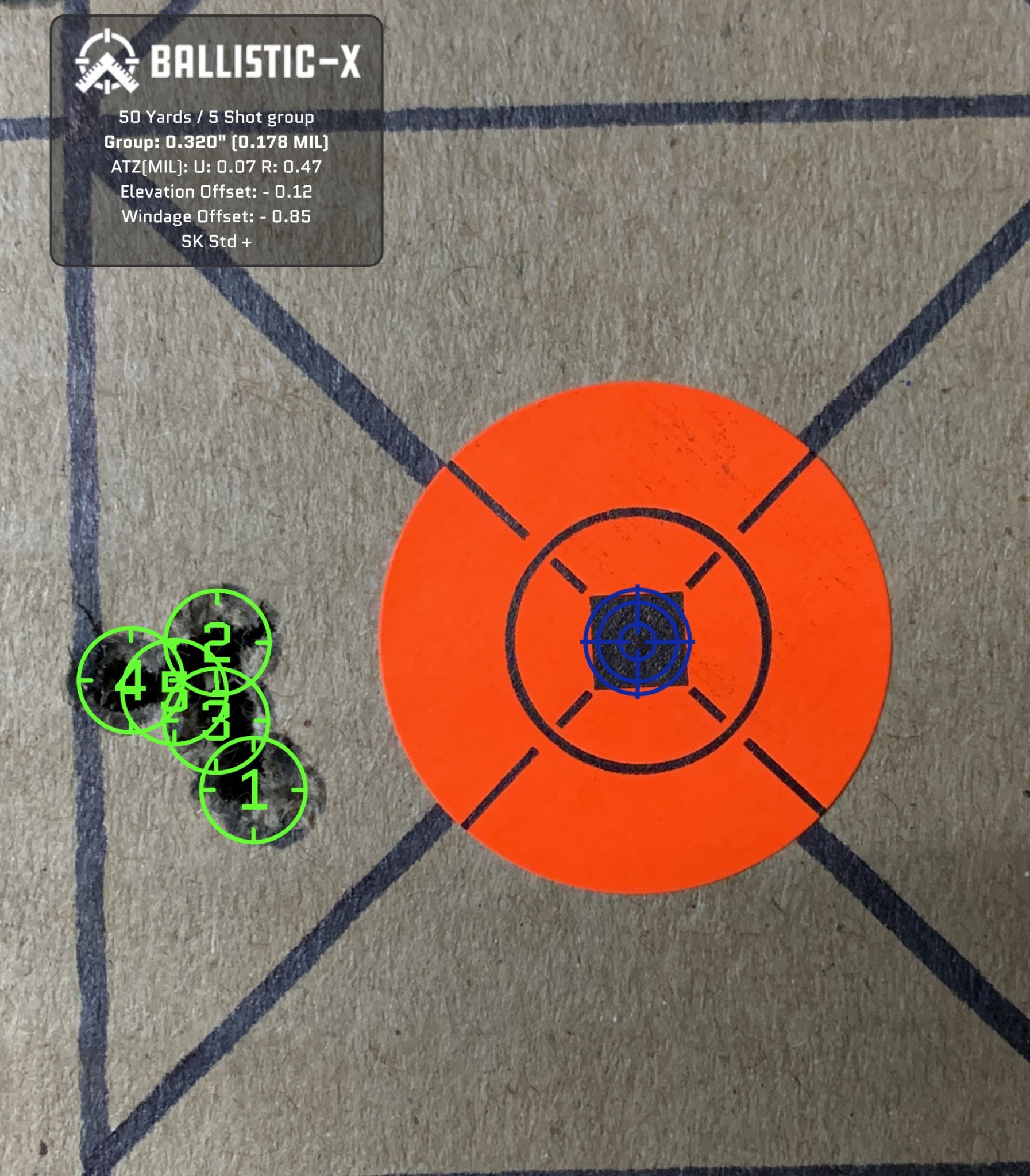

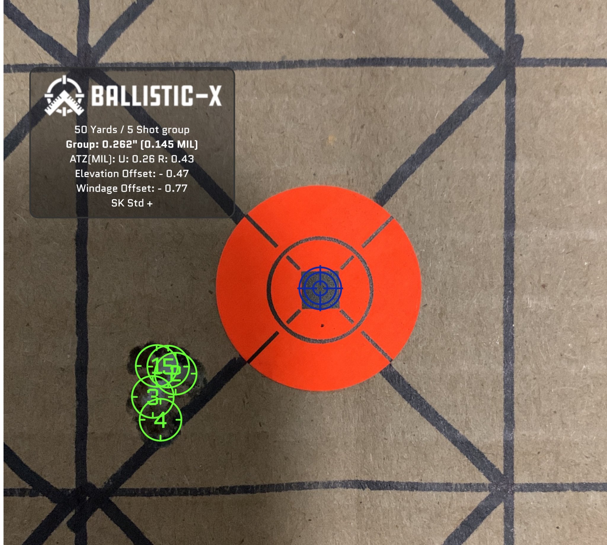

    I tested out my tried and true SK Std+ through a new barrel and it shot pretty solid but when I choreographed it was a lot slower then I expected. I was getting an average of 1066 out of my 20” 16tw GM barrel but only 1025 from the PBB 23” 12tw, now I don’t know if the weather being roughly 32*F would cause the lack of speed or the length/twist rate but just seemed odd.
    View attachment 8084804View attachment 8084805
