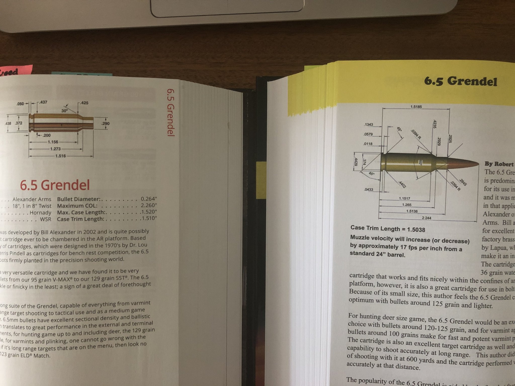

    For reference, here are the red and yellow book pages - they have slightly different case dimensions, but should give you something else to work off of for measurements.
