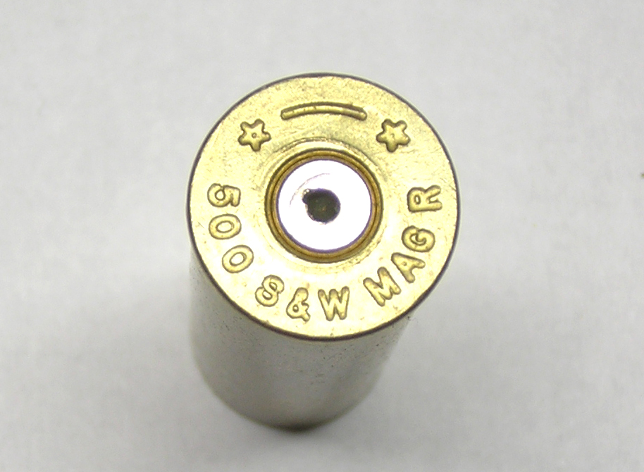

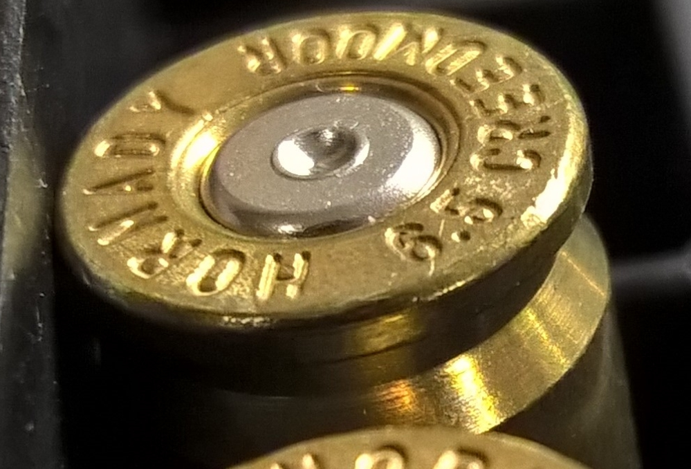

It's more about primer cratering/blown than primer size usage.
This is an example of such:
As you can see the raised ring around the primer strike.
Pushed further it'll look like this:
Fitment of the firing pin plays a part in this as well.
