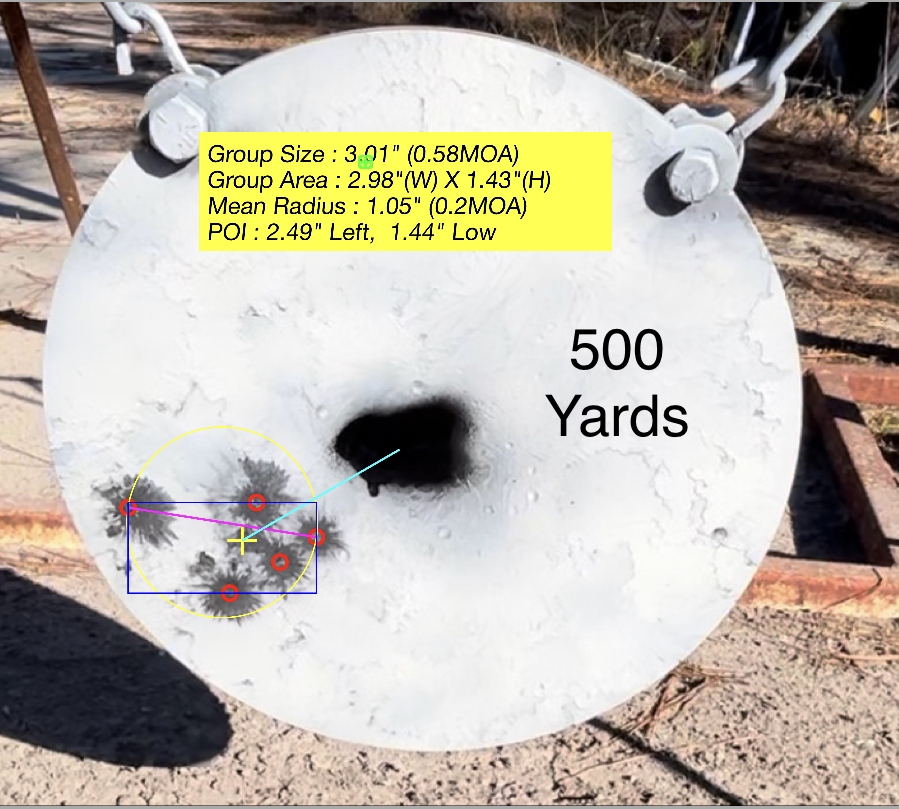

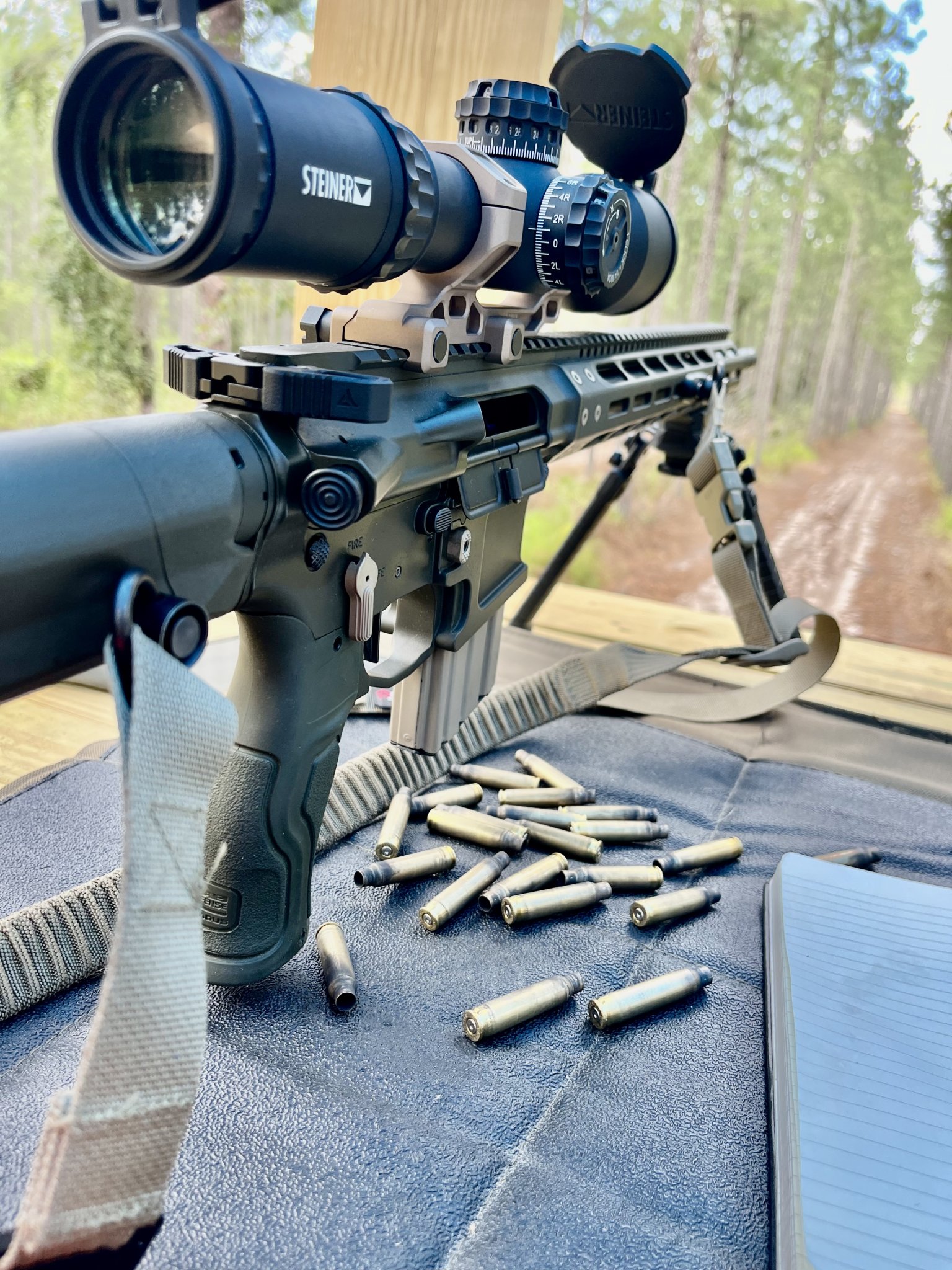

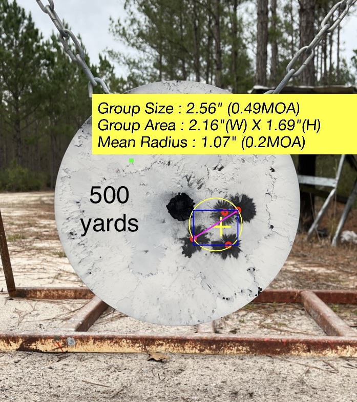

And that is just one of the many reasons why I chose the Seekins Precision SP3R V3 (with iRMT-3 Upper) for this build and I even took it 4 steps further for increasing rigidity, fitment and barrel harmonics.

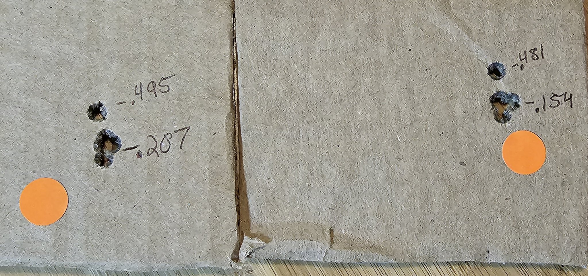

These were the first two 5rd groups shot while conducting barrel break-in, in-between shots as while making gas block and muzzle break adjustments using Blackhills 77.
View attachment 8204137View attachment 8204136View attachment 8204135

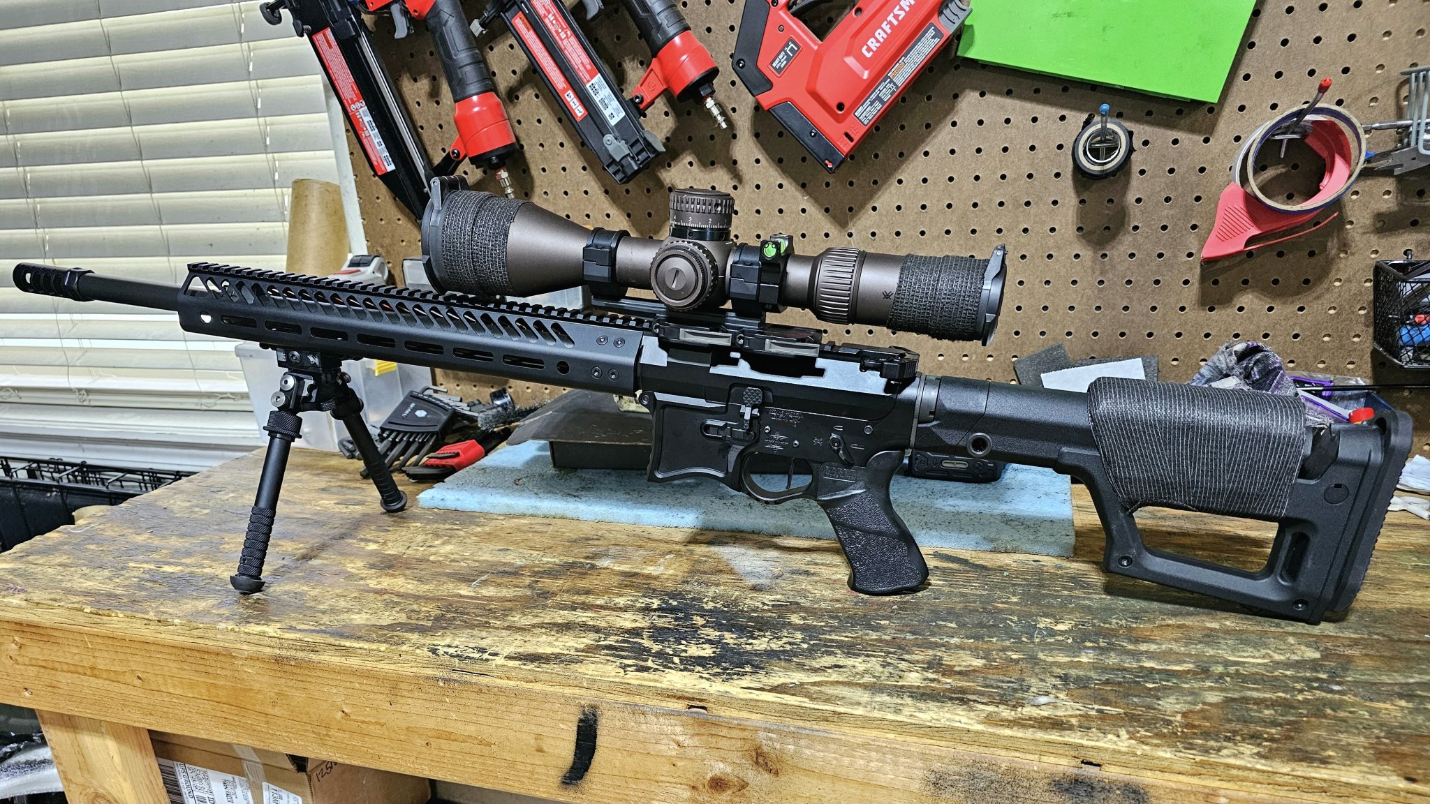

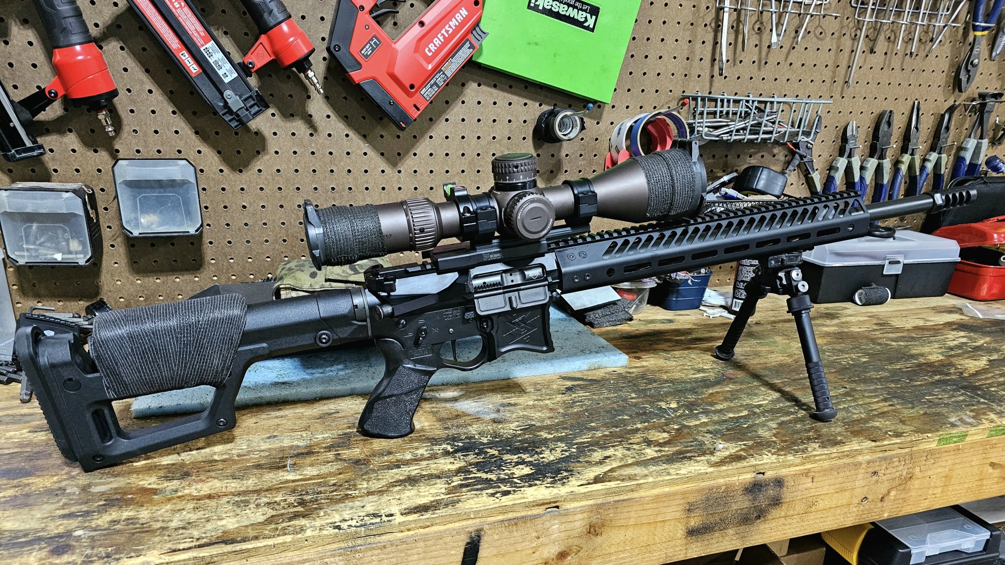

I own Aero enhanced uppers/handguards and Mega’s MML. There is no comparison of the upper or rails rigidity between the two. That’s is not a knock on Aero, they have made accurate builds for me and have a place, but the Upper is much thicker on Mega and the hand guard is 7075 on the mega, almost twice as thick in material, and the fitment of the hand guard to the upper is something to personally see and use to understand how tight it is. Without attachment screws the aero will wobble when slid on requiring the screws to stabilize it, with the Mega when you slip it on you have to practically ask it nicely to let go to take it back off. The aero enhanced sets are better than most normal handguard to barrel nut systems, but no comparison of the Mega’s that has built the most consistent accurate rifle I have thus far shooting bench or prone that I believe is helped by the design.
Nice! The matching lines make that look like a really clean build.
The Aero comparison is what made me question the Mega design a bit. I've done a couple Aero builds as more of a general purpose rifle and their tolerances seem to run pretty loose. One upper/barrel took a .003" shim just to take up the slop (not even to get interference fit). Same with an Atlas handguard.
Like you said, nothing against them for what they are. I just wanted something tighter as a base for a precision build since it seems like inaccuracies stack in this game.
