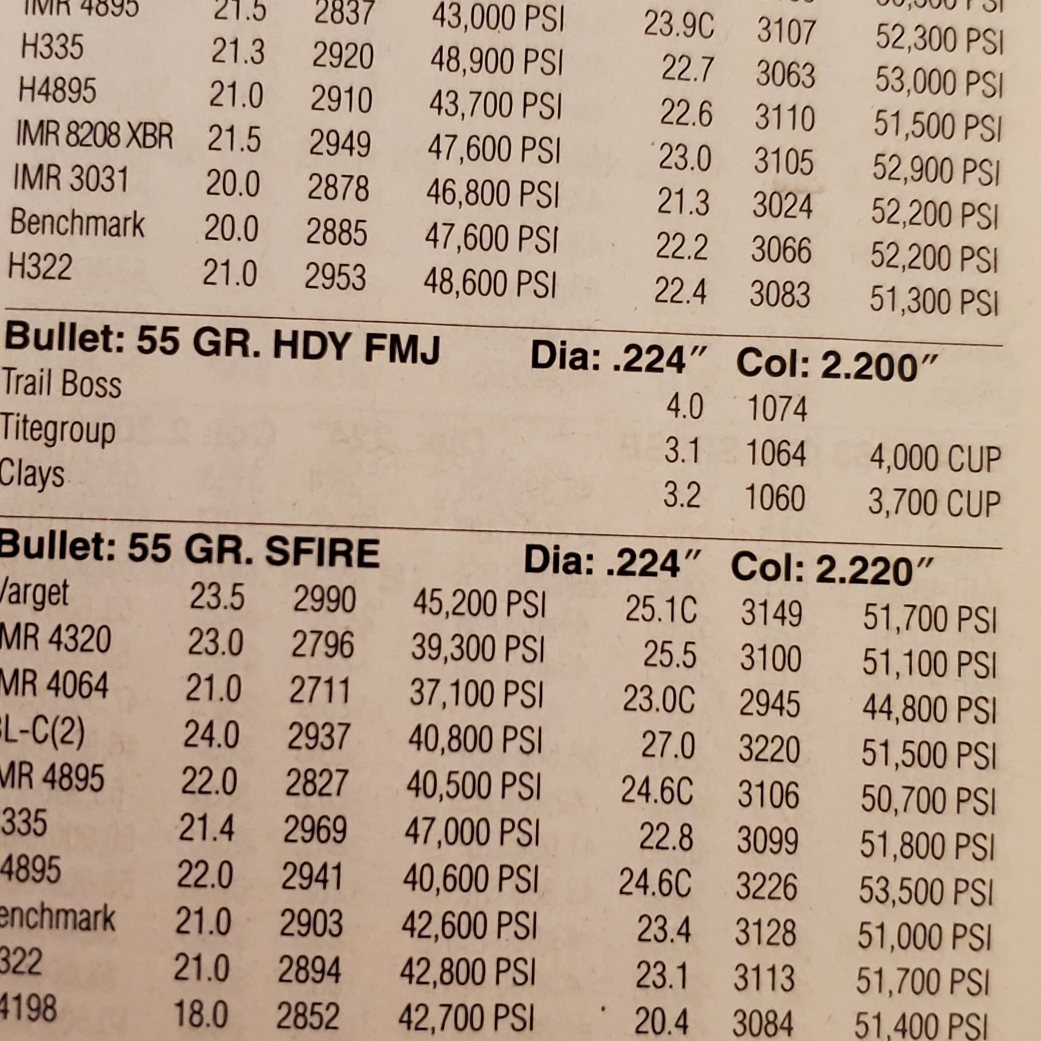

I have a friend who wants me to load up reduced charge 223 so it will be quiet. So I loaded some CFE223 at 17gr and 14gr and some Titegroup at 3.6gr. I did not run the chrono for the two CFE223 loads and the Titegroup load was 1030FPS with a 62gr bullet. He reports that none of these loads are quiet and I have yet to get the make of suppressor from him.
My reason for this post is somewhere I think I remember that too little powder can cause problems. He now wants to try 11 gr CFE223 and I think I am not going to oblige him on that depending on what I hear here.

Ya if the brass doesn't seal to the chamber it can cause problems, bullet might not come out etc. (possible explosion)
Your buddy is an idiot, 1030 fps is subsonic and should be super quiet especially if he's running a can.

I would be very careful making subs for someone else; I personally would not do it unless it was a tested and know load I had tried in my own guns. If you can find it, Trail Boss is the powder you want that will not get you in trouble; I hear Red Dot works as well, but I haven’t used it.
Lots and lots of details in making effective and functioning quiet cartridges. 556 is a tough one b/c not enough mass in the bullets to be effective at subsonic speeds, or bullets that have terminal performance at subsonic speed. Then there's muzzle blast (even with a can) which may be controlled with unconventional powder selections. Semi autos always have lots of machine/action noise. And then the functioning of the action (buffer, springs, carrier, gas port size/adjustable) is tough to ballance with noise. This is tough even with cartridges designed for quite operation.

That's what I don't get about his claim. I have tried to get the suppressor manufacturers out of him and he keeps forgetting to find that out. I am leaning towards terribly naive not idiot though that may be subject to revisiting.
Wait, your buddy thought a subsonic round would be silenced firearm quiet? And now he wants you to build him a firearm silencer? What country are you in?
OK where did you get that he wants me to build a silencer out of what I said? I guess you are bored today and looking for someone to aggravate?
So he’s shooting an unknown suppressor with ammo he instructs you to make using a powder charge that by most accounts could create safety issues and now he’s wanting you to go with less powder for the next batch? If it were my friend I’d tell him to pound sand, just my two cents.
Pretty much what I did a few minutes ago. He does not know what he does not know so I have no problem with what he asked me to do. Along the way I learn more and can pass it on to him. He has agreed this is a bad idea.
I used titegroup because I had it and Hornady has load recommendations using it for 223 and 308 subsonic rounds. I did try them out in my gun first.
Just need to use the right powder. Fast burning and fluffy are what you need. A lighter bullet can make less noise bc less powder. Going for 900ish fps cuts noise as well.
223 is not a good candidate for this, but a fluffy fast powder can make it workable. Red dot, tin star, trail boss, unique, titegroup, some of the dots, and other similar ones will do best.
Consider using cast bullets, or coated cast to keep crap out of the suppressor. Much less chance of sticking one in bore even at 600ish fps. Jacketed gets funny and can randomly stick at much higher speed and less predictably than cast lead. Cast lead is easier to remove if you do stick one too.
Rifle will be single shot, no action cycling no matter what unless you get into something custom and oddball.

Do not use rifle powder...detonation phenomenon can occur.
This is Hodgdon load data for the 5.56 with 55 gr fmj.
Quick load does not accept this load...notice the pressure is only 4000 CUP.
Sometimes the bullets stick in the barrel when pressure is too low...something to look for.
AA1680 is the best bet to get the auto loading action to function with subs, its very gaseous.
Try 8 grs of AA1680 with the 62 gr bullet.
Minimum is 3.0 gr before the bullet sticks in the barrel...at around 500 fps. But it's only a prediction and I wouldn't go there, without checking the barrel with each shot it's only 4200 psi.
And around 21 gr of AA1680 is max pressure load for the 5.56.

You are at least 7 grains below starting load with 17 grains of CFE 223 , that is not a powder for this project . Maybe try H4895 and the 60% formula ?
