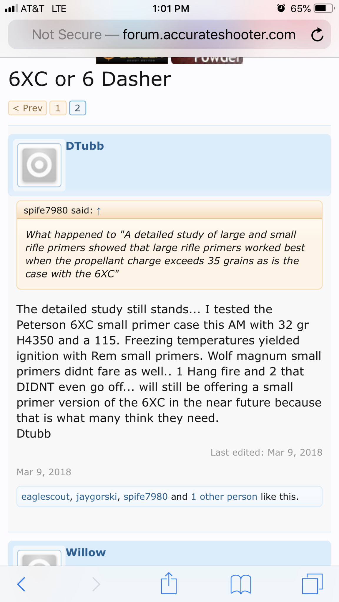

Now, I’m not throwing this out of my butt… 10 years ago I blew 300 rounds trying to develop a load for my 6x47L in January and got hang fires and velocity spreads that were all over the map. Eventually I started forming cases from 6XC brass to get the large primer and everything settled down to single digit ES… and all was well ever since.
The claim is small rifle primer pockets hold up better than large at the higher pressures...ie longer brass life.

I also discussed this problem at that time with David Tubbs throughout the development period and he discussed it with Boots Obermyer and between them agreed that trying to light 38 plus grains of powder with a small primer was a bad idea... yet the practice persists.

The moral of the story is that it was problematic at best no matter what I did with small primers, but it was wonderful once I started forming brass from large primer 6XC brass, but I also used 22-250 cases or 243 cases... and they all worked very well... except for the small primer lapuas.

DT speaks on the subject in the included pic. He further explains in other post and articles that the SRP is only for longer brass life in high pressure applications. Where you are pushing the ragged edge of safe pressures. Ignition issue using SRP in extreme temperatures is why he still advocates the LRP.

My own conclusions are consistent with what Tubbs concluded as stated in the previous post.

I once asked G. David Tubb what the difference was, since he was, well, G. David Tubb, and he had also gone deeply into the small primer rabbit hole. (PS that was around 2000) When I think in terms of scientific method and load development, his is the name that pops into my mind immediately.
He said that initially, he was getting better results; but that once he considered the first sentence above, he worked on large primer loads, and found that the primer size simply demanded a slightly different charge to achieve exactly the same thing, and he went back to doing his load development with the large primers.
