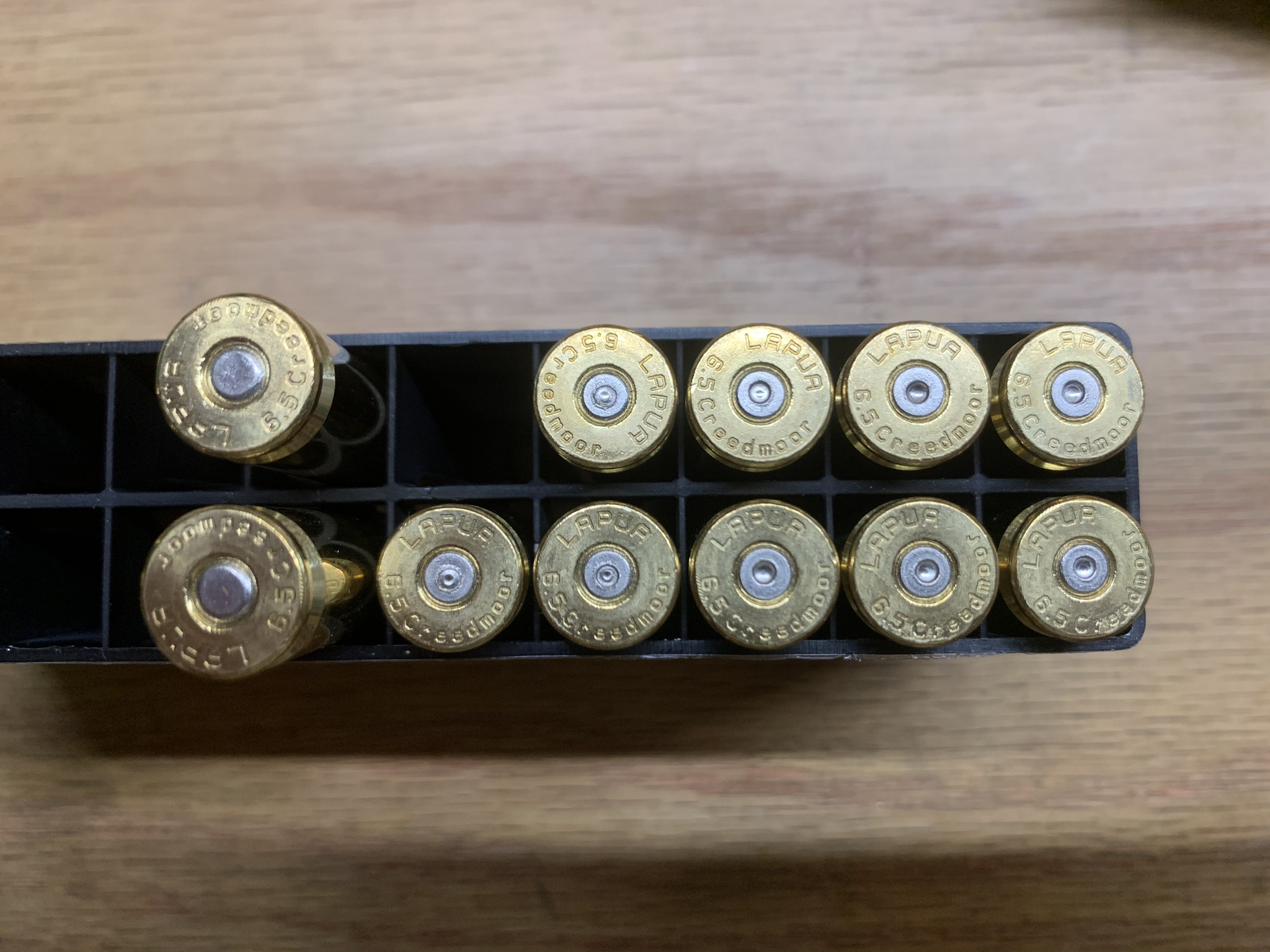

    I had pressure problems like crazy running factory Lapua ammo. Problems bad enough to never want to run small rifle primer ammo anymore, unless I get the pin hole bushed. Otherwise, there is no way i will use SRP anytime through my rifle. My rifle is a howa 1500 in 6.5CM.
    My bergara hated SRP. Bergara didn't think it was an issue since 6.5creed is suppose to be LRP, according to them. Needless to say but I dropped that platform and will never buy another Bergara product.

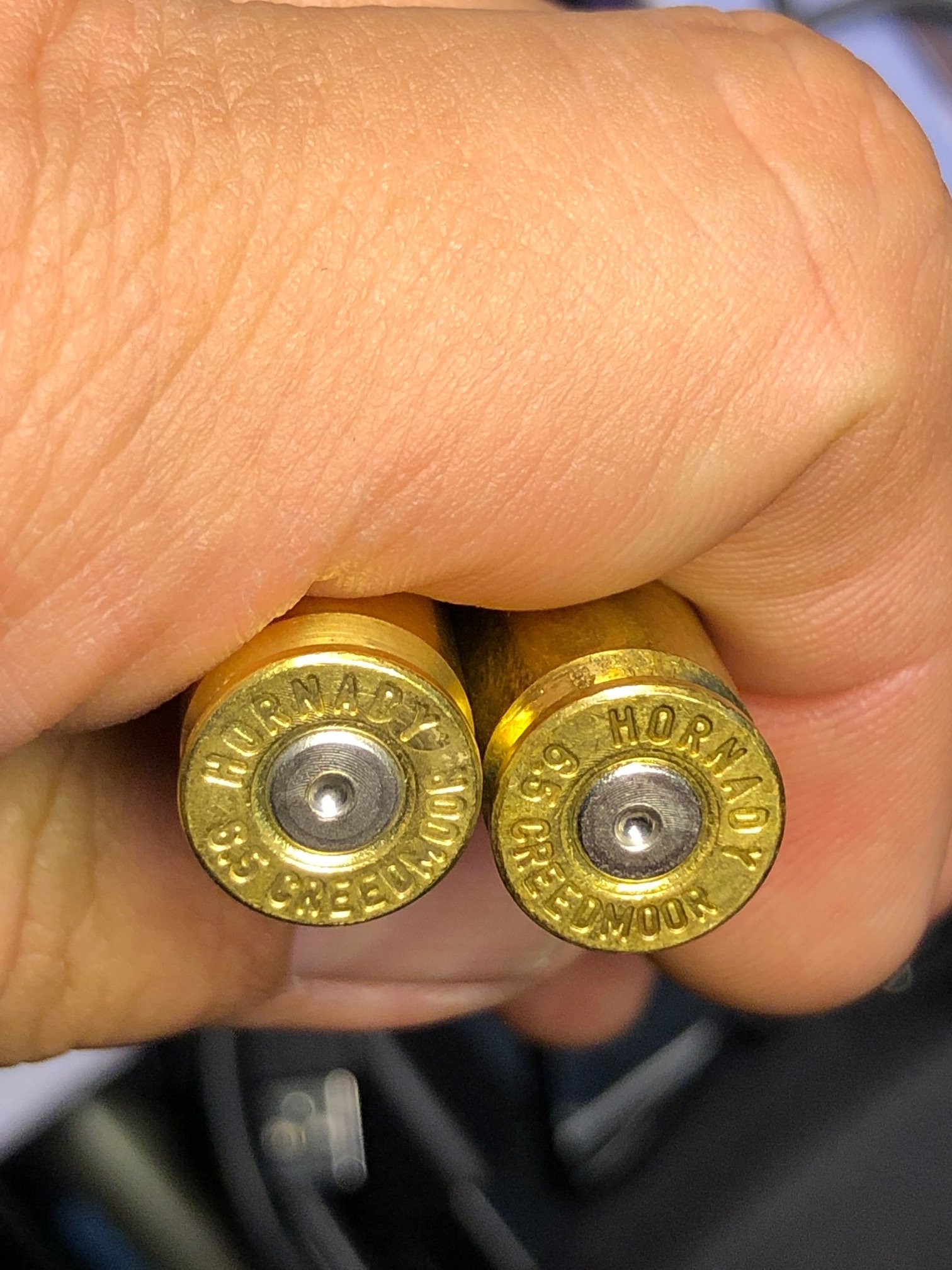

    I have an older Bergara with a premier action, which has a larger firing pin. Newer actions are supposed to have a smaller pin.

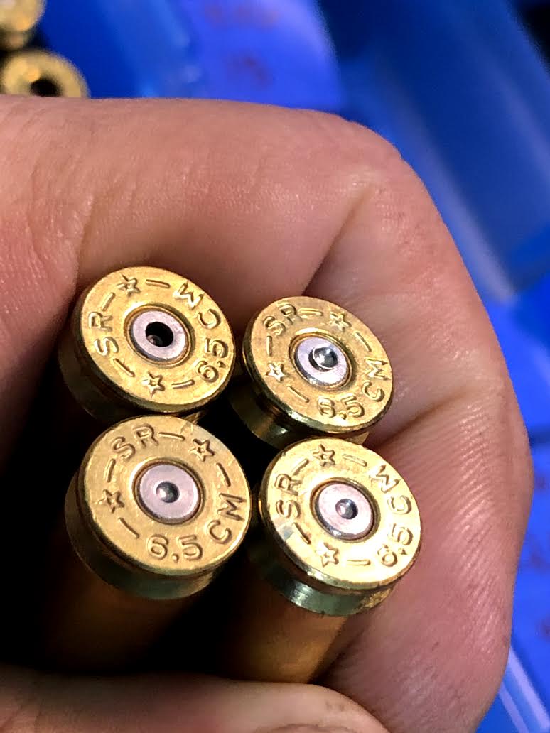

    I do see cratering in small rifle primer brass as I get higher into the pressure range. With new brass where the case is expanding quite a bit to fill the chamber you can see that it’s starting to extrude a “plug” into the firing pin hole. Thankfully I’ve not had one actually punch the plug out.
    I’ve also had problems using milder primers. I have a pretty good stash of older Wolf SRM primers, which was my motivation for getting small primer brass. They have a great reputation for consistency, and that’s borne out for me in .223 loads. However they do not reliably ignite the powder in my 6.5 Creedmoor loads. I had issues with multiple duds, and consistent hang fires. I switched to CCI 450’s and have not seen any issues since. Could be specific to that lot-era-brand of primers, but it’s something to be aware of before you buy 🤣 a ton of a specific brand of primers.
    I’m guessing the pressure problems with small rifle primers in Lapua brass are due to the small rifle primer flash holes and that’s why Starline makes their SRP 6.5 brass with a large primer flash hole for better flame propagation. I know, its not the same quality as Lapua brass, but it would be interesting to see how the different flash holes performed differently pressure wise with all else the same.
    For guys that report trouble with small, what are you seeing? Over pressure with low velocity, pierced primers, failure to ignite...?
    I’m curious.
    Really bad over pressure signs. Sticky bolt, cratered primers, even primers falling out when I ejected the spent case, and really shitty accuracy.
    No, I am not saying the ammo was not good. The ammo was factory Berger so it doesn't get any better. I just simply can't use SRP in my rifle unless I bush the pinhole.
    I am not getting any pressure signs, other than cratered primers. I get around 3 out of 10 pierced primers.
    Accuracy is great, for the virgin brass, get hits out to 850 yards and 14 SD for 20 round string.
    Do yours look like these?

    First two are SRP Lapua brass loaded with 41.4 grain of RL16 under 140 ELDM's and Rem. 7 1/2 primers. Last pic is Hornady brass loaded with 42.7 grain of RL16 under 140 ELDM's and 210M primers.
    I have worked up a load with hornady brass and went up to 43.4 and was getting cratered primers, none pierced, I did not load but 20 or so at the 43.4.

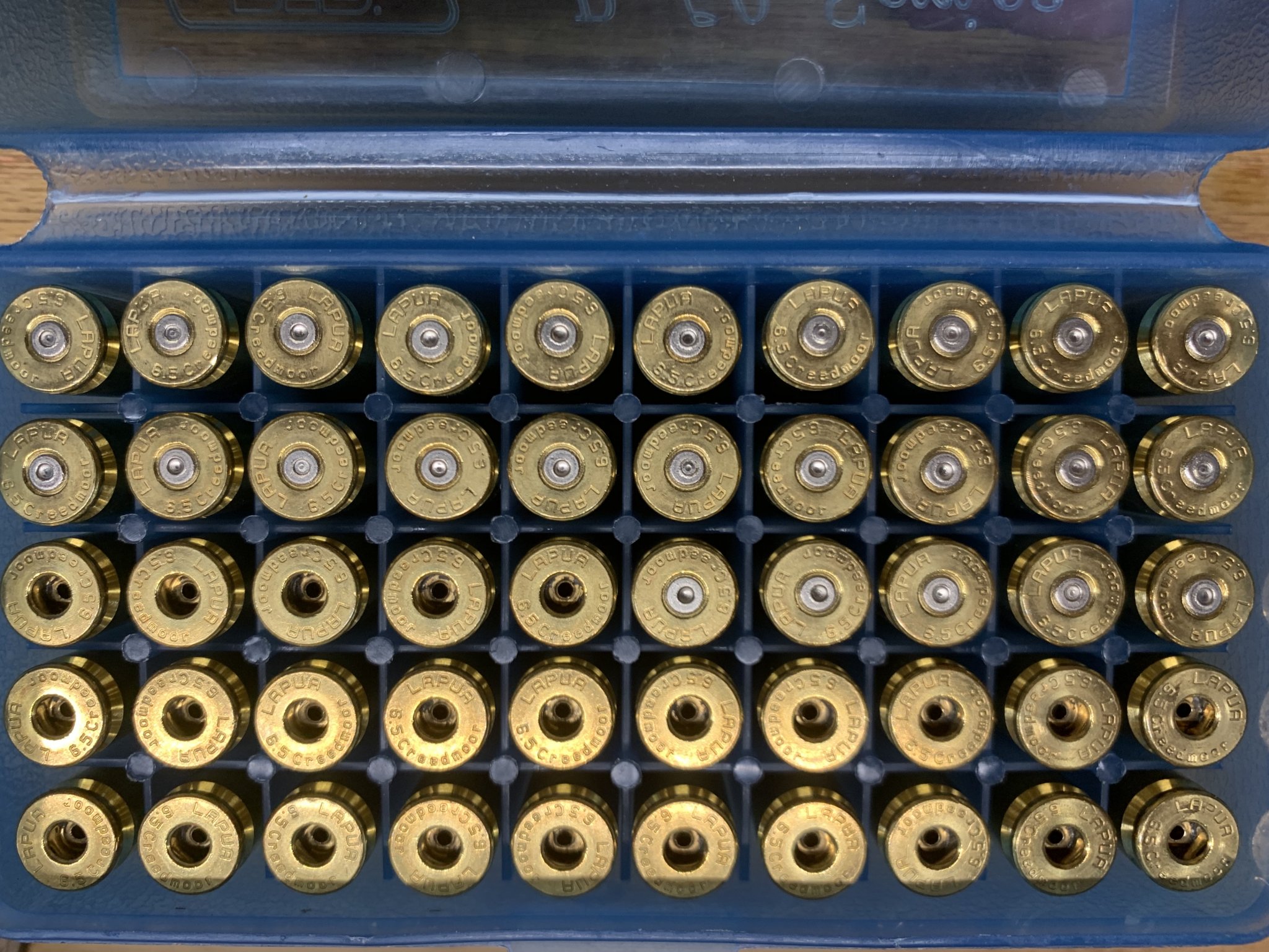

    So my experience with LRP VS SRP I have a RPR 6.5 and when I shot LRP Hornady Brass and pushed a warm load the primer would crater and the same load on SRP the primer would crater and some times puncture. Velocity was the same and the bolt wasn't any harder to lift. Just simply there wasn't enough material to give around the larger firing pin found in the RPR. Sent the bolt to get bushed and the firing pin machined down and now I have no issue with either primer and in fact the primers don't crater at all. The cratering is all about how loose the firing pin is to the bolt. The benefit I see to SRP is that my Hornady brass LRP pockets will loosen up after 3ish firings on warmer loads. But my SRP cases of Starline and Lapua hold up to more abuse. Personally I don't like cratering it happens without the rest of the primer flattening so it's not overpressure.
    LPR with stock RPR large firing pin
    Pre bushed firing pin on top and post bushed and machined firing pin on bottom
