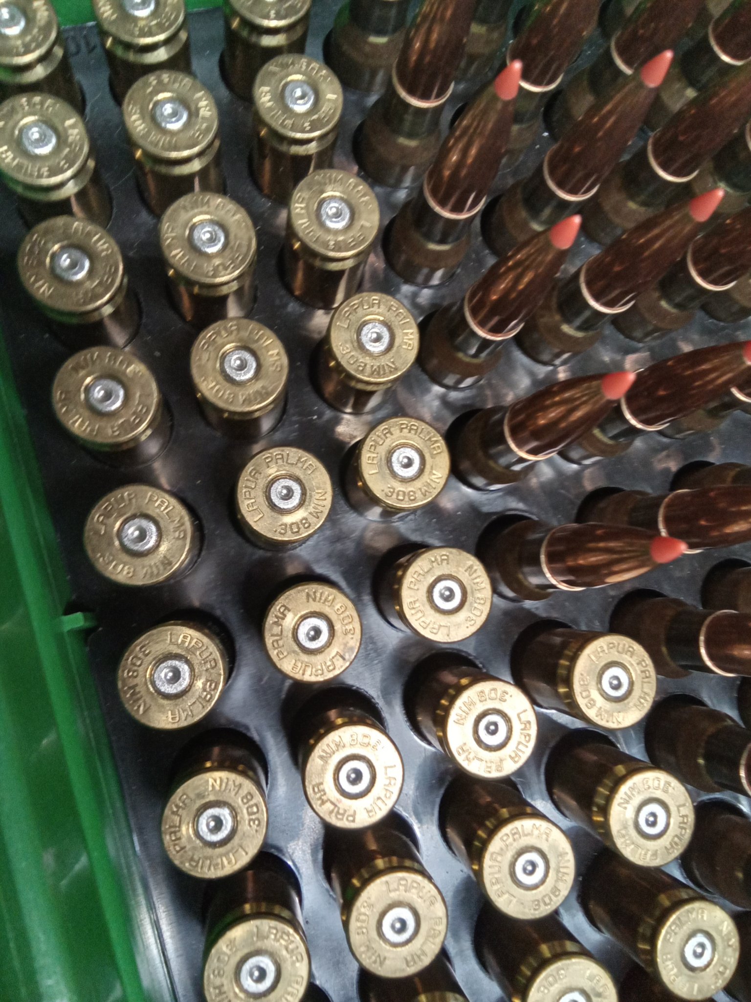

    With the cci450 run at top end charges with AR-COMP in an unbushed Rem 700 Varmint I would see only the slightest amount of cratering in Lapua brass.
    I will dig one out a try and get a good pic.
    40.7 grains of AR-COMP with 178amax @ 2.885 coal

    My favorite load for the .308 RPR with 26" Krieger barrel is 41.1 grs AR-Comp for 169 SMK's in Lapua Palma cases using CCI-400's (COAL: 2.957). Recently got hold of some Rem 7.5's and with the same load, they did great, to my surprise. Also, ran test with that load in some Alpha brass and Peterson brass (both with large flash hole) using CCI-450's and they also did really well.
    When I first tested some new Alpha brass for the first time using CCI-400's, 3 out of 10 primers were pierced. Most likely, the larger heavier firing pin of mine contributes to that. But, never had that problem with either Lapua or Peterson SRP cases.
